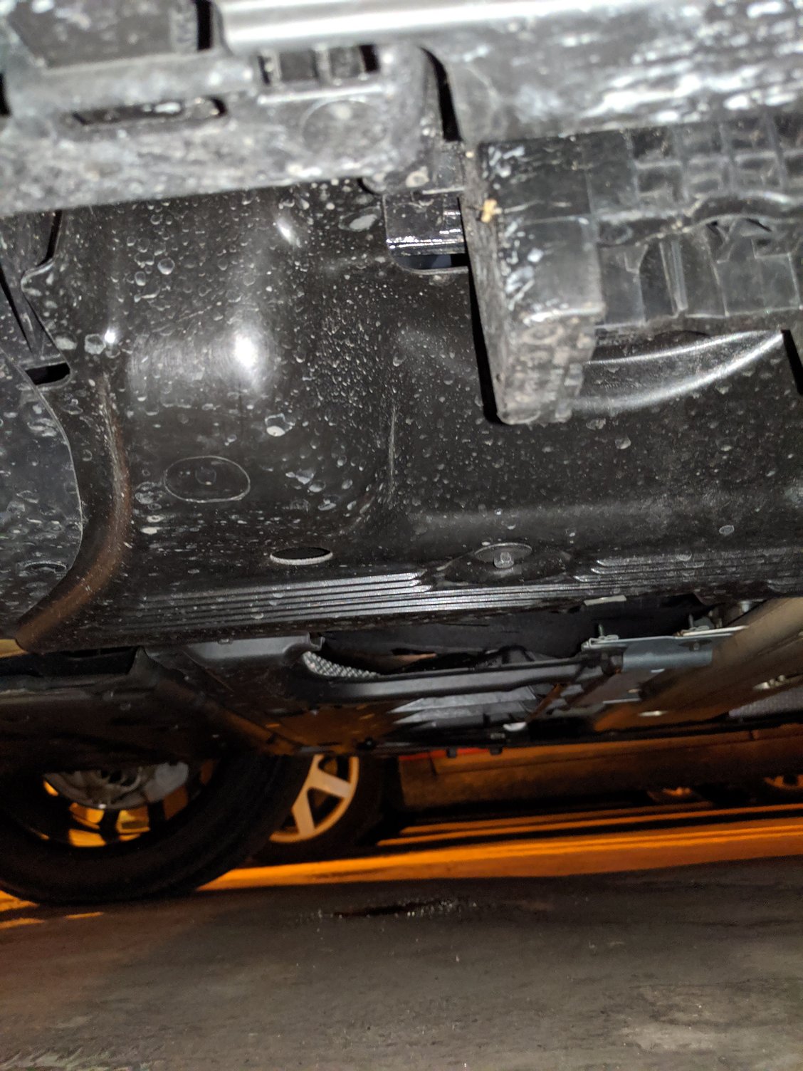

I’ll photograph the drain holes today 👍 they are where I described them to be. Two of them, circular, and both drip water when I’ve got the A/C running.

Here are the holes where the A/C drains from. Hope this helps.

Thanks for the very precise explanation and picture. This gives me something to discuss with the dealer. I found several possibilities but without a drip I couldn’t be sure which holes were the drain.

My GLE450 doesn't seem to have A/C drain holes? Did Mercedes forget to install the plastic cover on my car? Looking at Wiggis's photo it seems like there is a plastic cover with drain holes in them, but on my car it seems to be missing, does anyone know if this is normal?
Wow... ! You definitely appear to be missing some pretty significant underbody plastics... unless the build in Vancouver is very different than in the UK.
I would go to your local dealer and check out the showroom model as a comparison as a starting point.

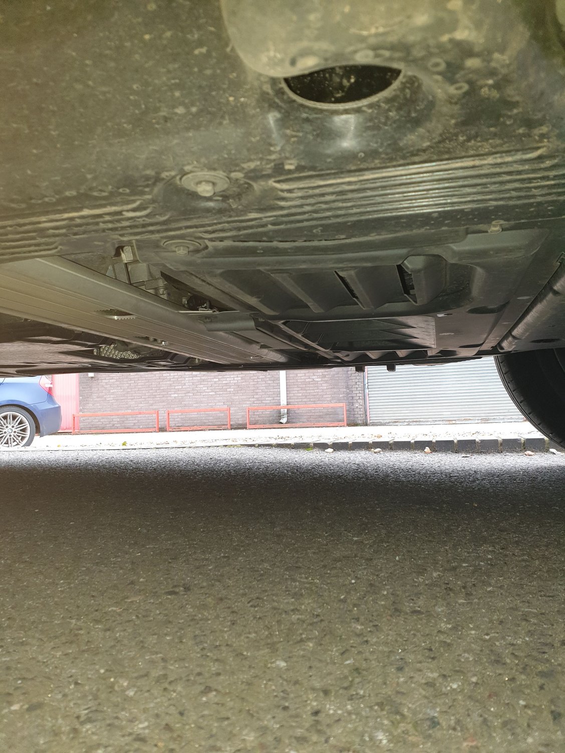

Here is a more complete view of mine. Also a 450
Wiggis: Thank you very much for the photo!
Can North American GLE450 owners post their picture? I like to make sure this is not normal before I visit the dealer..
