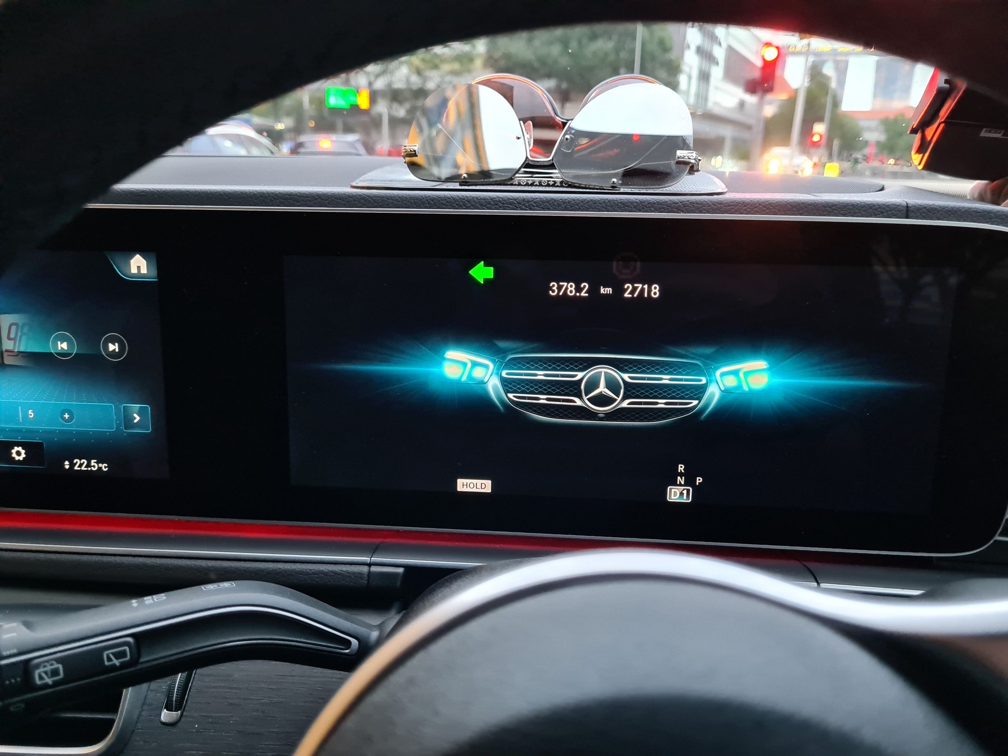

Just experience black out on the main screen while driving and i did not touch any button.
Is there an option to shut down the main screen?
Stop the engine and lock the car and restart the engine, same situation to the screen.
Do I miss anything here?
Or i need to send to dealer to check?
Thanks
