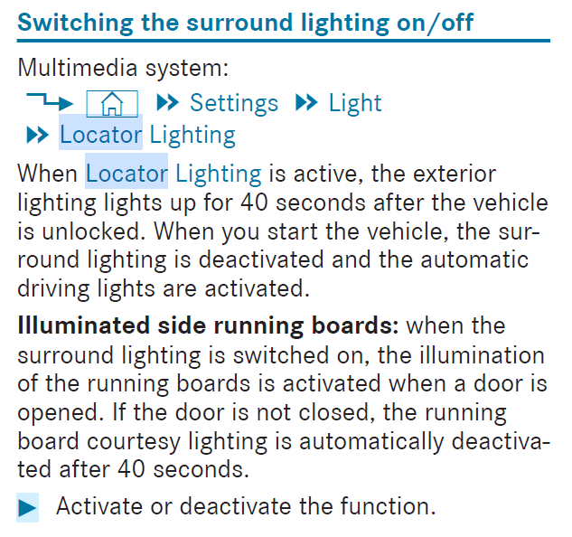

There is a setting for it. Double check to make sure it didn't get turn off somehow.

I stand corrected forgot the mirrors were part of locator lighting. You can also change the time from 15, 30. 45, or 60 seconds under Exterior Lighting Delay on the same menu page in MBUX Be careful there is also an off on the delay page that will also turn off the lighting. Check both

There is a setting called 'Welcome', if I'm not mistaken, under the LED settings. Turn that on and you should be good. I think someone else said that your headlights need to be on auto as well

Thanks for your help! I was able to get it restored. Don’t know what I did to get it back on however, it’s not projecting a large circular logo on the ground as it did initially. ???

There is only one setting, on or off. Either your projectors are broken or possibly dirty.
