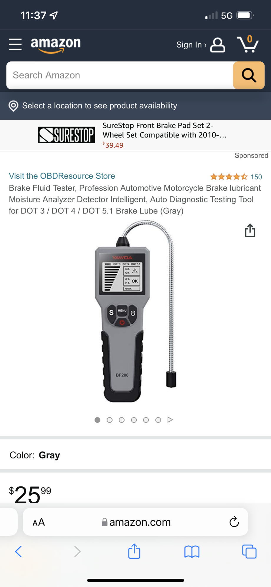

I don’t recall what all was done, would need to find the receipt. I do know Items such as brake fluid are more time dependent than mileage depend. Brake fluid is hydrophilic, and will condensate water in the brake line over time…too much water in the brake fluid is not a good thing. Of court there is a tester you can purchase that tells you how much water you have in the brake fluid. It really depends what they are going to service.

…or they could test it for water content to see if it’s still in spec.

Hmm. Seems to me that to do such a test, the fluid would need to be flushed. If not flushed, where would the test be done? The fluid reservoir ? Fluid bled from one of the calipers? These samples may not show the whole picture. If the fluid is flushed, it might as well be replaced with new fluid. I wouldn't trust a limited sample.
