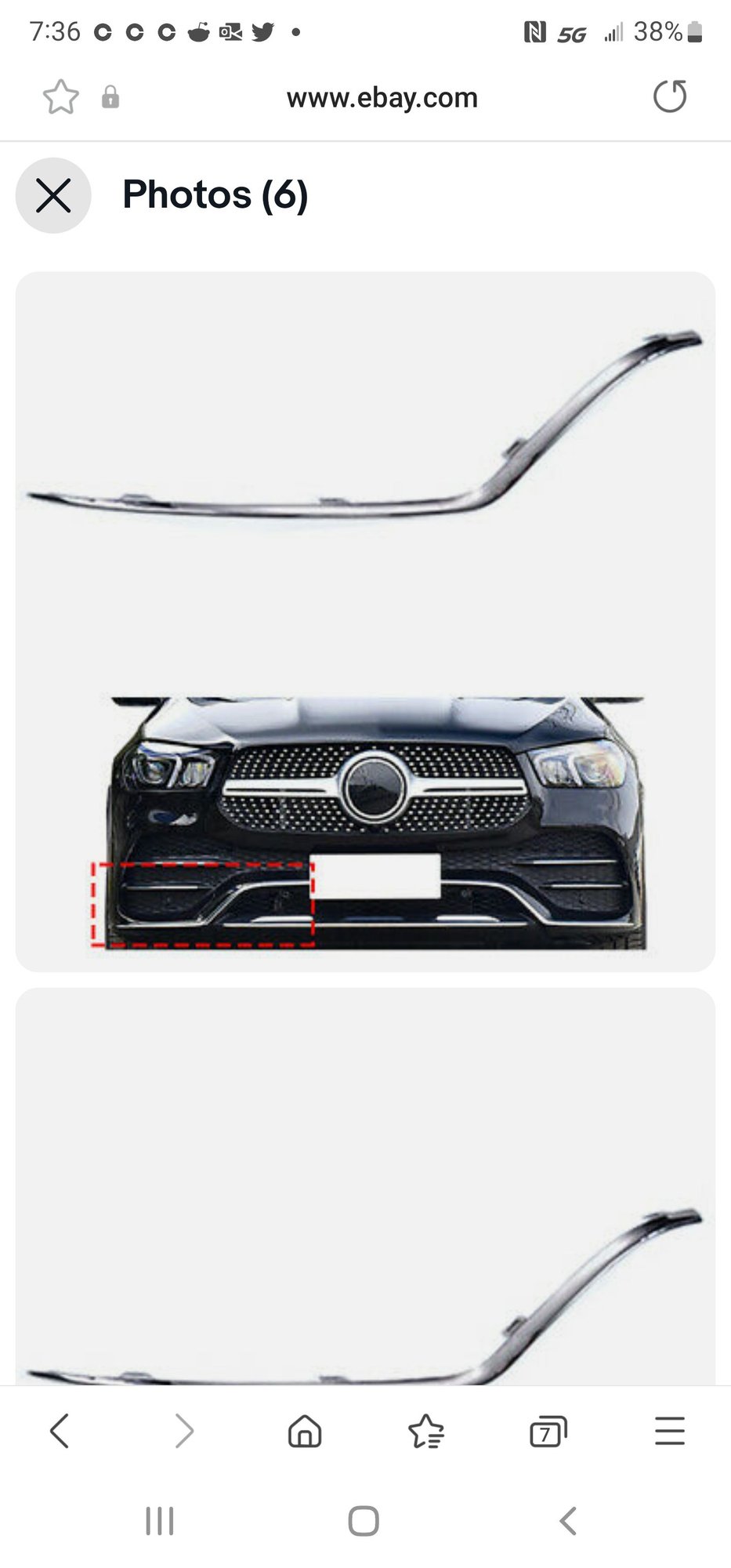

Hello,
My chrome trim on the front bumper was damaged and will like to replace (Damaged at a Car Wash) it but there was no manual on replacing trips only the bumper on WIS. Mbparts sells the trim alone so I assume you are able to swap it out. My question is if anyone knows how these trims are attached to the bumper? I am posting a picture for reference.

They just pull straight out. Dead easy with a trim tool or knife slid behind them. I had them all off to wrap them black.

it appears they are held together with clips behind the bumper. The clips can be accessed by removing the cover underneath the radiator and the push in clips in the wall in front of the wheel.

Having to replace this piece as well based on the paint flaking off.
Can anyone confirm based on convo up above?
1-trim piece pulls right out using plastic trim tool or knife.
2-reinstall should just snap back without removal of bumper
**take care not to snap clips
