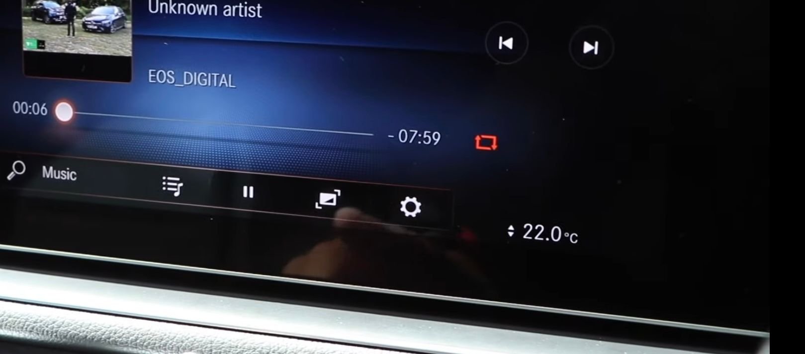

I was wondering why ours doesn’t play videos. I looked it up and noticed that ours does not the screen icon between pause and setting wheel. Is it an option or I need to change setting somewhere? Thanks.

Do you have the 549 or 548 head unit? The 548 will not play video without aftermarket accessories.

Best way to know for sure is with the build sheet you might have or the dealer would. The VIN decoder sites will have it as well, if you can get your VIN to work on them (some of the new ones don't seem to).
If you have Augmented Reality or Dashcam feature, you almost certainly have the 549 version that should play video.
If you have don't have those, you very likely have the 548 version that won't play video.
As makriss0000 noted, getting the NAV to display full screen on the driver's side is an indicator of this as well. Might be the easiest way to check.

Wow didn't know you need a different head unit to be able to play video. Talking about nickel and dime. I just looked at my build sheet. Yes, 548. What accessories do I need to be able to play video? Thanks.
