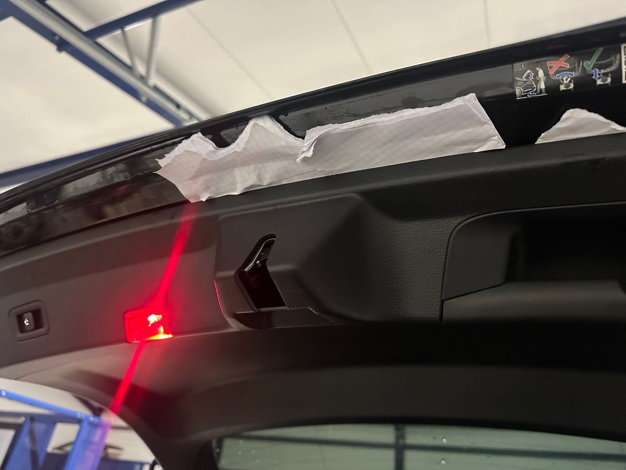

I bought a 2023 GLE 450 months ago and it’s fairly new. There is this annoying rattle sound from the trunk when the car goes on small pothole or uneven road. I think I have pinpointed the spot of where the sound is from. Attached the picture.
The sound come from the interior area around the light.
Wondering if anyone had similar issue and manage to fix. Much appreciated!

Check all of the cargo door hinge and latch attachments to see if any are loose.

Check for anything loose or moving in the spare tire well. Sounds originating from there will reflect off the rear window and sound like they are higher in the car.

Lower the lift gate/hatch, and gently press the rear hatch glass around the hatch frame. Make sure the glass is seated securely in the frame…there should be no sound. If it makes noise have it fixed under warranty.

Since I originally replied to this post, I traded the 2020 GLE for a 2023 GLE 450 and experienced the same noise. First the dealer replaced the struts on the rear hatch door to no avail. Their next move was to adjust the latch on the rear hatch and that seems to have eliminated about 90% of the noise.
