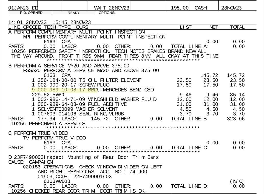

So I just got back from the dealership for a service A. $325 and on the way home I check Oil level and it's on LOW...WTF right. Emailed Service Advisor told me that's ok but to bring it back at my leisure to fix. Couple things...first I drive an hour each way for service so I just don't want to pop back for oil. Secondly how OK is it if they want me to come back to fix and finally how does this happen? I've noticed on all 3 of my previous GLE's oil goes from Max to half way between max and min over the 10,000 miles so I assume this isn't good.

Just tried looking up the part number for the motor oil and it's coming back as BREAK FLUID? Anyone know what's up with that?

The Dealer would probably use bulk oil from a 55 gallon drum. The invoice lists 5W30 the 229.52 is the oil spec. Mobile 1 ESP 5W30 meets that criteria. AutoZone or any parts store should carry that oil. Check on the bottle to see if it lists the 229.52 spec…ESP is advanced oil with “emissions system protection”. ESP 3 used by Porsche offers higher protection and would be a good substitute. Any oil 5W30 229.52 would work.

That part number comes up as Mercedes 5W30 229.52 synthetic engine oil. You may have transposed a number. The brake fluid is part number 000-989-08-07-01
It sounds like they owe you a quart of oil that you paid for and didn't receive.

So one court should do it??? Received this from the SERVICE MANAGER this morning after Advisor stopped responding. I've owned 3 GLE's and never heard of this or had the oil appear so low. Thoughts? I've always been at max or 1/2 way in between and never had anything TRIP???
