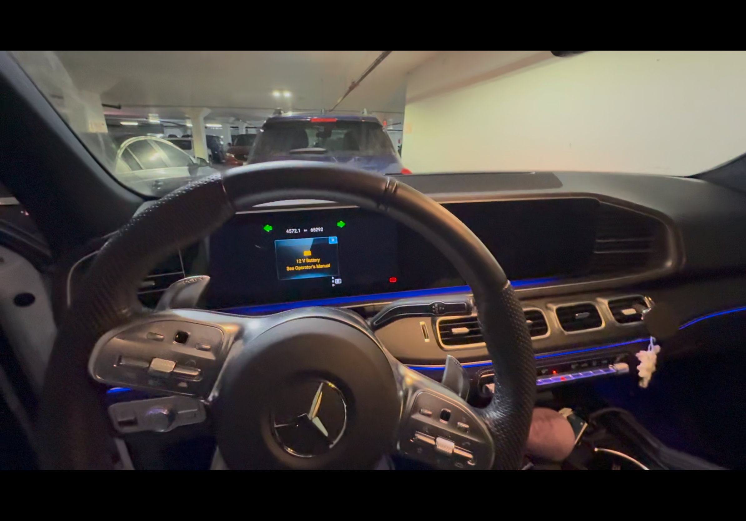

Hi everyone,
I’m reaching out to see if anyone else has experienced a recurring 12V battery issue with their 2022 GLE or has any advice on how to resolve this.
I first received a “battery low” warning last year and brought the car to the dealer. They checked it and said the battery was unhealthy, so they replaced it under warranty. However, the issue returned after only a few months.
Here’s my driving pattern:
• I drive the car about three times a week.
• Each drive is typically 1–2 hours long.
Despite this, the issue still persists. Here’s what happens:
1. After parking the car, I usually get a notification about the battery issue around six hours later via the app.
2. The next day, when I unlock the car, the alarm gets triggered.
I’m wondering if this could be due to something draining the battery while parked, or if it’s a deeper issue with the car’s electrical system. I’ve heard mixed things about parasitic drains and software updates being potential culprits.
Has anyone else experienced similar issues with the 12V battery? If so, how did you address it? I’d appreciate any insights or suggestions before I head back to the dealer again.
Thanks in advance for your help!

Assuming you haven't installed any aftermarket devices such as a dashcam or radar detector that was wired into an always hot circuit, there could be some OE device causing the problem. Contemporary cars never completely shut off, but after being parked for 10 minutes or so, the car should reduce its power consumption to less than 0.1 amperes. If you can afford to be without your car for a day, ask your dealer to monitor power consumption for several hours while it's parked. Alternately, you can buy a clamp-on DC ammeter (~$100) and do this yourself if you can access your battery without difficulty.

You have a defective battery. Take it in for replacement, there should be a percentage of warranty coverage if not the whole thing.

Thanks for your response! I did have a dashcam installed that takes power from the rain sensor. The dashcam has two modes: normal recording while driving and a timelapse mode during parking, which runs for a few hours before shutting off automatically.
Most of the time, it worked fine without issues. However, I noticed that during the instances when the battery drained quickly, the dashcam seemed to be recording as if the car was running (even though it wasn’t). To rule out the dashcam as the cause, I unplugged it on the first day the battery issue occurred.
As of now, I don’t have any other devices plugged into the car, but I’m wondering if the dashcam activity could provide a clue about what’s going on. Could it be related to the car not properly entering sleep mode?
Any insights would be greatly appreciated

Thanks for the insight! I actually don’t have the dashcam installed anymore, as I removed it last month to rule out any potential parasitic drain it might have been causing. However, the battery issue has still been happening over the past month, which makes me feel weird about the whole situation.
