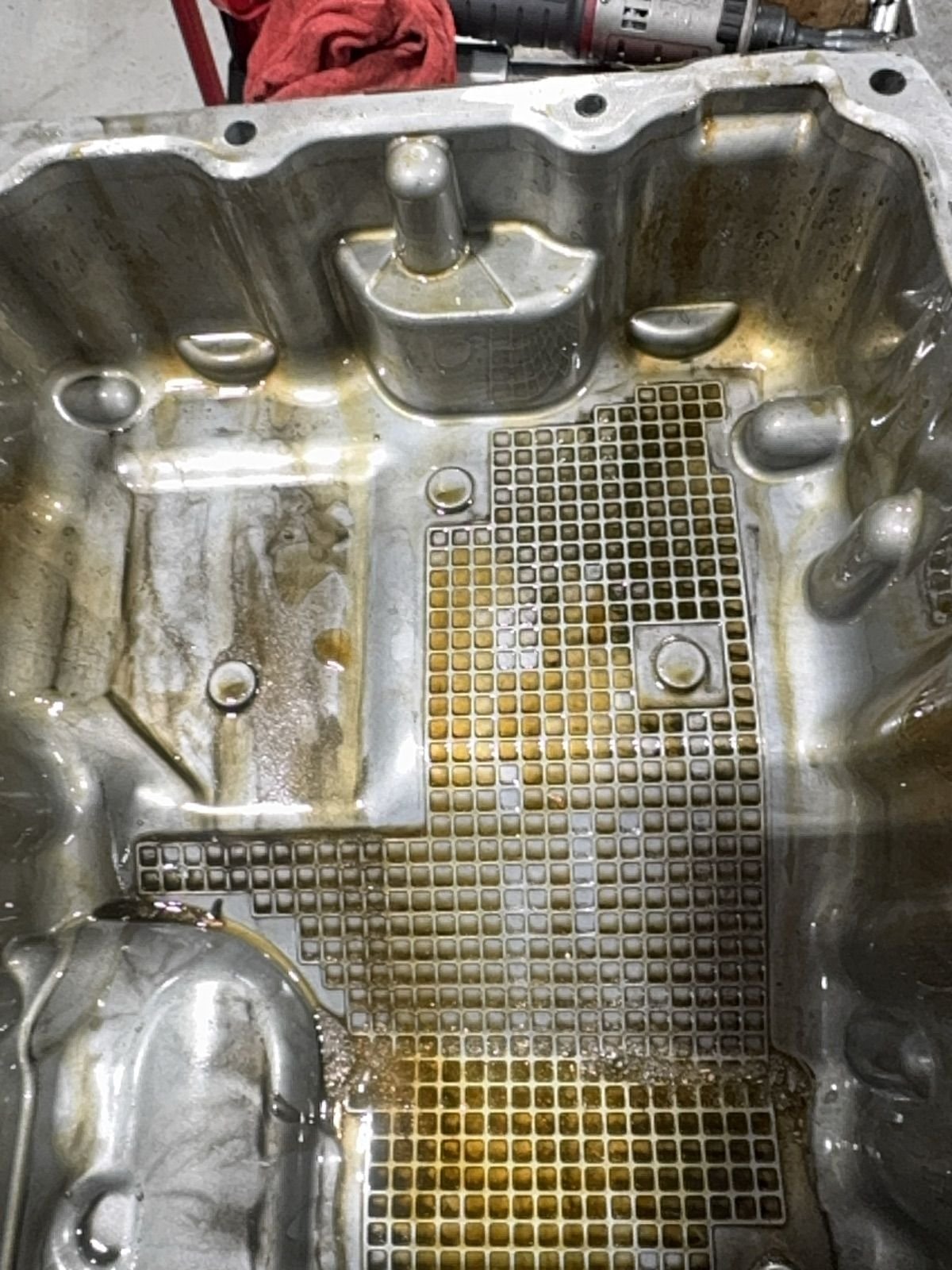

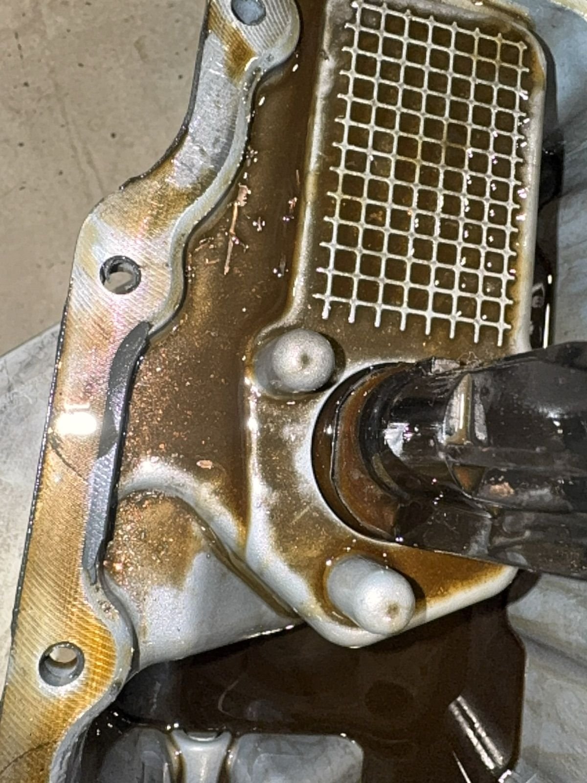

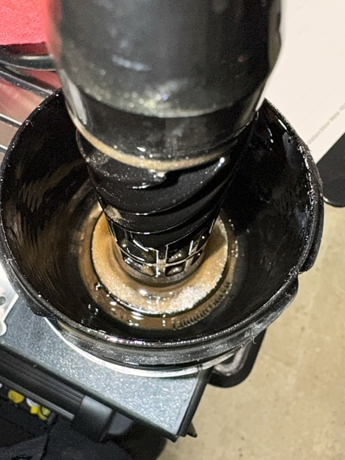

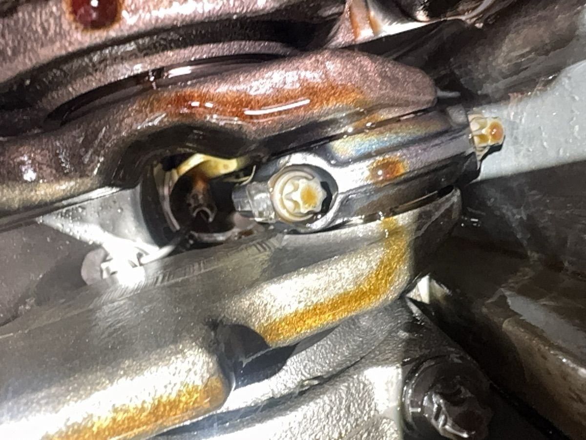

Thank you both. As for a list of questions if y'all have any other suggestions outside of what you've already said I'd love to have them as it's a little over my head at this point and I'm trying to educate myself as much as possible.
I do know that they stated that there was bearing debris in the filter but that's more of an aftereffect.

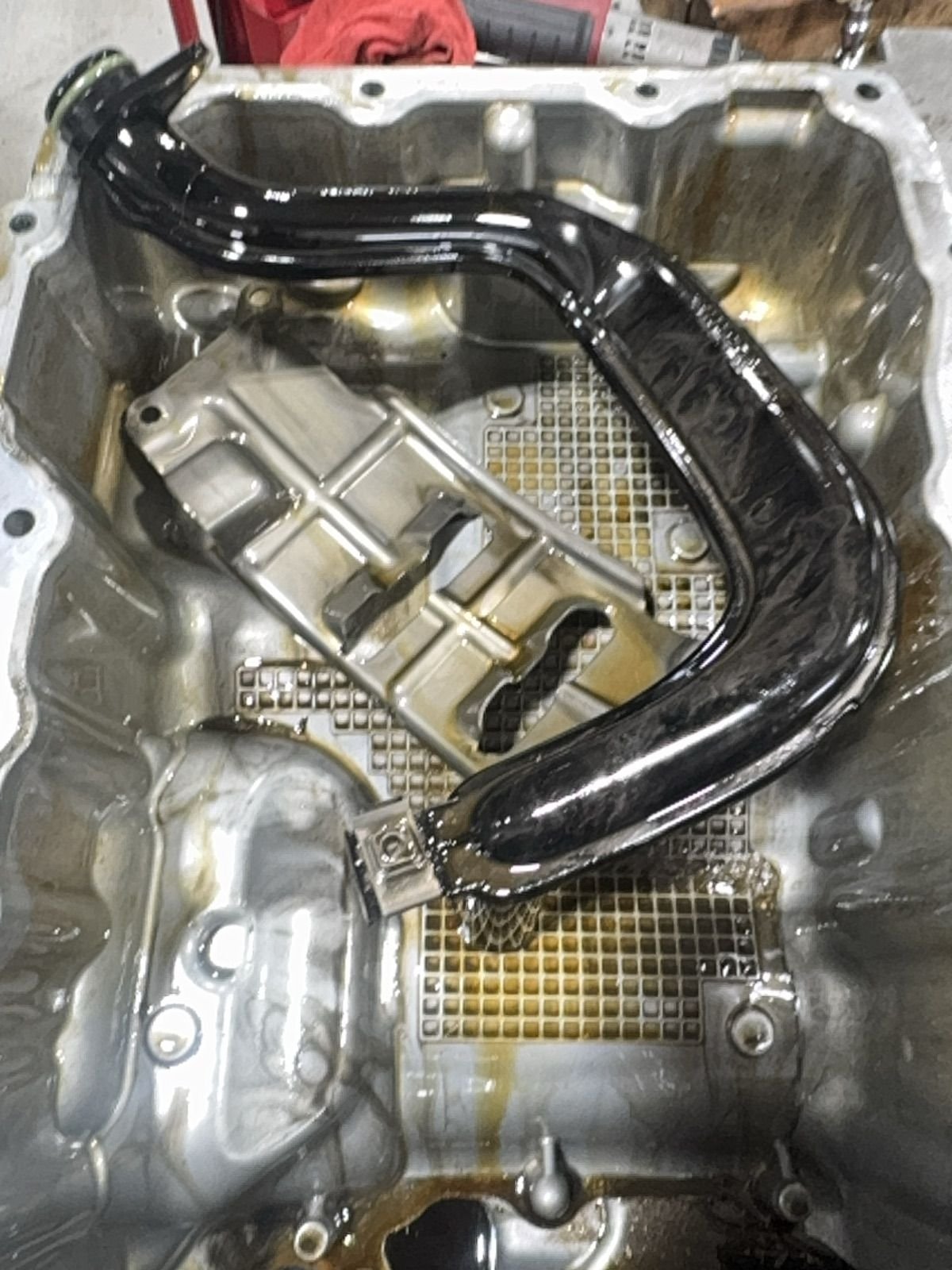

Here are a few photos that I've been sent. I have a video of the tech moving the bearing back and forth but i can't apparently upload it.

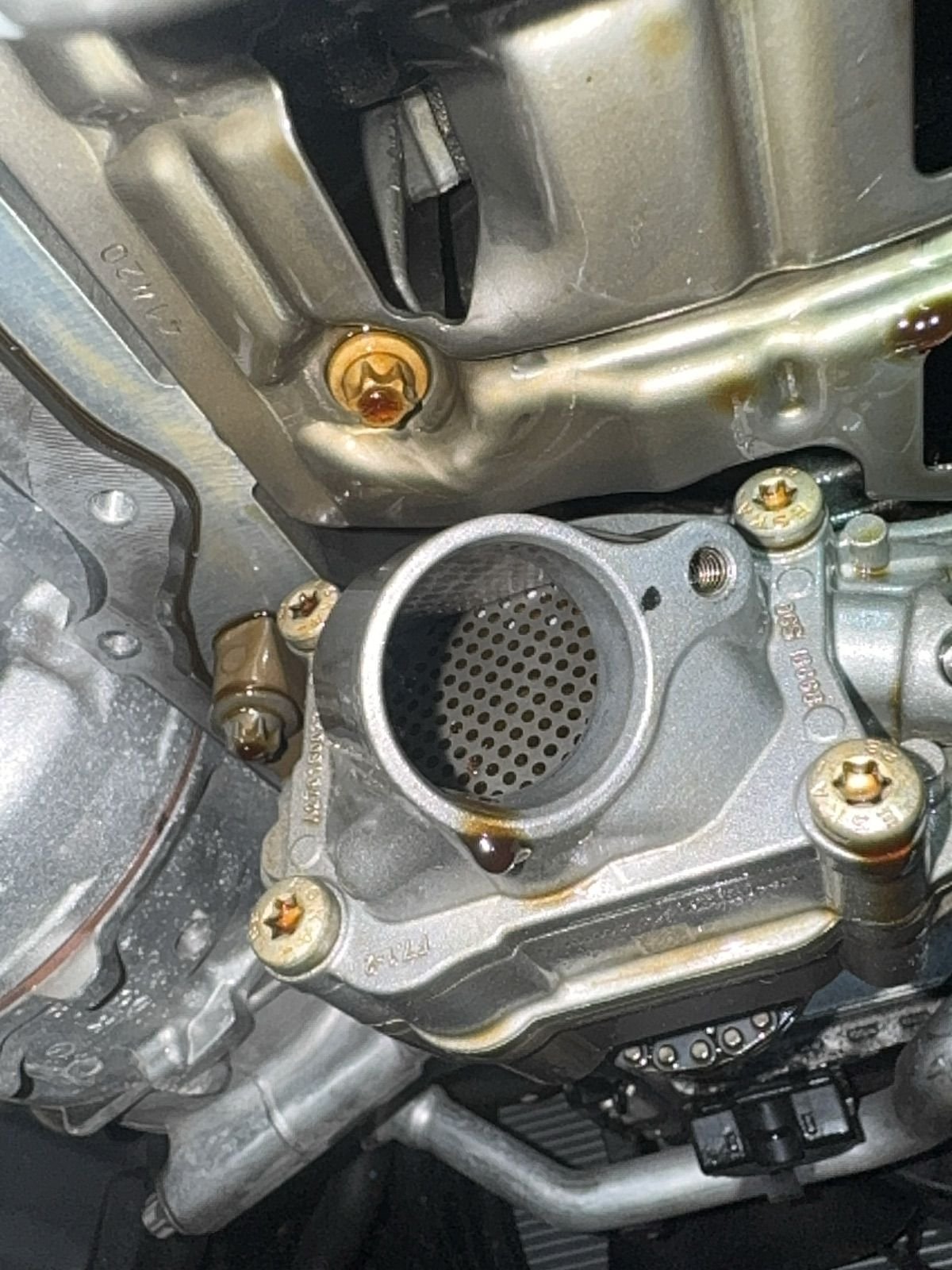

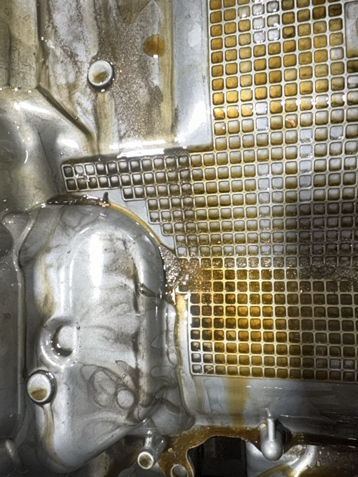

Here's a few more.

The photos say nothing.
Suspect the shop is fishing in your wallet.

if that the pic of you Engine. There is enough "Glitter" in it to require rebuild, or at least a short block. it's all throughout the oil passages. That oil filter housing tells the tale too. I don't see any pics of you cylinder walls so you don't know what scoring occurred from the glitter in the oil.
