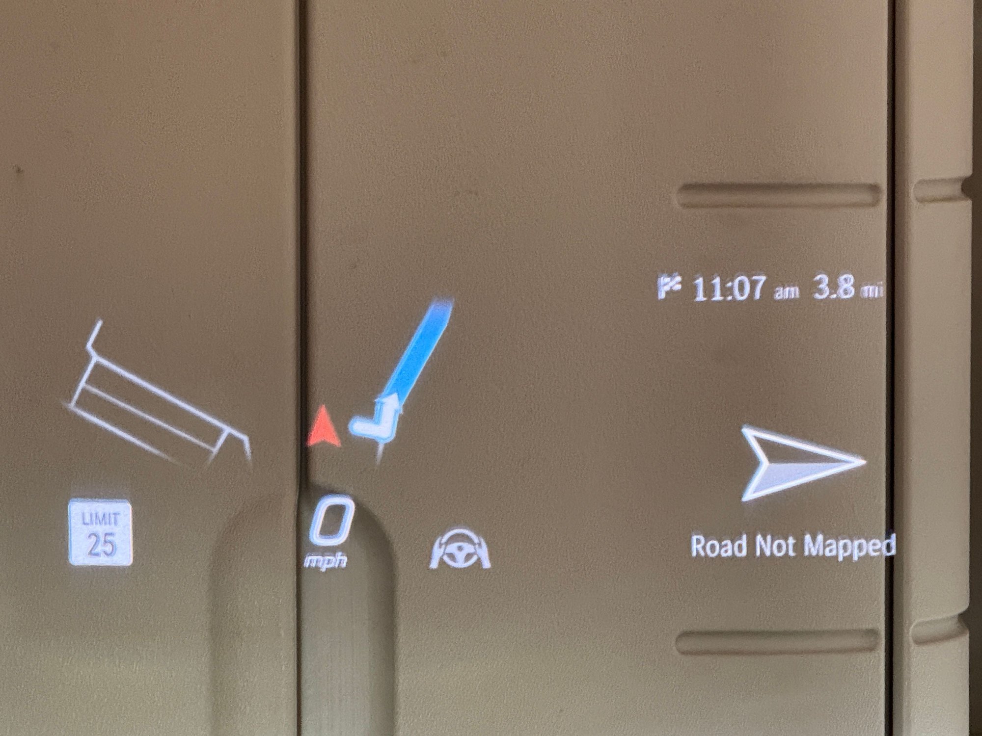

No windshield replacement — still factory glass. I’ll post a photo for y’all to compare to and contact my dealer.

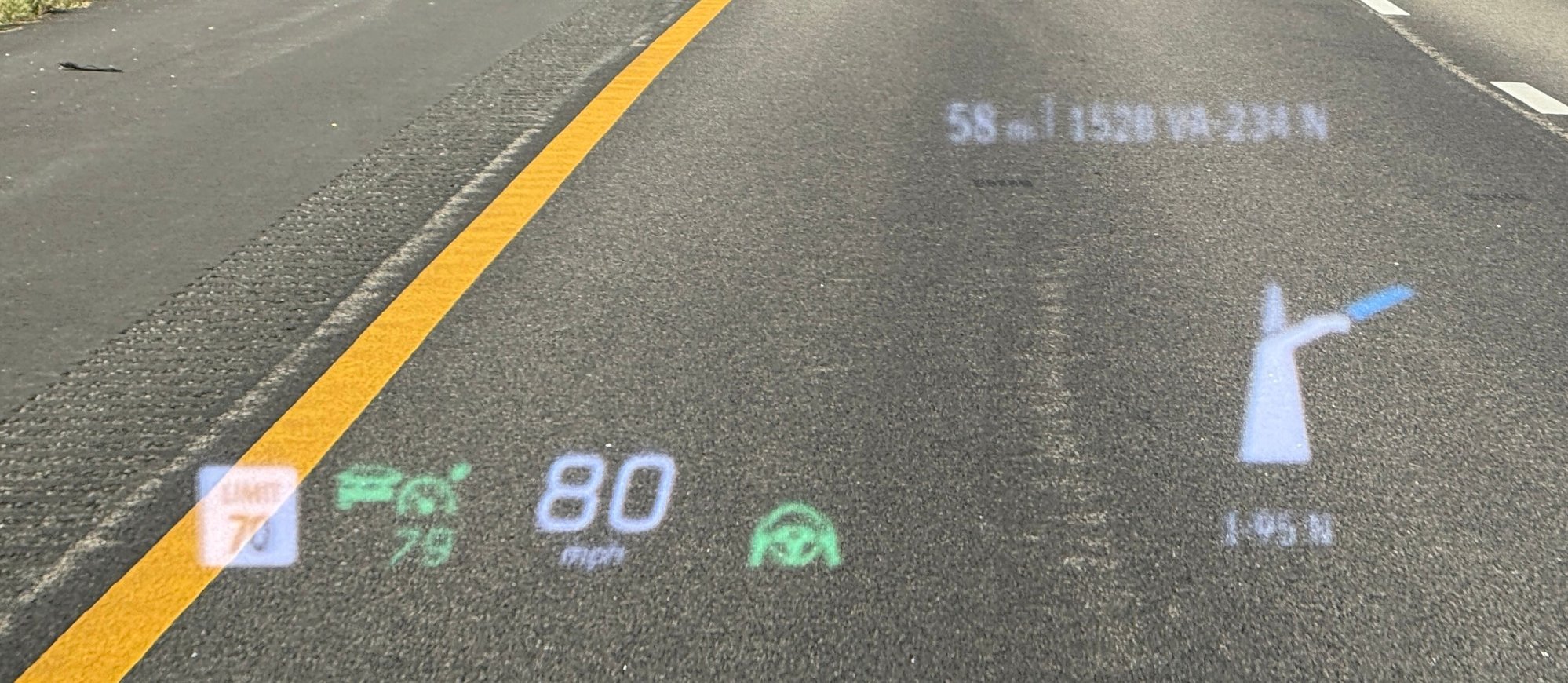

This is the best photo I could get while my wife was driving. Needed to show the turn by turn — the smaller navigation text is almost unreadable when you’re in the drivers seat. I’m planning to compare with my friend’s 25 GLE 450 this weekend.

Did you try cleaning the HUD screen on your dash with a good microfiber cloth?

Thanks! I’ll do some research to see if I can get into this menu on the 2024+ GLE. I did try cleaning both the windshield and the HUD itself. Car is brand new and has been like this since I bought it.

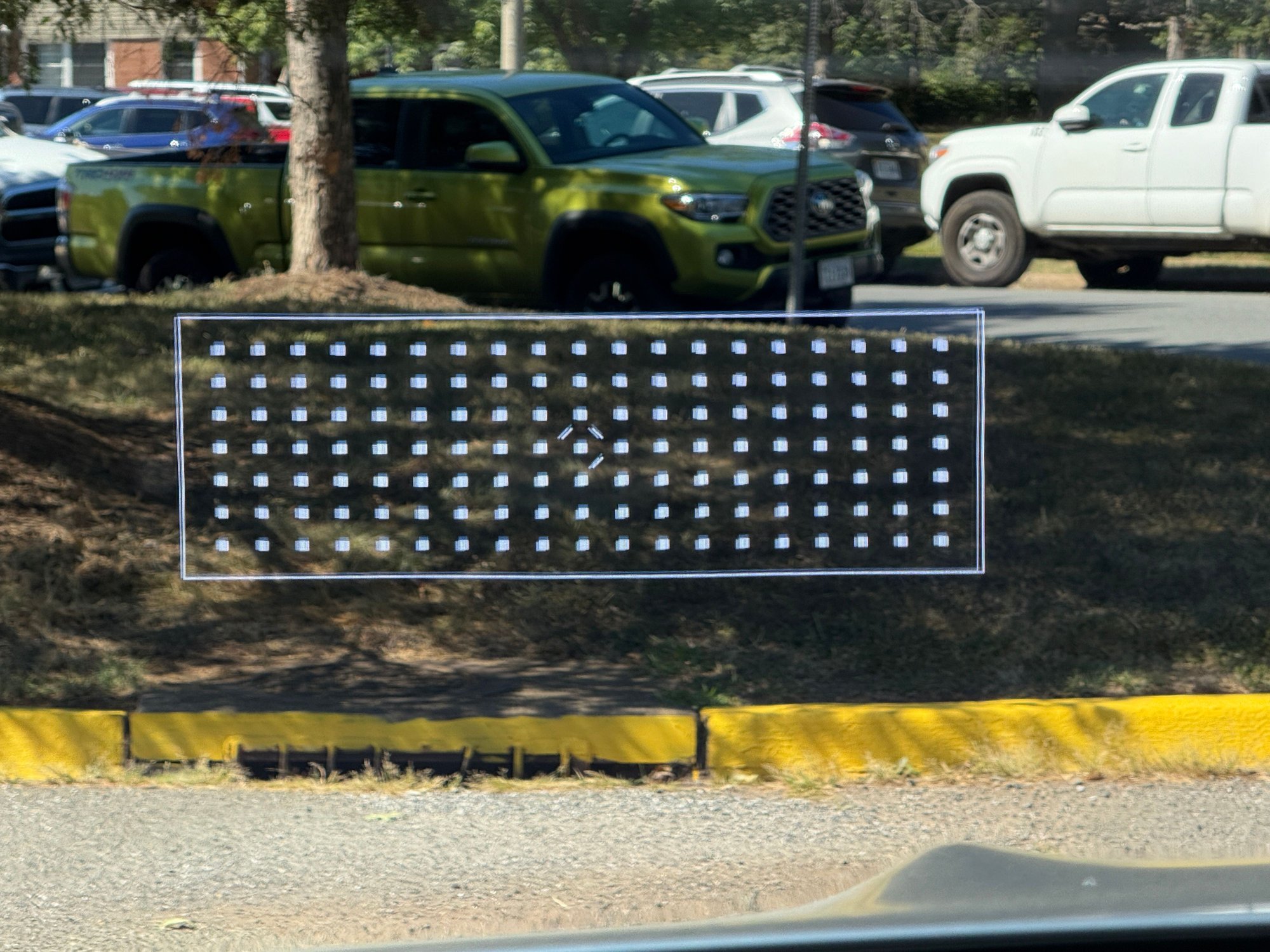

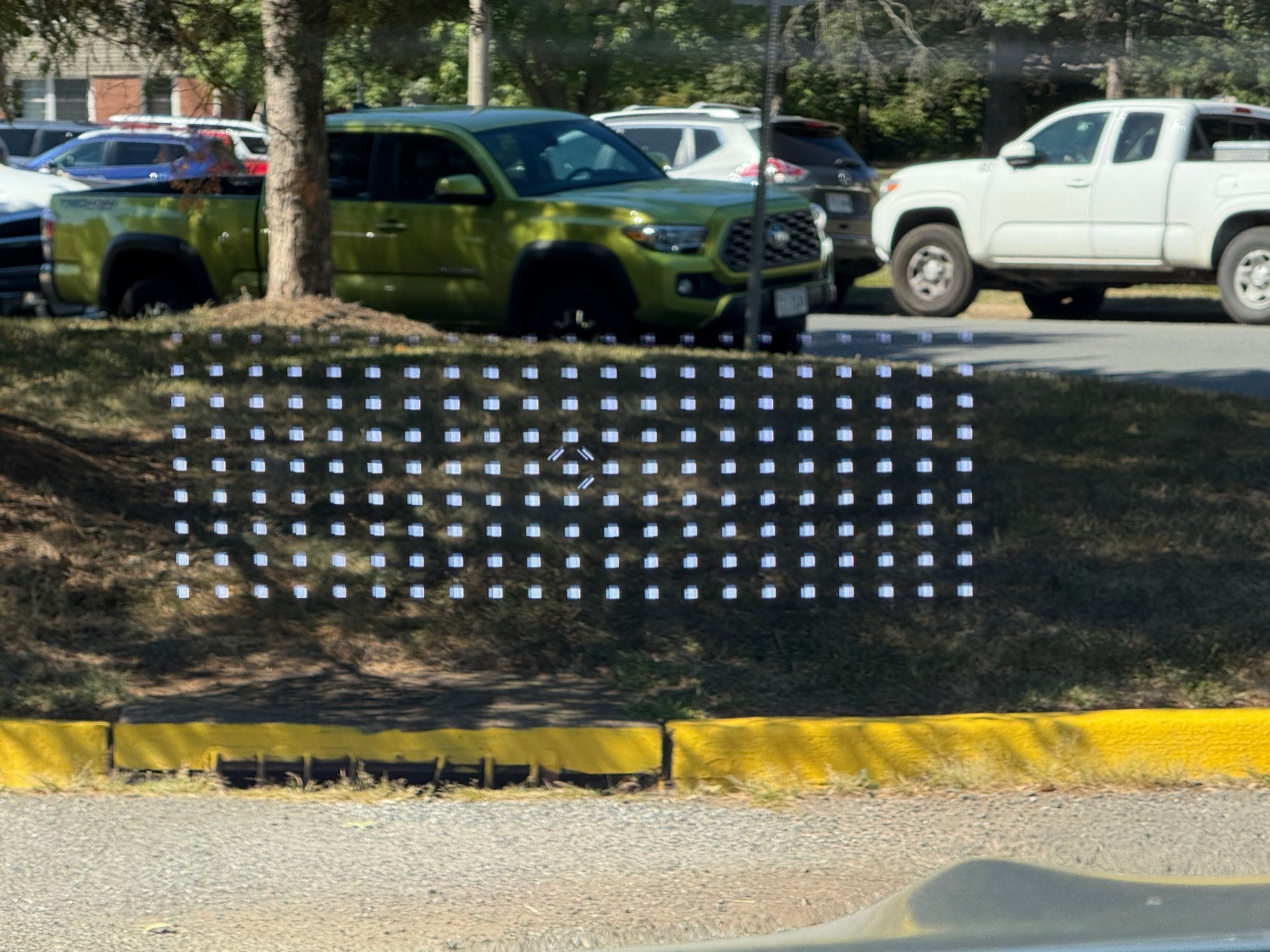

Here are some photos using the workshop menu’s test images — hopefully this better illustrates the lack of clarity and double images. Thanks for the help y’all!

It looks like the dealer will need to fix it. My HUD had light bleed and they fixed it. It does require dash removal but I've had my dash taken apart twice with no issues: HUD and actuator.

Thanks for the info — I compared to a friends 25 GLE450 and it was way sharper… definitely an issue with mine

Example of my friends car. Way clearer.
