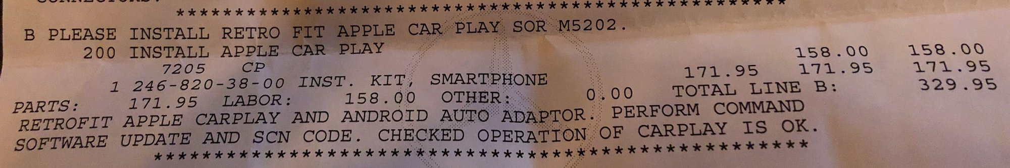

Our GLE was produced after the Jan 8th cut off date (Jan 12, 2016 production date to be exact) and still didnt have carplay/android auto despite having the updated interface/USB with a tablet picture in middle console etc...
I phoned our local dealer here in Calgary with the VIN number and their parts department advised that there is a part available and that they can retrofit carplay! Will report back as to how this goes.....

The retrofit was completed this week with full success. We now have apple car play on our GLE that previously didnt have it installed. One dealer said it could not be done so I phoned the other dealer in town....
See bill below - the cost was very reasonable.

Part Number: 246-8202-38-00 (Retrofit Smartphone Integration P (C 14U) online price is $97.20 (List Price: $125.00) from MBoemparts.com.
What is 7205 CP for $158.00?

Labor? They had to update the software......
