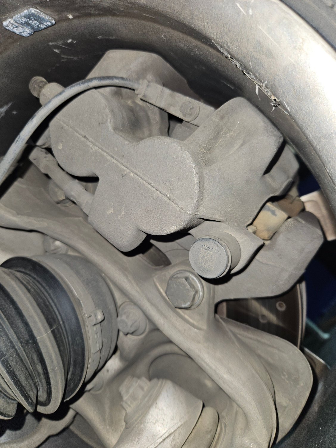

Further adding to this thread, I am in the process of trying to source some 18" rims for my GLE 350D amg with an offroad package. and I am really really struggling. I have noticed that the spare is a 19", but then I also noticed that the manual says to ONLY use it on the rear, never the front.
Does anyone know for sure if the amg version had large brakes? to me it looks like they just put the Drilled vented discs in? I mean its not a true amg where the the engine etc is all tuned is it? Its just a AMG styling package to my knowledge?

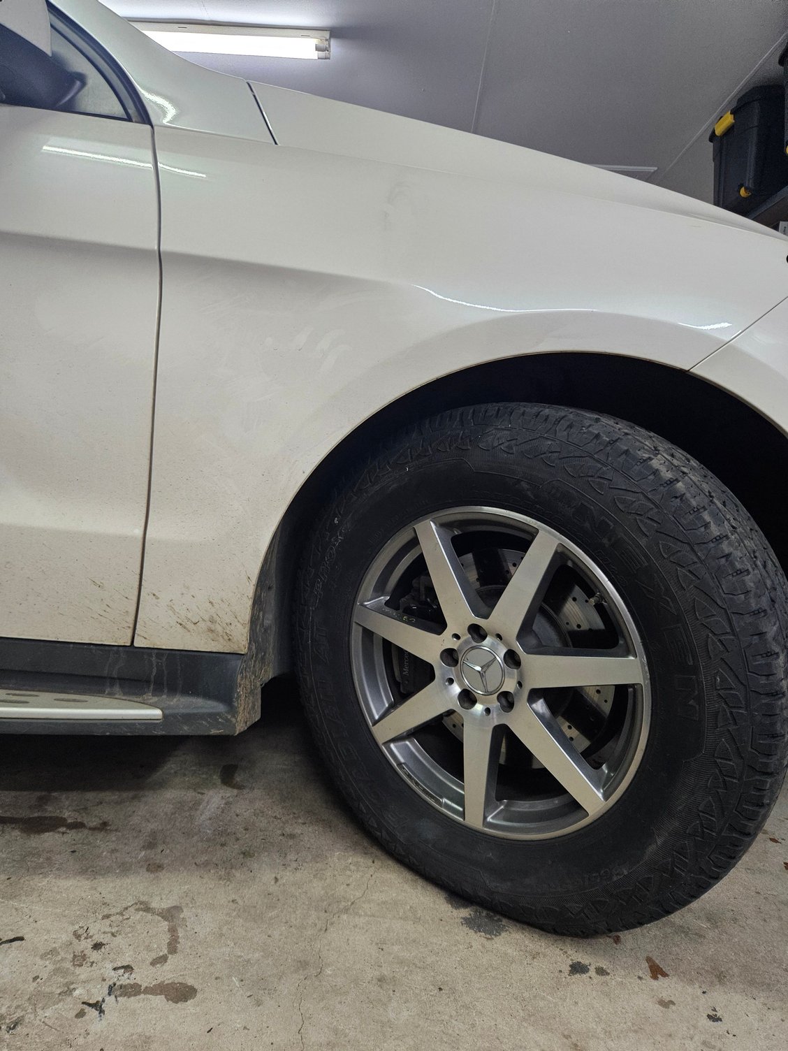

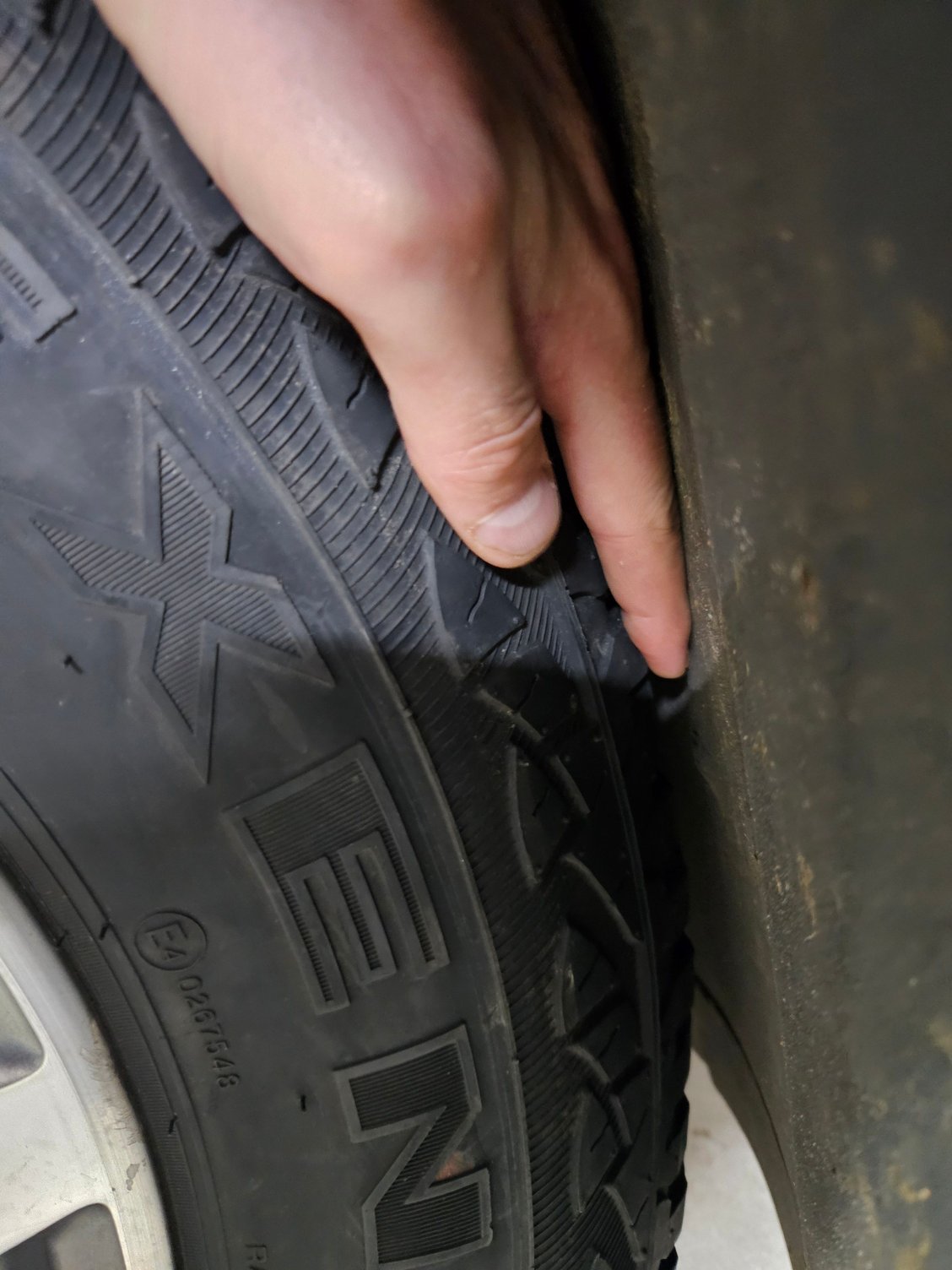

Well i took the risk today and ordered a set of 18 inch rims from a used parts store.
18x8.5J et54
They came with 265/65r18 all terrain tyres.
And beleive it or not they fit. Im gonna say they fit with a pinch of salt. The Tyre fits amazingly in the wheel well. The brake calipres clear by like 1mm. Now that seems abit close for my liking, im not sure what the reccomended minimum clearance is. But see some pics attached.
This is 2018 W166 g350d air matic with amg brakes.
