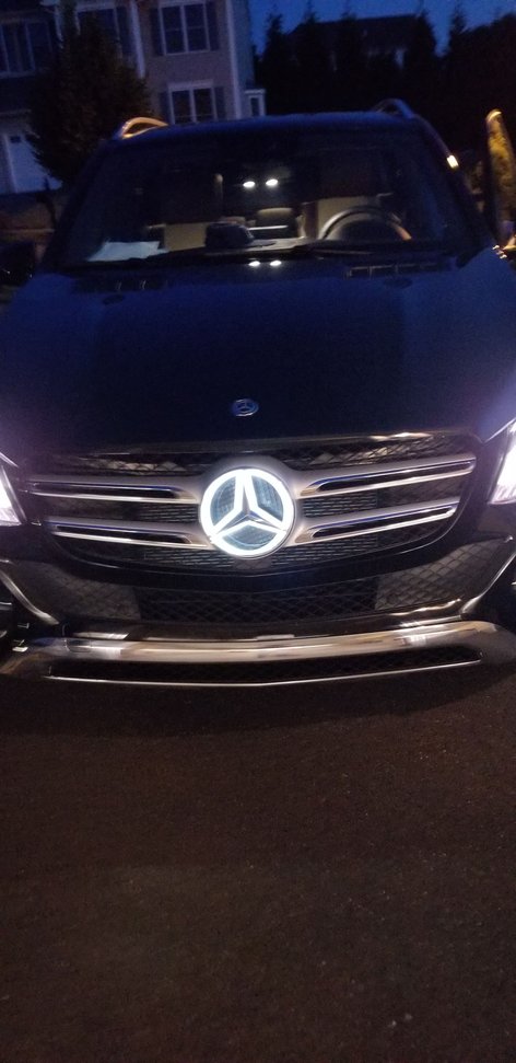

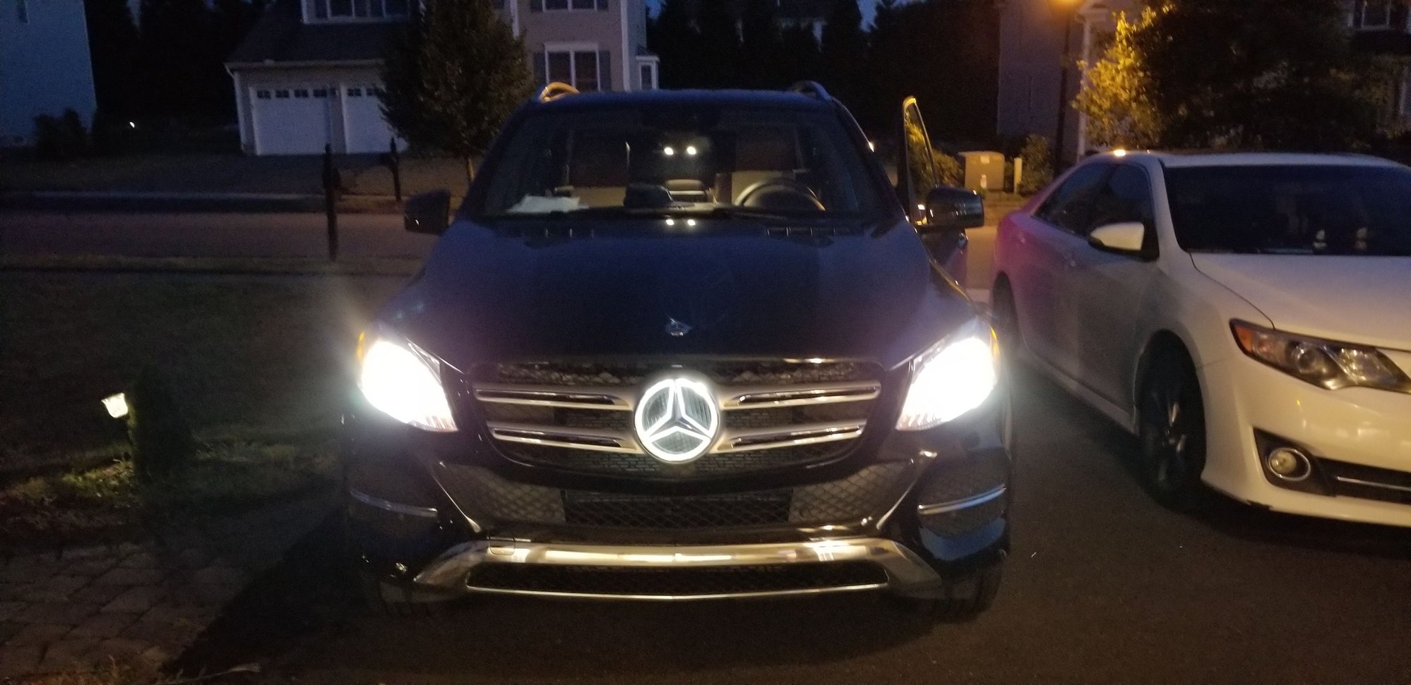

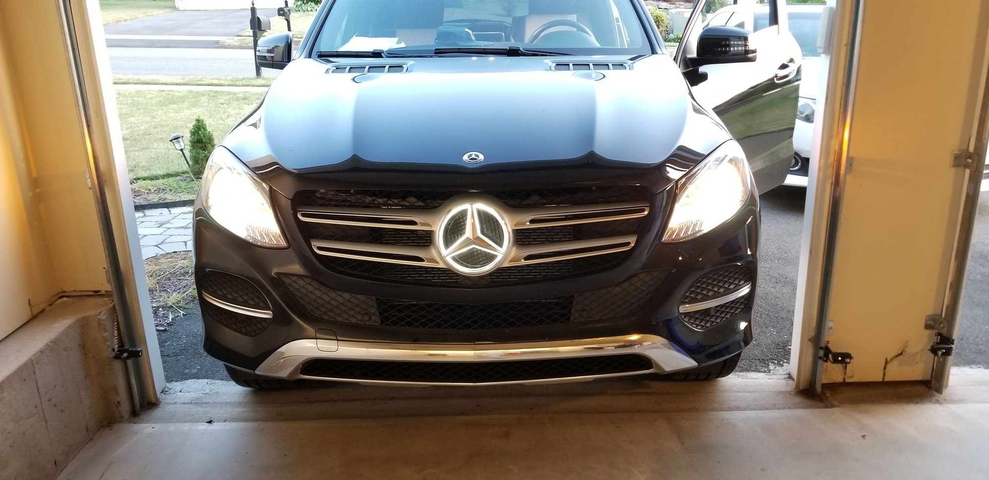

So I was able to figure out myself. Spend about 1 hour trying to figure where is the positive wire and how to perfect wire. Finally figure out. Here is the result!

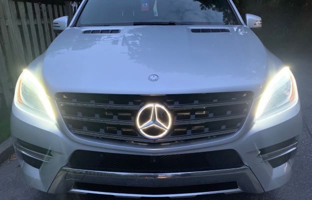

ML350 2015 bluetech
I order from MB a fuse blade and connection (A0045456401 and A0115458426) for about 20$. (You don't need it if a blade already exist in the spare)
I use the spare F233 in the fuse boxe (drill a hole and use hot clue to seal it).
The start will light up when the car start or on On position and turn off 30sec after the car is turn off.
It takes about an hour to setup, max 2 hours.

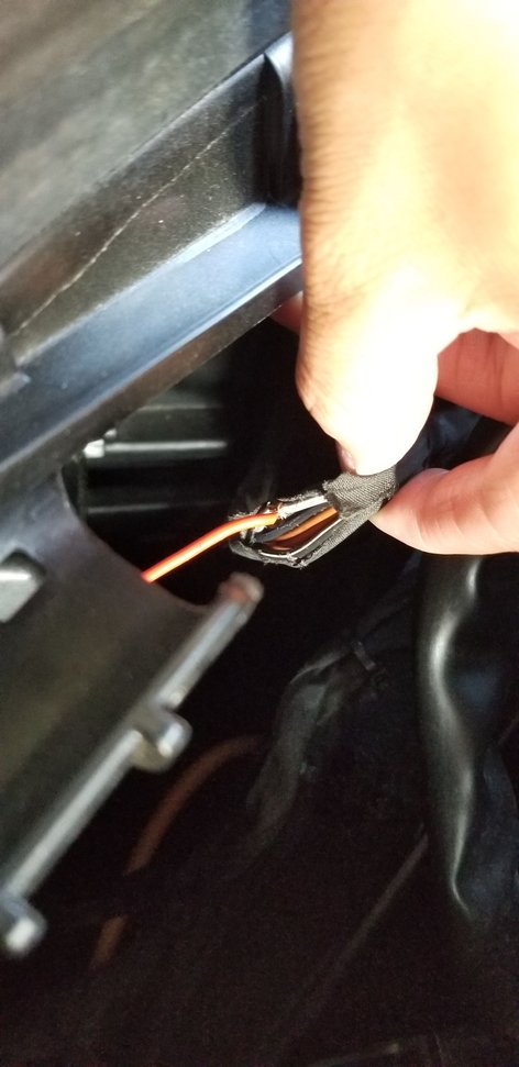

Any chance you can take a picture of how you wired inside the fuse box and the best ground location?
I didnt use the fuse Method, i figure is too long process and too much. I just connect my red wire into headlight. The wire color should be Gray color with white straps.
Any chance you can post a picture of it?
Old Nov 5, 2019 | 07:26 AM
Chao Hang Lu's Avatar
Joined: Jul 2019
Posts: 19
gle
Here

Thank you for the pix. Gives me a bit of confidence in this challenge. How come you opted not to use fuse #233 in the box itself?
Also, the wire you have connected directly to the grey/white, is it an inline fuse type?
thanks so much and I’ll post my install with credits to you!
I just think wire to headlight easier. Connecting to fuse require fuse and Maybe drill the box and long process. This way is cheaper and faster way.
Good luck! Make sure your logo is on correct side. I installed wrong way at first and looks weird.
