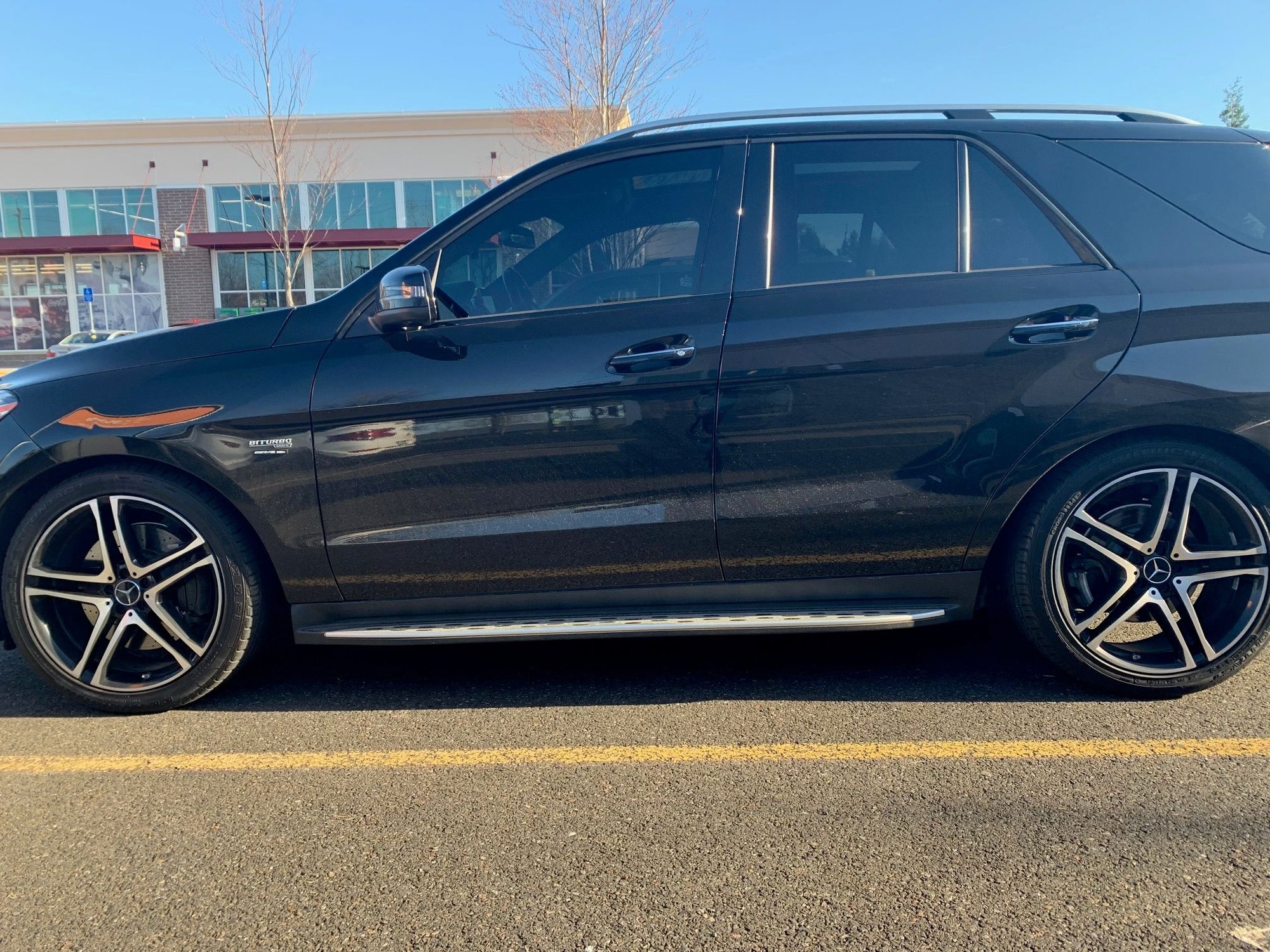

I put H and R springs and 20" AMG wheels. Overall, the ride is OK but the rebound is a tad too quick with the stock shocks. I had 22 inch wheels and they were terrible ride quality.

Bill - Looks good. Wish my ML350 looked that good. My 2015 Ml with 70,000 bounces like crazy but afraid to tighten it up due to spouse not liking a firm ride.

Bill, that looks perfect. How much did it cost (all in, parts+labor) to install the springs?

The springs were $300 on eBay and installation was $721 at my fave independent shop, Star European. The rear springs are not difficult but the front springs are a pain in the butt besides being dangerous without the correct tools.

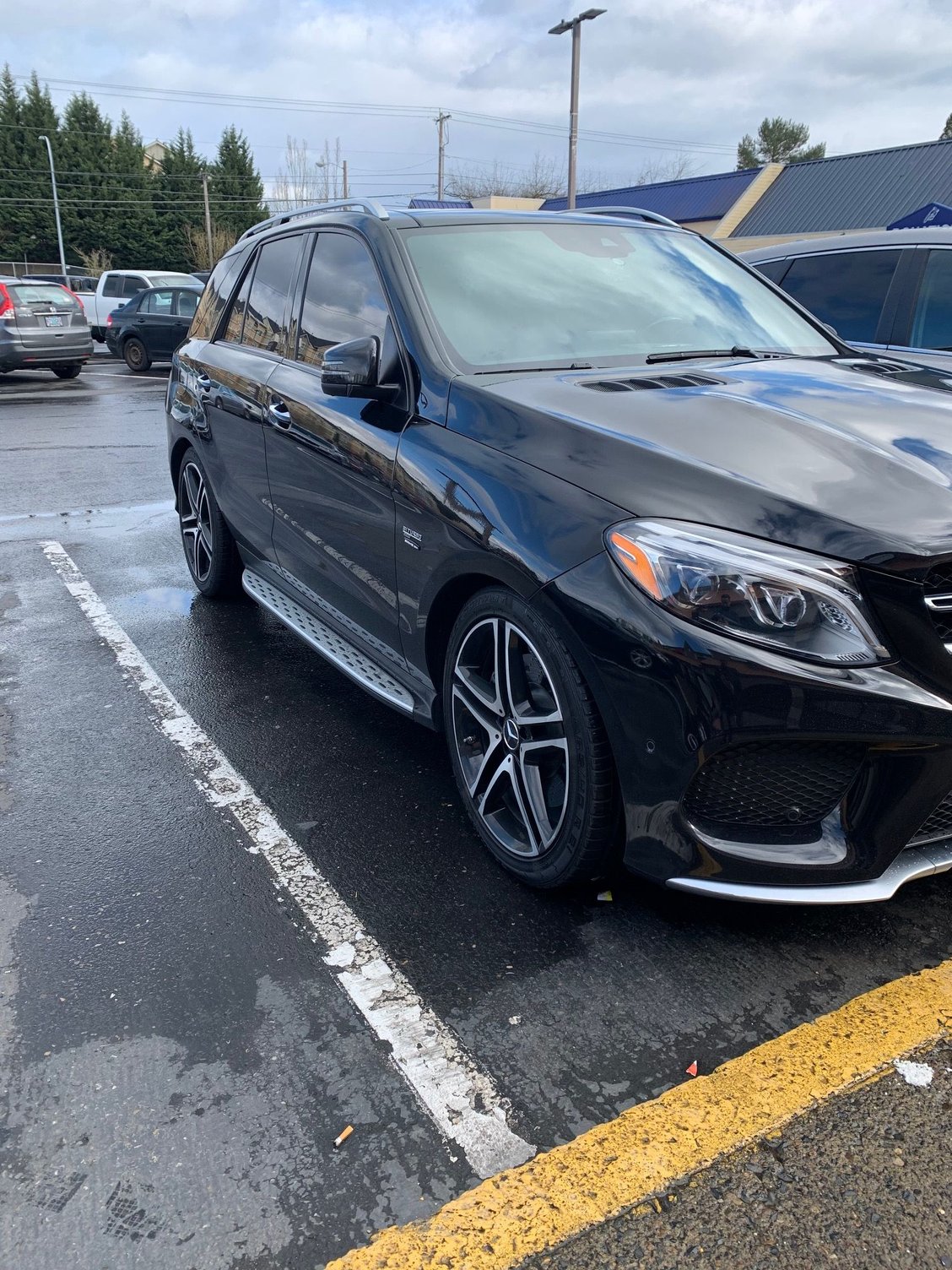

I just installed the lowering module and love it!! Literally plug-n-play.

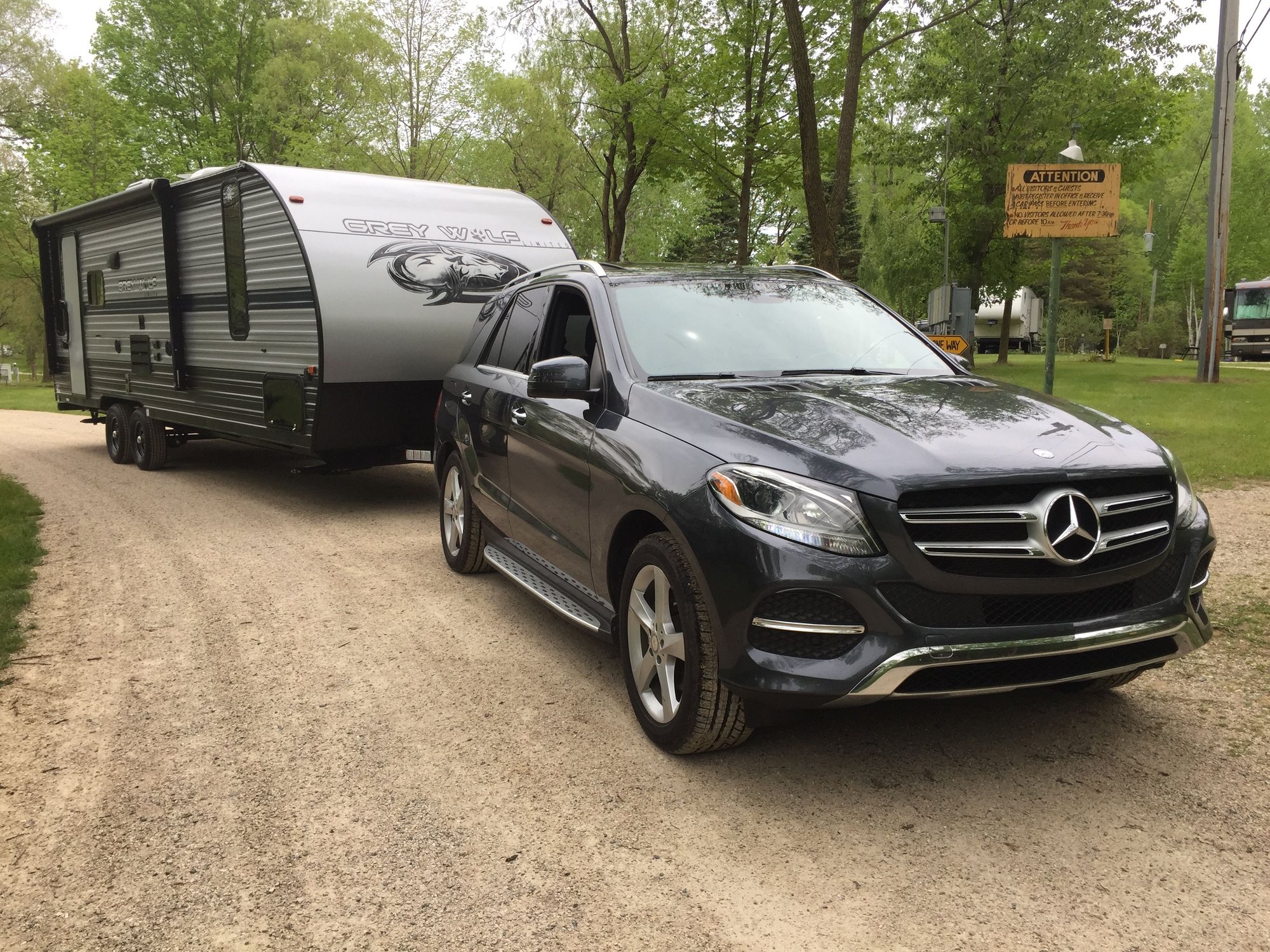

Yes, I use a WDH and have been towing with my GLE350 4Matic for going on 3 years now - https://mbworld.org/forums/gle-class...gle-350-a.html.
I don't know if you tow, but while the WDH re-distributes the weight, it does not make up for spring sag which is why even many pickup truck owners add an air suspension (air bags) to their 1/2 and even 3/4 and 1-ton trucks.
Naturally the mistake people make is using air suspensions to make up for weight distribution or even tail-load a camper, but this raises the risk of excessive sway. We don't have any sway problems and I've driven in 30+mph gust storms just fine, but the back end isn't where it should be and neither are the headlights- in part because the springs are exactly new either.
Many truck owners properly set up a WDH along with having an air suspension so until a model comes along where I upgrade I'll have to keep looking for a solution I guess.

Yes, I tow a 6,000# RV like the one you showed, 720# tongue weight.
The WDH definitely "makes up for the rear-end sag."
But if it's improperly sized or adjusted, it won't. The right WDH will level the tow vehicle, and headlights.
I agree that shifting loads rearward is an invitation for sway, but using springs / airbags to reduce sag is a control issue, because you haven't dealt with the lightened steering axle.
A properly spec'd and set up WDH does this.
The pickup owners who have to add airbags plus a WDH haven't sized or set them up properly. Or are way over their payload ratings. Either is unsafe, IMO.
