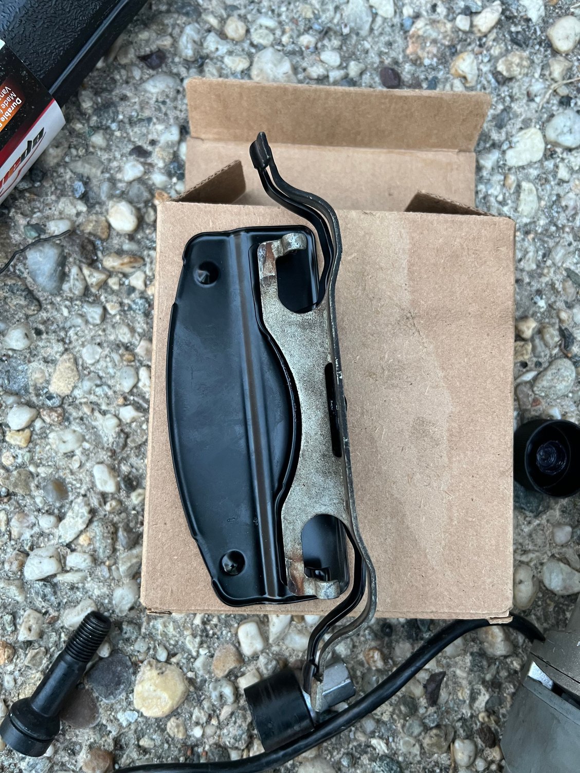

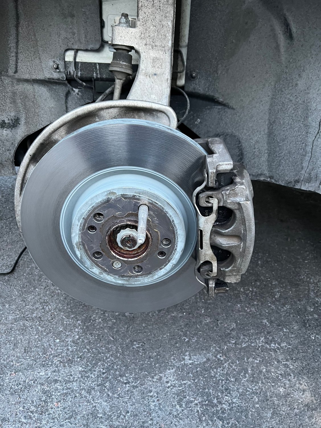

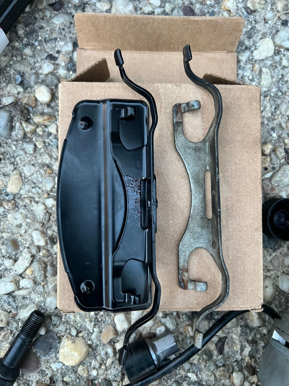

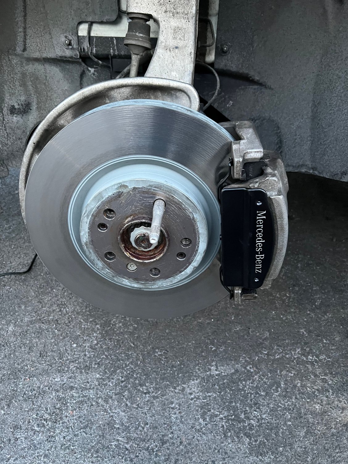

Mini DIY project if anyone wants to add a bit of look to their w166. By luck I found out that regular package and sports package shared similar front brake rattle pin design with similar dimension. Meaning they could technically cross fit. Only slight modification needed (need to cut a quart of an inch off a metal part with a grinder, 30 second job)
parts# 000-993-72-07
Somehow this is actually a few dollars cheaper than the regular pin.

I have been looking for a part like this for a year, the trick is that its called and 'anti-rattle clip' not a 'caliper cover'!
Its not too clear what needed to be ground down? Is in the un-used bolt carrier?
Also, if you could explained how you replaced these? is this just a snap in effort?

It’s a very easy job to switch it out. Snap right in.
The part that needs to be grind down is just extra metal tip, I believed that’s an extension of the welding that holds cover and clip together, I shaved off an quart of an inch. As long as you don’t shave it off completely they should be fine.

Nice look versus factory. I'll have to give it some thought.
