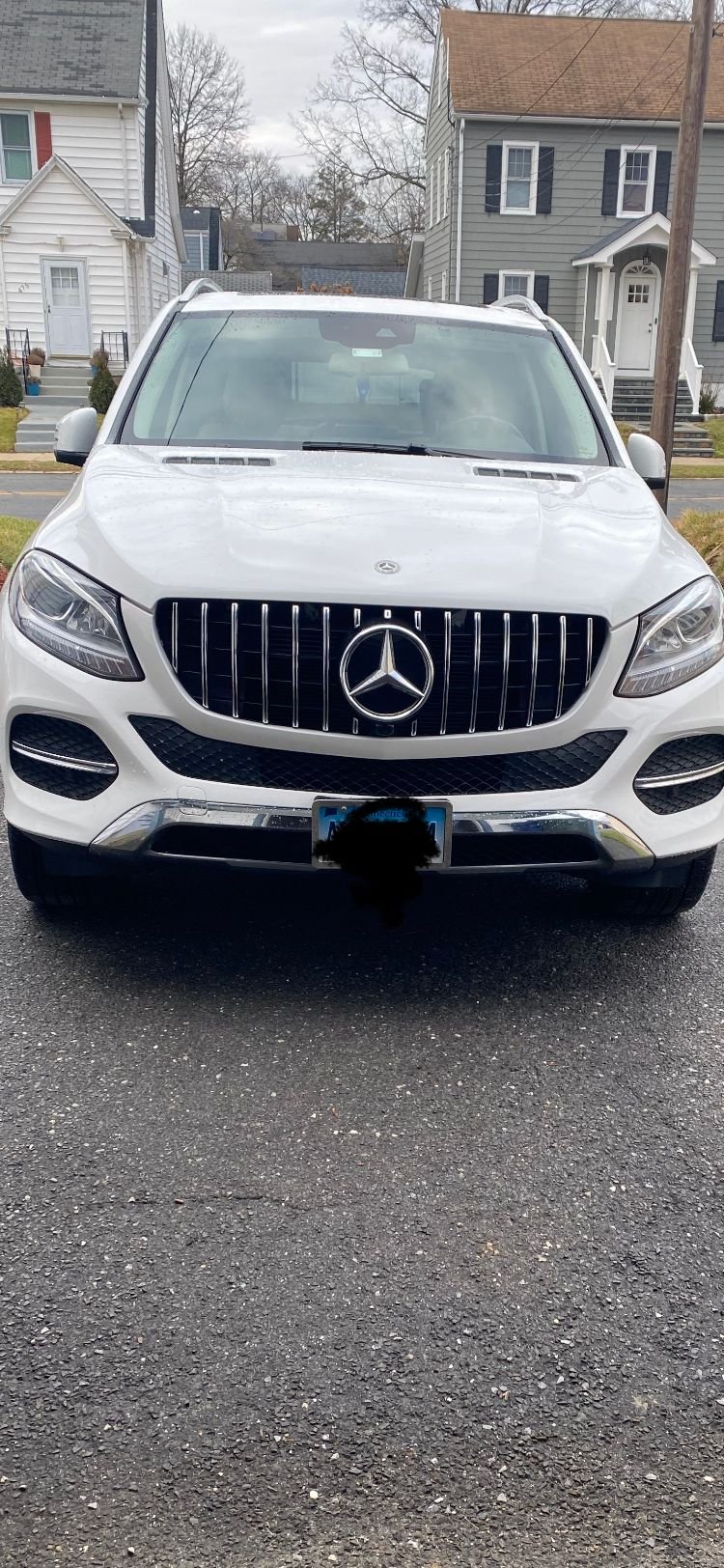

Whats up guys, my new panamericana grill just got delivered and was wondering if there was any way to install it without taking the front bumper off. If i have to take it off, anyway someone can send me a link to a video that they found helpful?

Easy to instal did not have to remove lower bumper like other videos …this one helpful took me 20 min…upper clips where the hardest part I used the same clip pry took the guy used in the video

Looks great. Where did you source the grill? Do you have a link you could share?

I don’t but there is slot for it in the bottom

Hey quick question....been wanting to change out the grill myself and have the same non amg bumper. Looks great! But are the grill slots chrome (looks like it but double checking). Also originally, I was thinking of changing the bumper and grill together but not now been trying to find someone that what you did, but also blacked out the chrome parts of the non-amg bumper. Looks like it's been a few years you posted this, any chance you blacked out the chrome and can share a pic?
