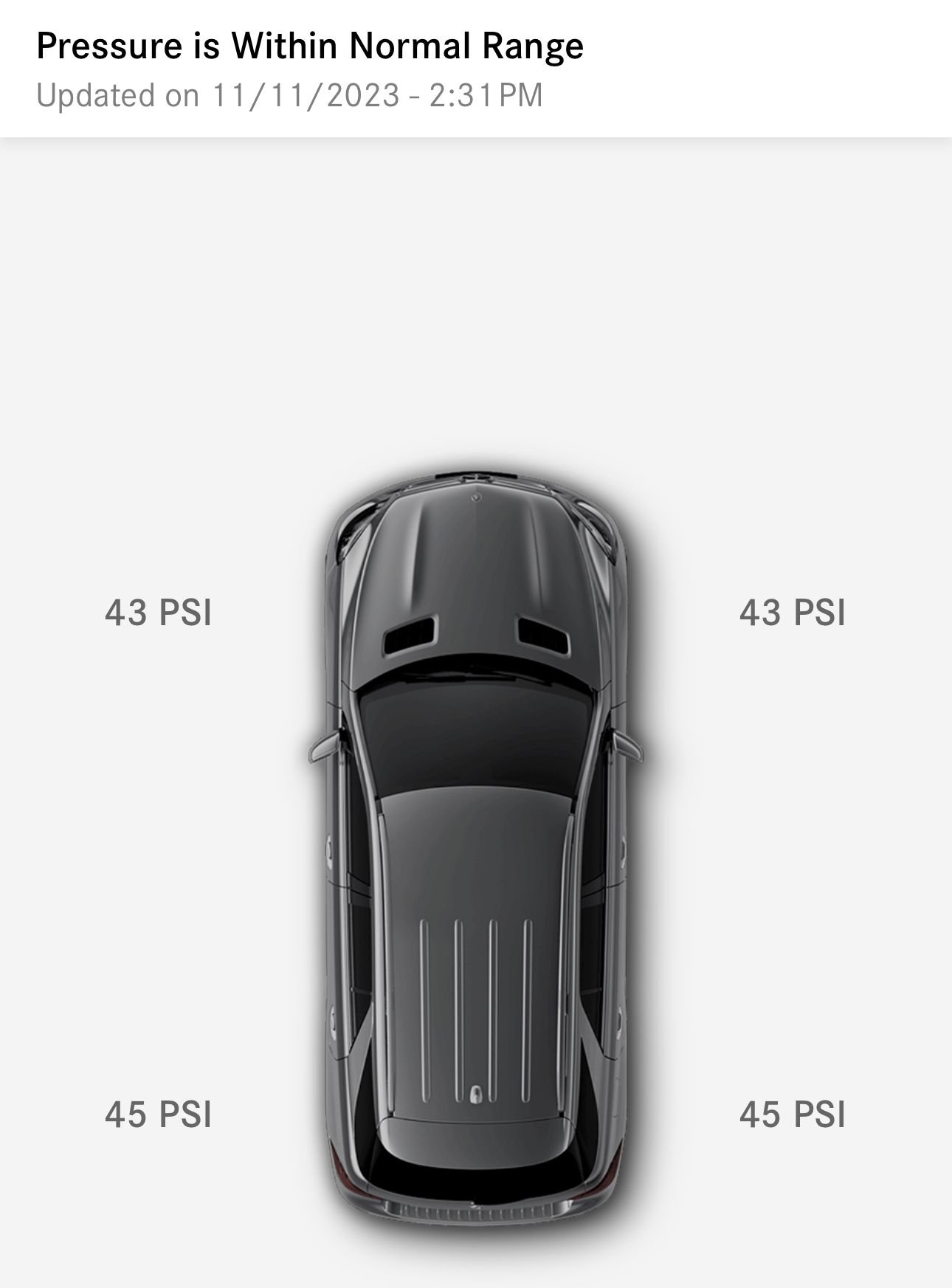

Why is the car complaining. This summer is happy at 40psi warm tire pressure.
Just reset the TPMS and carry on, should solve the issue.

I never ran such high tire pressure in my 2018 GLE350 with the 20”AMG wheel option. I think I need to drop the fronts to 41.
Yes, your second image is too high, make sure to measure the tire pressure when tires are cold though (cold tire pressure), you did the right thing to use the tire pressures on the fuel door and not where the door sill is.

I think cold at 39 and 41. I think that’s what the gar door temps are recommended to be. Hot temps would be 42 and 44.

As mentioned, you can reset it on the cluster, but reading the door label,
for loaded car you need 45-49 psi , so 39 alarm sounds about right.
