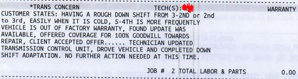

Not many 350s/450s that I've seen with such issue.... My first GL car was GL450 and I never had this issue, but I had similar issues with two my of my Mbenz with the 9G transmission coupled to the V8. read this thread below. it has the ultimate solution to your issue. Note as posted in my formal service notes (all posted and documented in the thread linked below to help others), Mbenz did that service at no charge to me all based on goodwill towards repar (I paid nothing, 100% free) even though car was out of warranty and I was 2nd owner. It's a well documented problem; reference the right TSB, and if you had the car since new, there is a good chance that a good SA will list that as factory defect (cause it is) especially if you find the right TSB for the GLE. Otherwise you might end up with a 100 or 200 USD for technicians time to the adaptation (car must be driven around while adaptation is conducted to be effective with one tech driving and other tech with PC in passenger seat, in other words WHILE DRIVING VEHICLE ON THE ROAD (this is important, this was exactly how it was done on my car), or alternatively in the shop on a standstill rotating wheels). Don't listen to any quick reset solutions that can be done in your garage or inside a 3rd party shop garage in 5-10 minutes. That will fix it for 100-500 miles only and u will continue to deal with same issue over and over again. Also, you need to Mbenz dealer to install the most recent transmission control unit update they have for your car (don't forget to mention that).
Full detail: https://mbworld.org/forums/gle-class...ml#post9055626

You're welcome, and glad to help!. Keep us posted. I did exactly that, and so many owners in that thread that I shared also did the same - they all reported success including me.
https://cimg6.ibsrv.net/gimg/www.mbw...e3417de0e2.png
Happy to hear they fixed it under goodwill.
