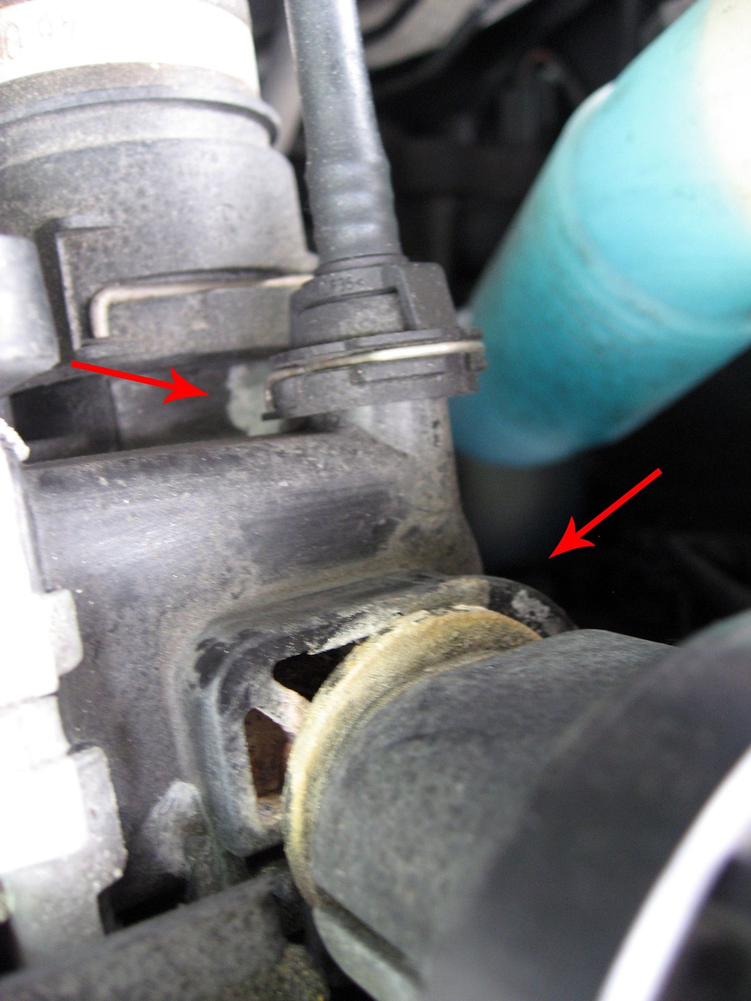

My SUV (it's actually an ML 350, but this should also be applicable to the 2016+ W166 GLE 350s with the M276 engine) is now 10 years old and is approaching 100,000 miles on the odometer. I have already addressed the very few weak points of this otherwise reliable (for us, at least) vehicle. The only common source of trouble in older and higher mileage W166 vehicles that we have not yet addressed is the cooling system, and I'd also like to perform a coolant replacement soon (has never been done yet...yes, I realize that Mercedes specifies 15-year intervals for this). Based on my understanding, the most common problem areas are: leaks from the plastic thermostat housing or the associated seals, leaks from the plastic water pump inlet flange or its seal, leaks from the radiator hoses at the connector ends (i.e., from corrosion at the metal end:
...and I also don't trust the plastic connector ends at the radiator), leaks from the plastic coolant expansion tank line or its connector ends, and leaks from the plastic fitting and the hose connector at the firewall going to the heater core/exchanger. I've also read of leaks developing at the upper corners of the radiators, but I'll just wait out that potential issue and keep an eye on it. There's also a plastic fitting going from the thermostat between the cylinder heads, but this is extremely uncommon on the naturally-aspirated M276 engines, I believe (I had the service coordinator at my shop, which has performed that particular repair and authored online videos about it, scan through their customer records, and they only encountered the problem on the turbo-charged variants, at the time...), so I am going to skip that (removing it is a tricky job if that plastic pipe/fitting hasn't already begun to crack apart, and it's an involved job nonetheless...). I'm also not too sure about replacing the water pump either, since I haven't heard from too many out there who have experienced failing/leaking water pumps on these yet. What sort of lifespan are owners getting out of these water pumps on the M276 (I realize that the pulley and housing cover inside on the engine side are plastic...and that pulley is a weak spot)? Has anyone had to replace his/her car's M276 engine's water pump already (I know that the plastic pulley is notorious for "walking out" from the M278 & M157 V8 engines' water pumps at 10+ years/100,000+ miles)?
So, I'm preparing to perform replacement of the thermostat and seals, plastic water pump inlet flange and seal, upper and lower radiator hoses and seals, plastic coolant lines, plastic fitting and hose at the firewall to the heater core/exchanger, and the coolant on my 2015 ML 350. I'm leaning towards replacing the water pump too. I was wondering whether to also replace the coolant expansion tank/reservoir while I was at it, since I have been reading on the W166 & X166 forums of owners experiencing plugged radiators and heater cores resulting from burst additive packs in recent years. On my old S211 E 500 (M113 engine), there was an additive pack in the expansion tank, which I replaced together with the radiator, old hoses, lines, water pump, thermostat, and coolant temperature sensor (all were the originals, and the transmission cooler lines were severely corroded...and the car was due for a coolant flush anyway, since the previous owner last had one performed over 13 years ago when he had his Mercedes repair shop replace the changeover/heater control valve). Is the additive pack found in the coolant expansion tank/reservoir (i.e., Mercedes-Benz part#: A 166-500-00-49)? What's interesting is that I noticed the W166/X166 coolant expansion tank/reservoir is pulled/NLA from the dealerships' and MB U.S.A. parts catalogs...which is unusual. Is a new revision/supersession of this part expected?

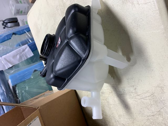

It's a priority, but I'm just not sure what part to get. Do I trust the remaining NOS/remainder stock Genuine Mercedes expansion tanks when some owners with 2018 MY GLEs/GLSes are already experiencing failures (admittedly, I don't have full data on the scale of the issue...only anecdotes/reports from owners on the MB & AMG GLE/GLS forums)?
In addition, I haven't heard any feedback from those who have installed aftermarket ones. I've listed a number of them below*...but there are also a bunch of off-brand Chinese ones in addition to those.
The latest from Mercedes-Benz's Parts Specialists is that there are zero of the Genuine Mercedes expansion tanks in stock at the dealerships, MB USA, or in Germany... According to them, they have not been discontinued entirely. Rather, they are actually on backorder and trying to re-stock them with new units (but perhaps with a new, superseded part #?), but there is no ETA yet. Latest prices for these were most recently $144 at MB USA and $160+ at my local dealership. It seems that Mercedes-Benz is being silent as to whether there are known issues being addressed in the forthcoming parts.
*Aftermarket W166/X166 Coolant Expansion Tanks (not listing all of the Chinese ones on eBay, Amazon, etc. such as Hamburg-Technic, SKP, etc.):

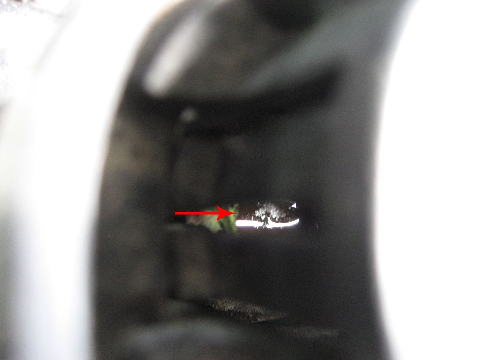

Well, it looks like I am also adding a radiator to the list. Just ordered a Nissens radiator while it's still reasonable (165 USD). Like I mentioned last year, the radiator "might be a matter of when and not if it will fail."
Close-up image shows that coolant is starting to seep out of a seam in the upper left-hand corner of the radiator just below the mount bracket...
