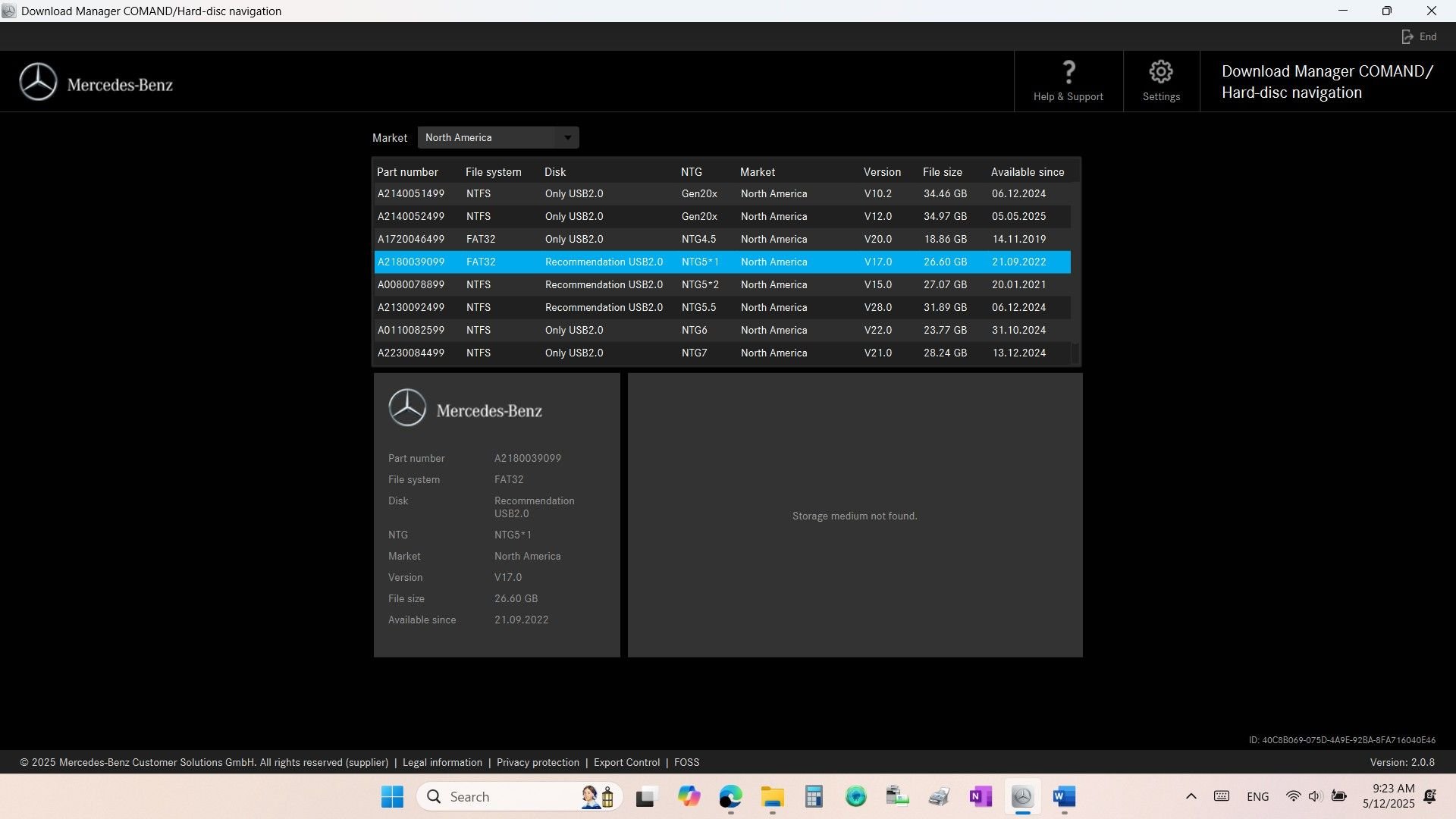

1st, download the Download_Manager_COMAND_Hard-disc_navigation
2nd, put in a usb in pc and formatted as screen shows.
3rd, Patiently and wait for download to be finished. (It depends on your internet it may take 30-60mins)
4th, Put your usb in front car usb console.
5th, either have car running or have a battery maintainer it will take 30-mins to 60mins.
6th put in a map pin and wait for installation to be finished.

Can someone provide me the Map Pin for my vehicle? Thanks
Part Number: a2180039099 Ntg5.1 V17 Vin: 4JGDA5HB0GA806938

Your Activation Code is H2UR7I

It took me appx 45 mins to install it. Thanks.
