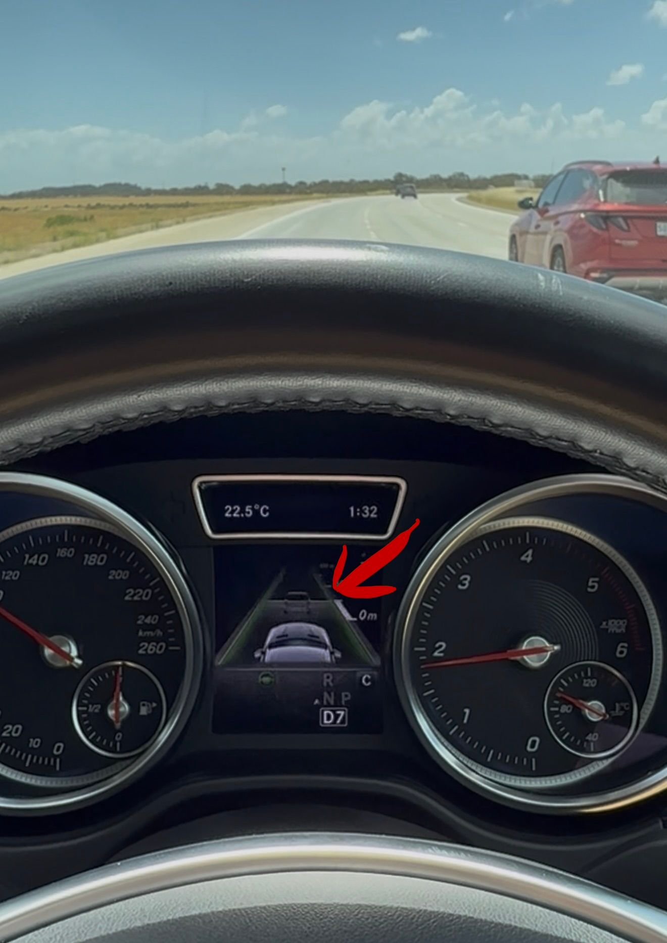

I need some help to figure out why this is happening. It thinks I have a car directly in front and brakes automatically for a split second until I pass it. Only happens in LEFT an RIGHT 45 degrees.

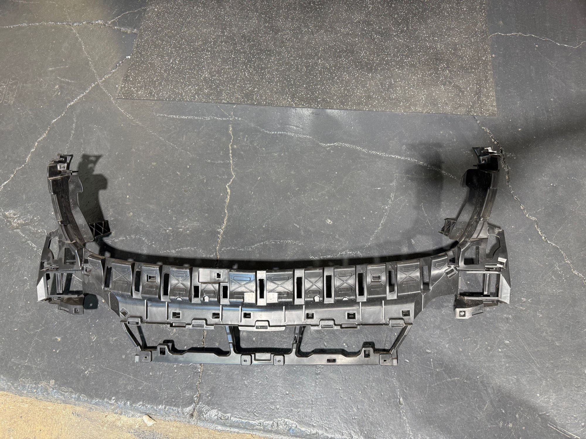

Problem SOLVED!
I had to take off the front bumper and install the original bumper central bracket. The issue was that the aftermarket bracket was slightly narrower and lower in terms of radar placement. And the other issue is that the radars were mounted upside down... this is how the aftermarket bracket was made
Anyways, have a look at the photos, the GREEN is the original placement. RED is the problematic placement of the aftermarket bracket.
Aftermarket Bracket
Aftermarket Bracket
Placement of the radars. RED aftermarket. GREEN original working placement
Placement of the radars. RED aftermarket. GREEN original working placement. Brackets are one on top of the other to see differences.
Orignal placement.
Orignal placement.
