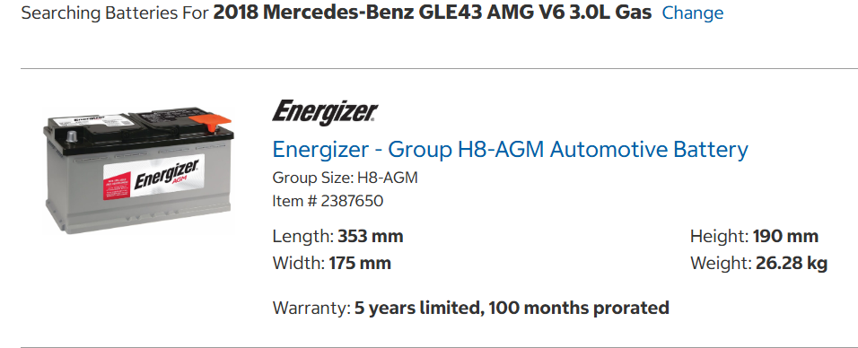

I said no and thank you. Off I go, I drove another Winter. I decided to replace the main battery in Apr 2025 -- 7 years is a good run. I got the Energizer battery from Costco for $430, made in German. By Aug 2025, the ECO is not working again. No error message and the ECO led is lid green all the time, just not working. By Dec 2025, the dash cam and radio works for about 10-15 minutes before turning off to safe the battery. In Jan 2026, it was hard to start and needed to press a few times when temperature dropped below -25C/-13F -- parked out side, daily drive 16km/10miles, and weekend 50km/30miles.

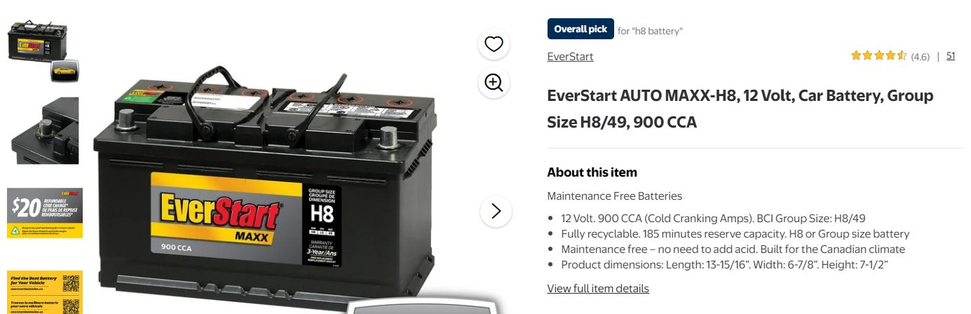

In Jan 2026, I got a Youcanic scanner over $1K (>$150 for tariffs, Ouch!). Scanned and cleared a few times, still got B21059A error code and the 39A charged resistance for the main battery. Still no change and ECO is still not working after replacing Aux battery with LiFePO4 12v8Ah. In Mar 2026, I decided to replace main battery -- EverStart from Walmart, made in Austria, $230. Scanned and cleared, the battery resistance came down to 9A, error code B21059A is gone and ECO is working for now. The time will tell.
