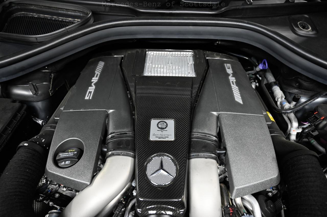

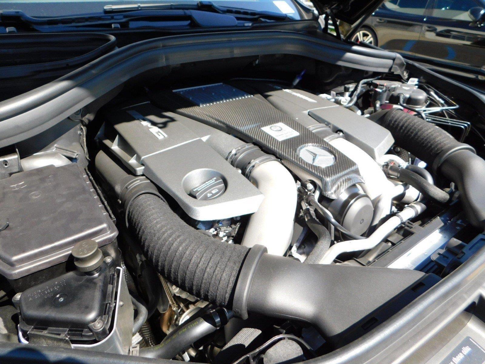

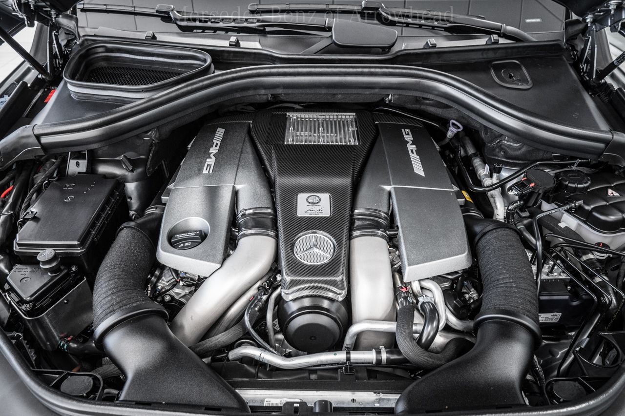

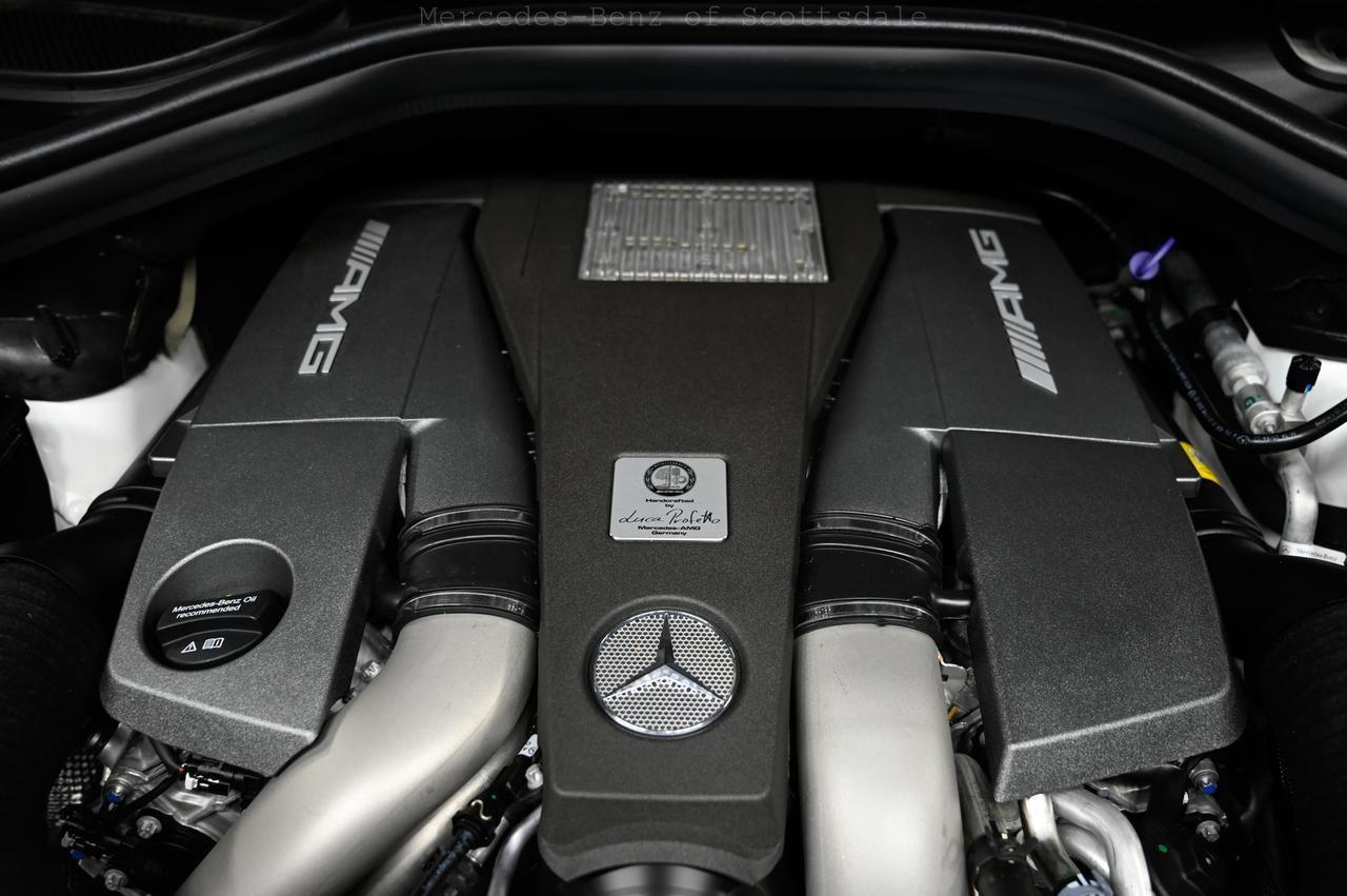

The 157 engine pictured in pdf attached in post #2 does NOT correspond to 157 engines(at least in the US). Look closely where the dipstick is depicted - front of engine passenger side (remember US cars are left hand drive), marked #4 and #5. Maybe in such 157 engine as depicted all of the oil is not possible to extract.
However, look at the actual pictures of 157 engine from US GLE63s - dipstick is at the back of the engine on driver's side by the firewall. Like I said before, I extracted all 8.5L when changed the oil via the top in my ML63.

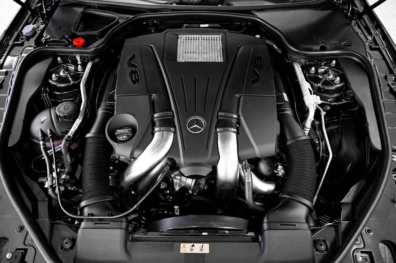

For even more confusion, look where dipstick is depicted for 4.6L V8 TT:
https://f01.justanswer.com/eurotec/1...ter_change.pdf
Now take a look where it actually is:
https://cimg0.ibsrv.net/gimg/www.mbw...da1cbd964.jpeg

ThreeMB's - you are spot on re the dipstick location too, it is definitely at the back right corner of my engine, so the manual/photos i was looking at don't match up to my engine but i didn't really pay attention to it..
