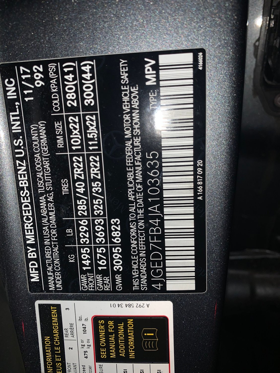

1. Please post your VIN. This allows someone to post the correct procedure.

I have attached a pic of the VIN as requested so hopefully someone can give me some tips on setting the transmission level procedure. the filter change should be straight forward just need help on how to set the fluid level. from what i understand i need to pump in fluid then get the trans to a certain tremp and recheck for overflow. but detailed info would be great! (i will attach a pic of the car when it's not dark outside for reference)
