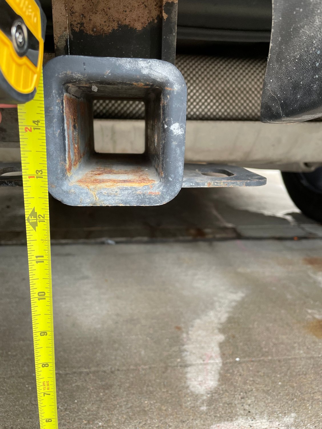

Huge favor to ask... Can someone with a stock ride height GLE63S (2018 class) check the height of the trailer hitch from the ground? I'm on a trip away from my car for a week, and need to pick up the boat as soon as I get home, so I want to have the hitch waiting for me, otherwise I'd just measure myself. I just bought a boat and will be towing it with my 2018, and since this is the first time I'll be setting up a vehicle for towing, I'm getting a little obsessive over making sure the trailer is level. I know a couple inches of height difference barely changes the degree rise over the length of a single axle trailer, but I'd rather be closer than not.

Here is the 2017 coupe’s height.

Thanks very much! Looks like I'll need a 1-inch rise, which seems about impossible to find of course, especially with the 7.5" maximum from receiver pin to ball...
