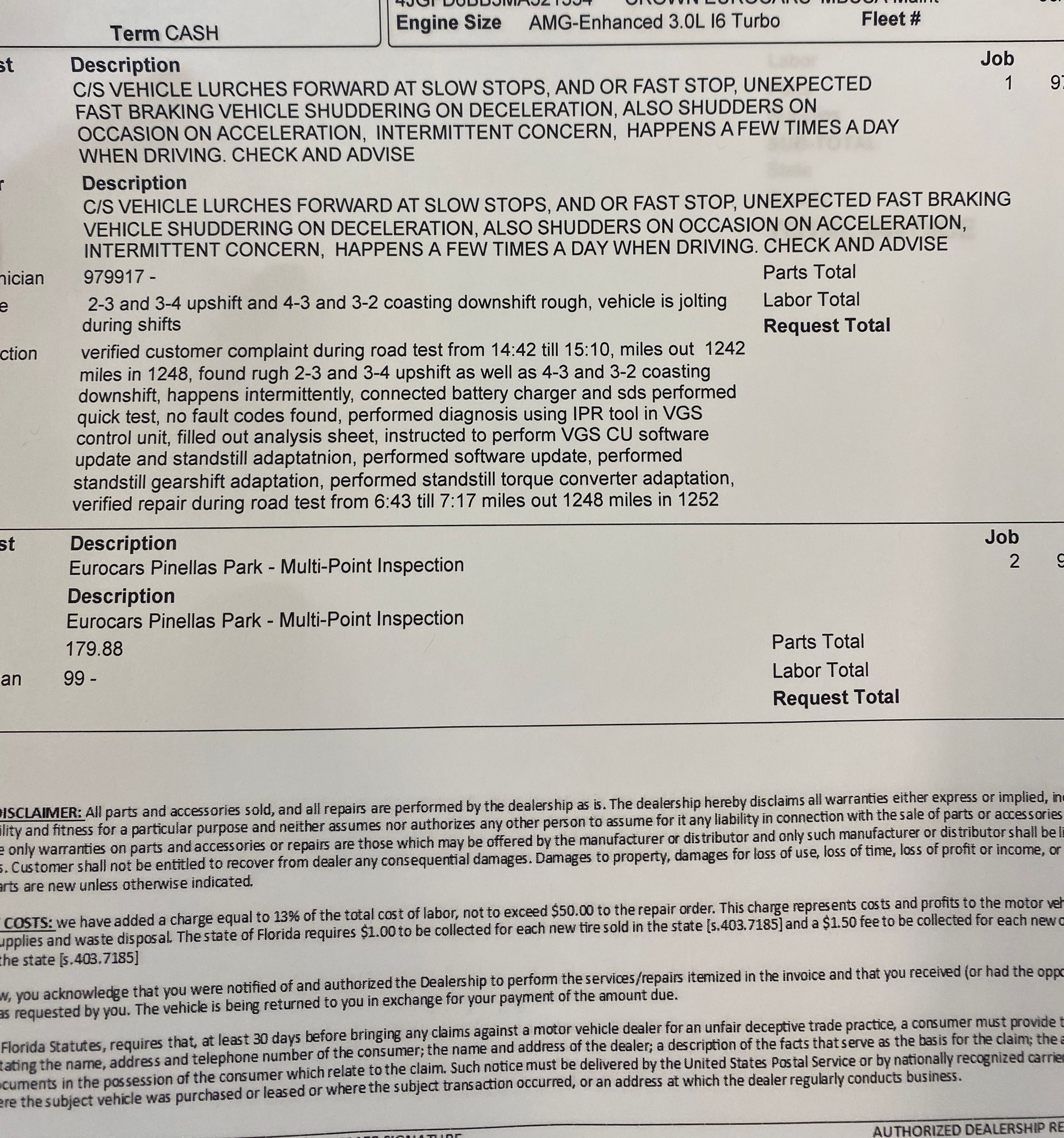

I had been having the same issues with thuds or very not smooth shifting between gears. This is what they did. So far I've only noticed one weird downshift since but it otherwise seems to be better. I'll keep you guys posted if the issue returns.
thank you for sharing your info. Will definitely show it to my service advisor. FYI, prior to this, my service advisor mentioned perhaps the software is outdated, not too sure this maybe the solution.
this abnormal jerk and only happened and produce a loud noise when I decelerated the car, it’s seem like the car is finding it hard to decide to change to which lower gear…
I am shocked this could happen to such a new car.

Right after this service, I got a software update which I installed. Not sure if that was a good idea or a bad one - we will see how it operates from here forward.
I see. Please keep us posted if situation get better for you after the service/ the software update.
