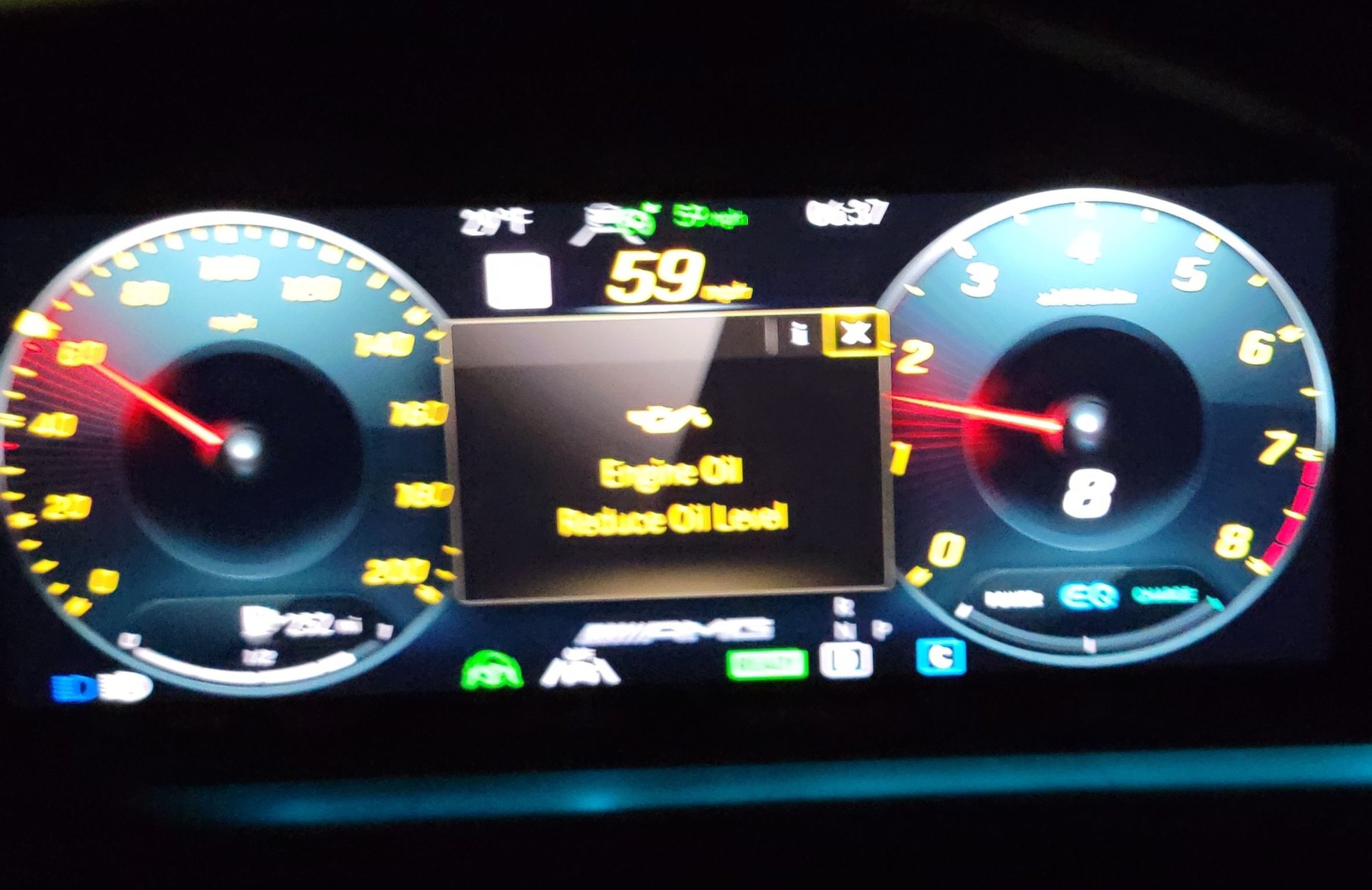

I just did my first oil and filter change on my 2021 GLE63S.
Thank God there are no more plastic oil pans or plugs on this engine, although the filter housing is the same plastic as before.
Service Manual had no indication of oil capacity at time of printing, and I couldn't find any updates.
A little weird not having a dipstick to check level, and the level indicator in the display seems to have a mind of its own. Sometimes it shows half a quart low, sometimes full.
Close to 10 quarts came out, so I just put the same back in.

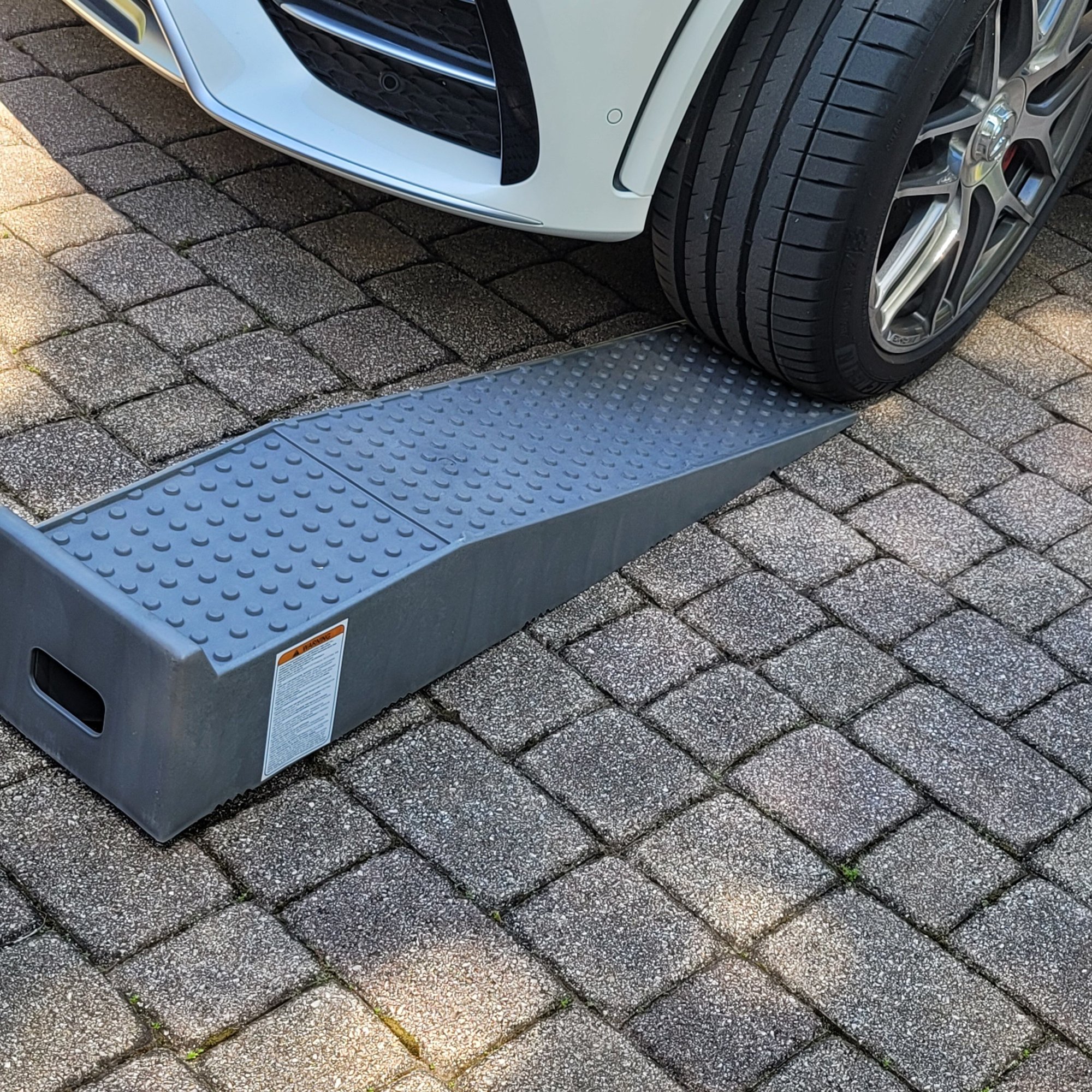

Ramps arrived to make the OC easier for me. Under 2k on the odo, will likely drain it soon before 3k and try out the ramps and the whole bottom wind plate r&r process etc - got the filters and oem drain screws from fp euro already waiting. Originally Posted by jaxslk

Do you use rear axle ramps also? How do you drain the oil with the vehicle level? Or is that not a concern?
I am not sure yet if the drain plug/ plastic screw/bolt is in the rear of the pan or not. First time underneath with all the bottom cladding removed will tell me this. If someone knows already, please tell us.
If it is near the back of the pan, the small 6.6inch lift from the ramps really does not bother me - should get the oil out just fine. If the drain bolt is not in an ideal place and a more level position would be better for getting best drainage, I can simply back the car into my driveway (it is on a slope upwards to the garage) and then when I drive towards the street and up on the ramps, the front end will be level with the back of the car. I am not using rear ramps. I do have wheel chocks for the rears. I will try to take some pics in a few weeks when I do the change and report back.

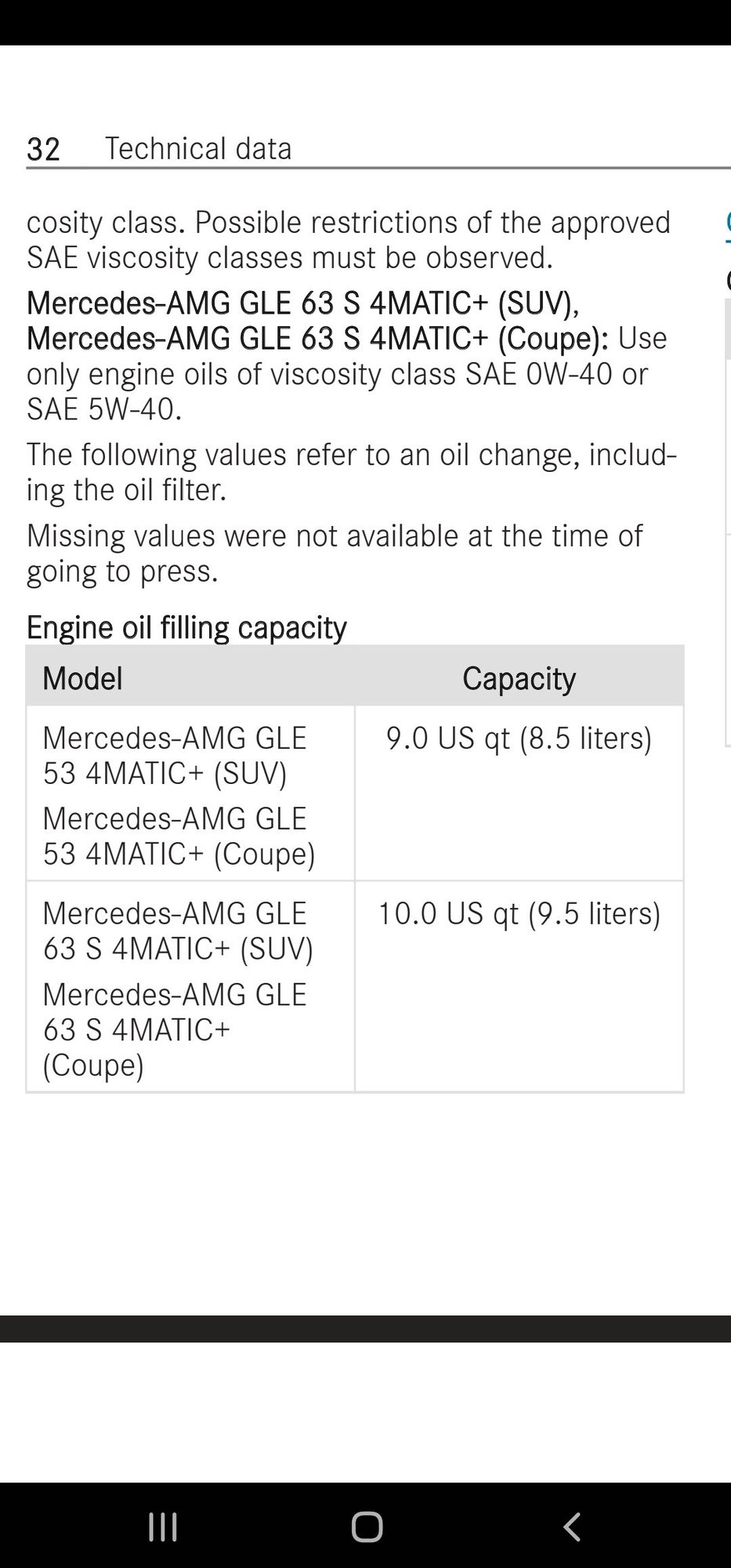

Pretty sure it’s 10qt on the 63 engine.

My 2021 GLE63S was delivered from the dealer as a CPO with 5,100 miles and the oil almost 1 qt too high! Their tech had changed it as part of the certification process. I found out when the warning dialog box came up just a mile after starting out on my first drive. The manual(s) do not state how much oil to put in after a filter replacement & drain.Originally Posted by Vyper340vb
Pretty sure it’s 10qt on the 63 engine.Like to see the link for the rear brake procedure.
I would suggest adding 8.5 qts then check the level after running the engine a couple minutes.

From my MY2022 AMG manual, but iirc the 63s engine is pretty much identical from 21 to 22.
