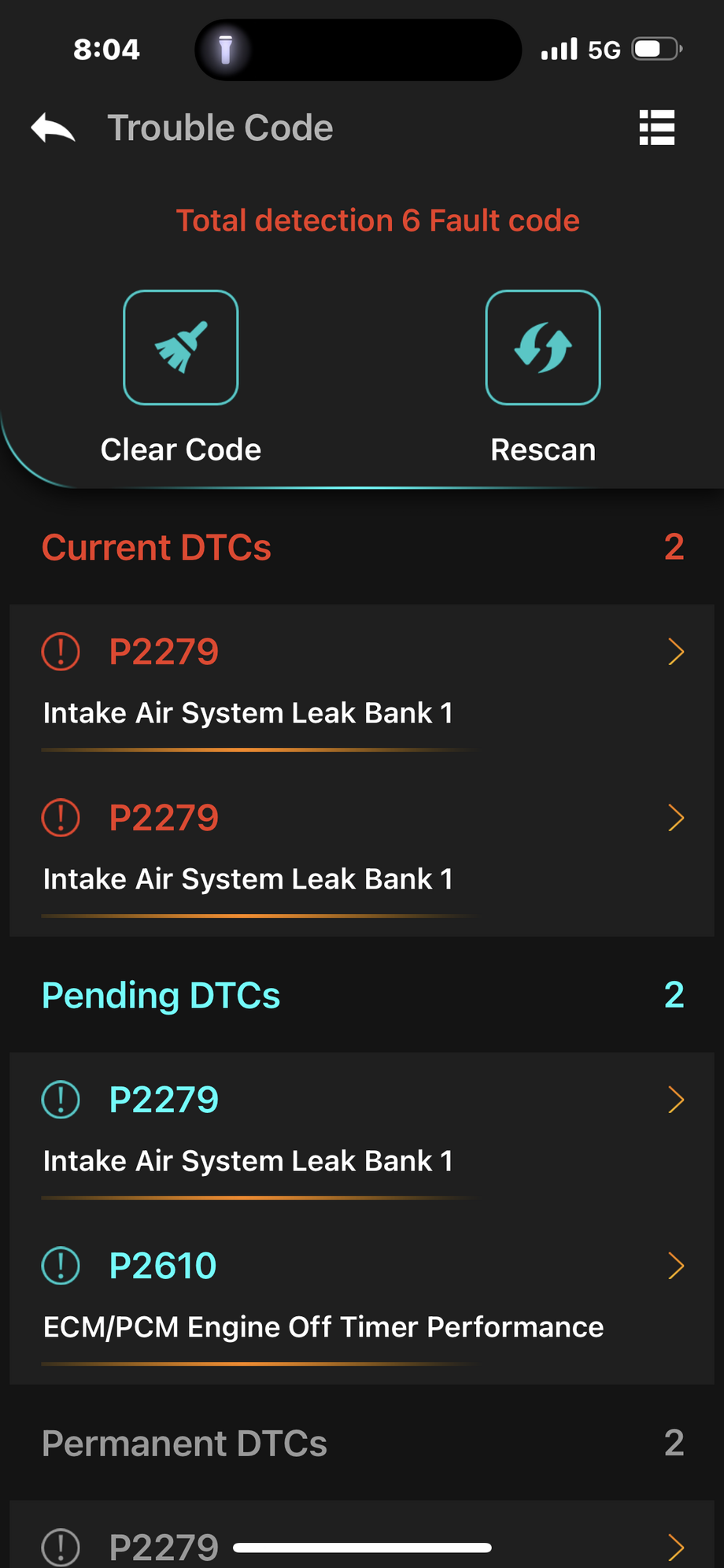

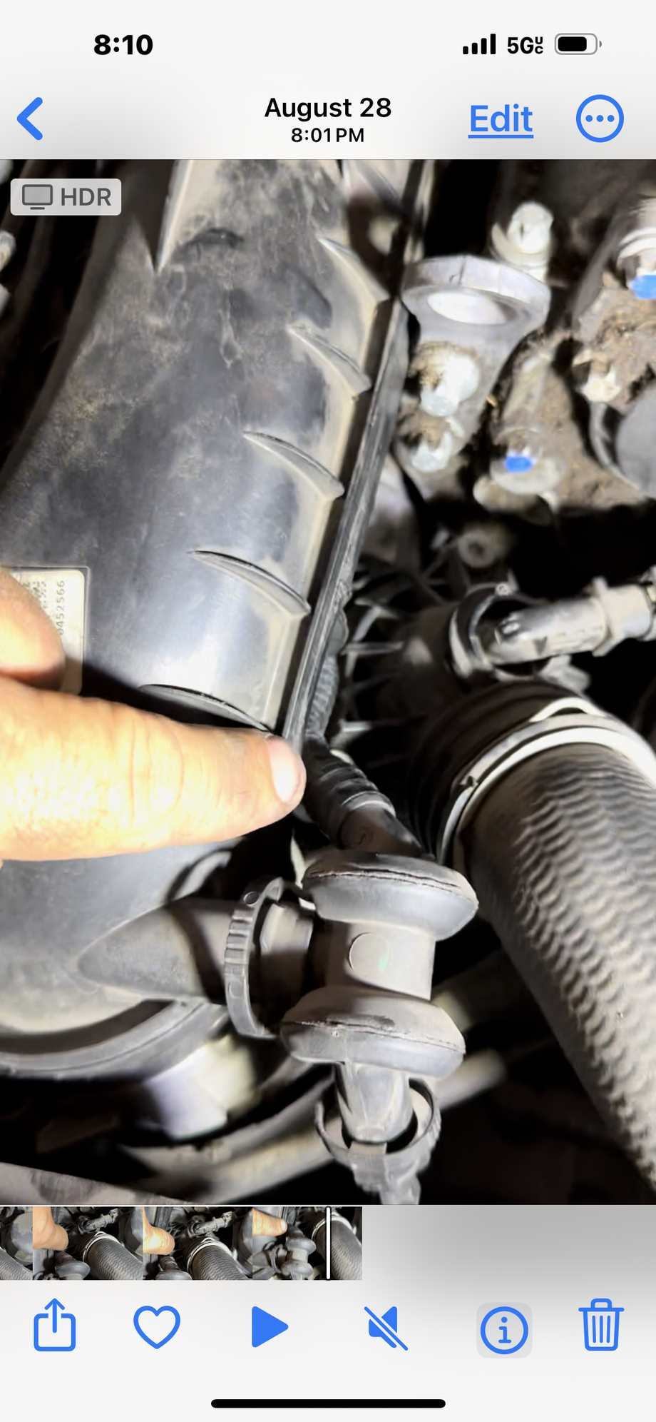

I’ve tracked down a vacuum leak to this hose attached to the intake manifold. I can’t find any diagrams or hose parts info. Any idea what the T fitting is and the hose that goes under the manifold?

Likely PCV. The centrifuge (vapor separator, catch can) is at the back of the right (passenger side LHD) cylinder head against the dash/firewall.

Where you got your pen test light. Mine was just about 3 inches down on the hose from your test light. Discovered it the vacuum leak the other day. My only concern is the hose run under the intake manifold and I'm not sure if I need to remove the intake manifold to gain access.
if anyone looking for the part number it's 276-018-23-00 Crankcase Breather Vent Line.
