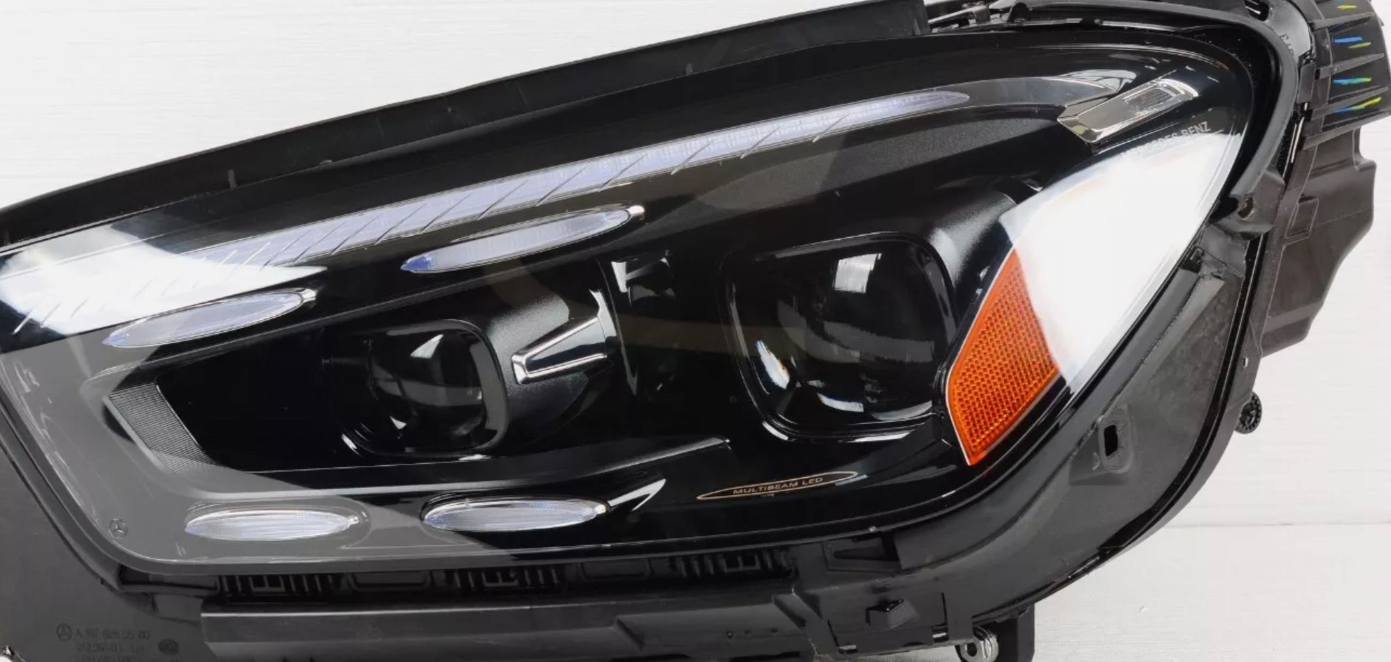

So your lights don't say "LED high performance" at the bottom similar to Pic 2 of this listing (you have to zoom in):
https://www.ebay.com/itm/19664523581...0AAOSw86hm6bPW
While your wagon should say "multibeam LED."

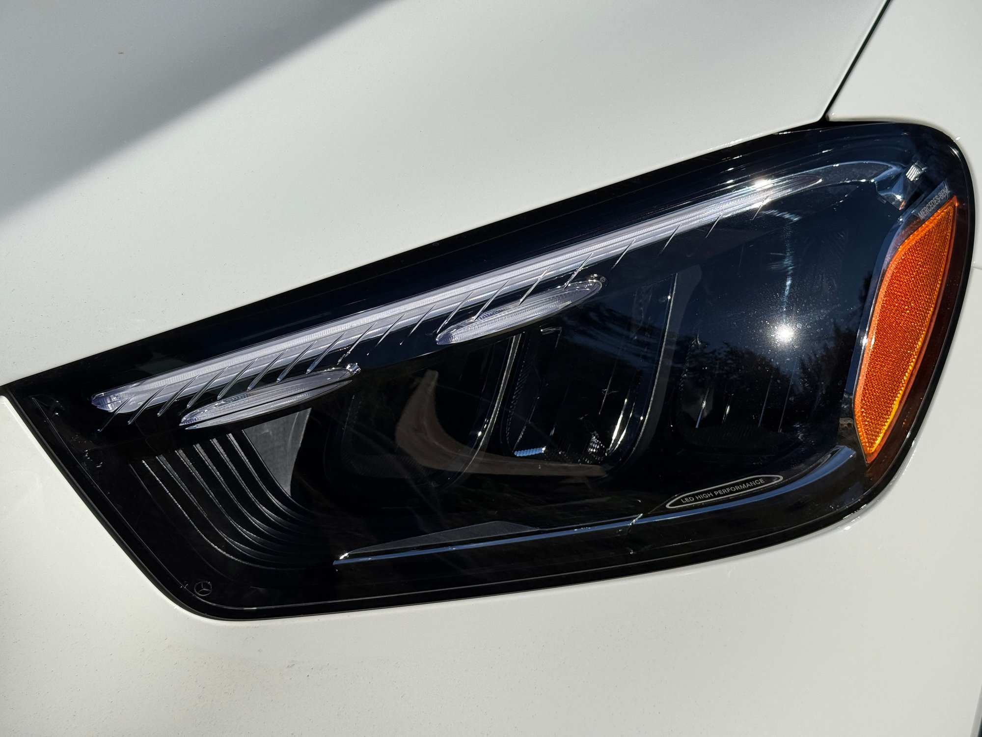

I need to clarify. Yesterday was the first time I took the GLE out for a long night drive (returning back after a trip), since that original night drive well over a month back.
Taken in isolation, the LED reflector headlights of the GLE are not bad at all. Illuminates roads pretty well, except that in curves it does not swivel. It is only in comparison to the All-Terrain's lights that it falls short.
So as long as the All-Terrain is not in the mix to compare against, the reflector LEDs of the GLE are decent lights. Either way, they are being replaced shortly.
The below are the actual lights in my car (I need to take some head-on pictures, but this should also show what they are):
Reflector LEDs that are now standard on the GLEs

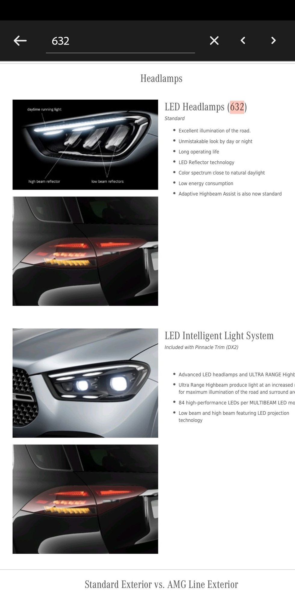

"LED Headlamps (632)" in the links above, is the one I am talking about.

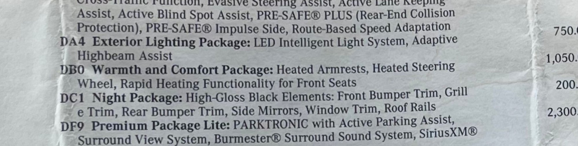

The following is the 2022 E450 All-Terrain's headlights (LED Intelligent light system) and further below is a crop from the All-Terrain's window sticker:
All-Terrain's Headlights
Crop of a picture of the All-Terrain's window sticker

From the MBUSA website, this seems to be the one I ordered:

That's good. The Multi-LED upgraded lights have the 4 hash marks in the DRLs while the standard lights only have two hash marks. You should consider getting ILS+ coded onto your AT, it's a very worthy upgrade if you predominantly drive in areas with very little street lighting.
