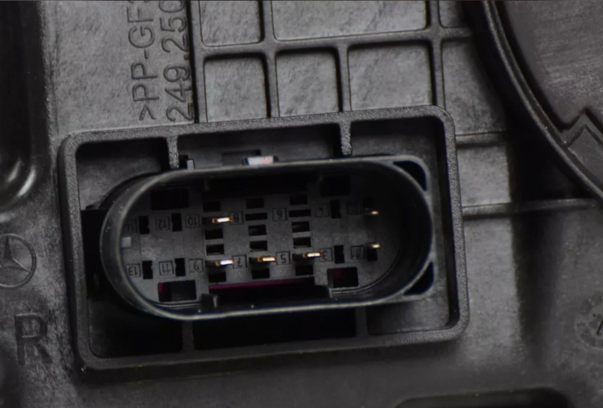

Got clarification today, on why the projectors are not turning on. The connector of the High Performance LEDs that came on my car has 4 pins, while the Multi-beam LEDs have 6 pins.
So it physically will not connect, without re-wiring. And re-wiring will of course void the warranty. My GLE450 is still very new, and hence I will just have to put the original lights back on. The High Performance LEDs are not terrible lights (comparable to the LEDs on say a Honda Passport or Pilot etc., but certainly not equivalent to say an Acura MDX), just that the Multi-beams are a class apart, in terms of performance.
So the new lights will need to go back to the eBay seller. Bummer !

High Performance LED's connector (4 pins)
MultiBeam LED's Connector (6 pins)

I have a feeling that the plug below, from the 2024 lights, have a different pin-set (six pins in the picture below, in pin positions 9, 10, 7, 5, 1 & 2 - connected to the wiring of the underlying lighting system) from what is present in the 2021 and prior lights. The plug I assume is embedded within the module itself.
Your version of the plug, from 2021, might have a pin missing, if I were to guess. That missing pin, in turn links up to the wiring for the missing bottom hash lights. It should be easy to check, by popping the hood/bonnet and disconnecting your light’s plug, and check if your car’s plug’s pin-set, matches the picture below. To do this, you will not have to take off the bumper cover and would just have to reach in and unplug.

It seems to me that the plug is perfectly compatible with the headlight. I have all 6 pins. I am attaching a picture.

Yes, the plug does look to be fully compatible. I would reach out to Max from @EleBest and troubleshoot the problem. He and his team are absolute masters at this.
