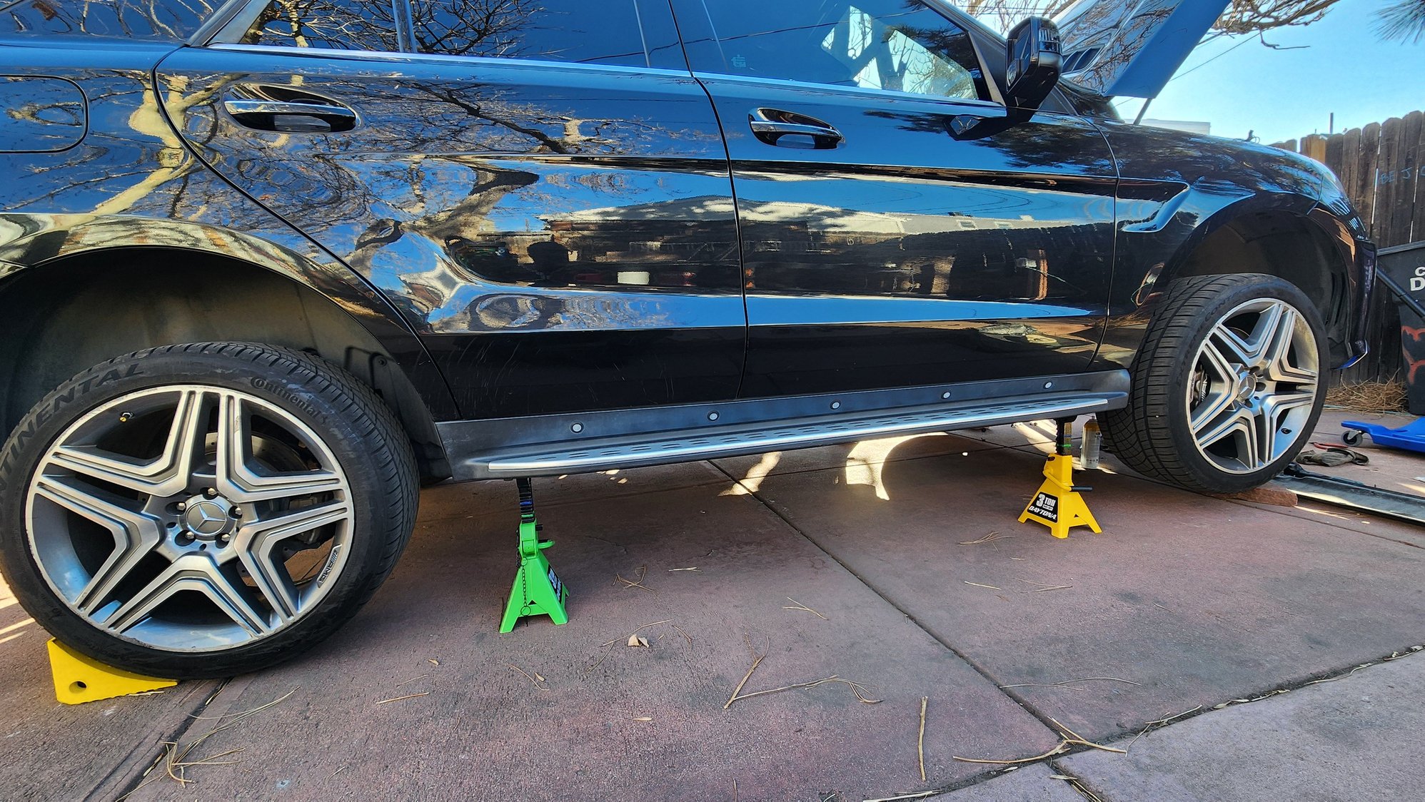

Originally Posted by coachhomer
This is what I see. And I was always told never to lift from either of the differentials.
i lifted mine as mercedes image describes. fairly straightforward.
Thank you for sharing actual images of the vehicle and that guiding image.

This is perfect! Thank you. Although I must have missed this…
