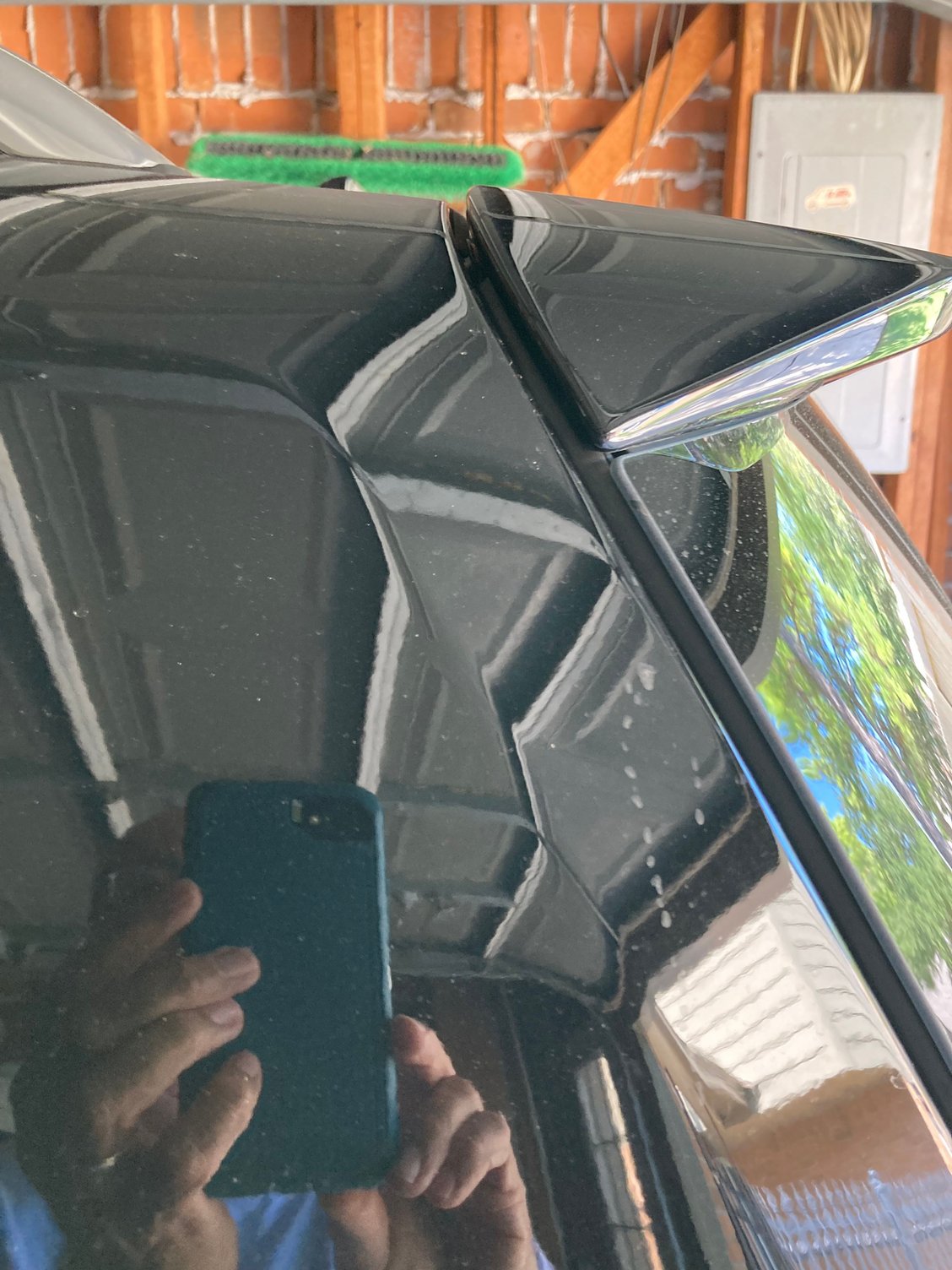

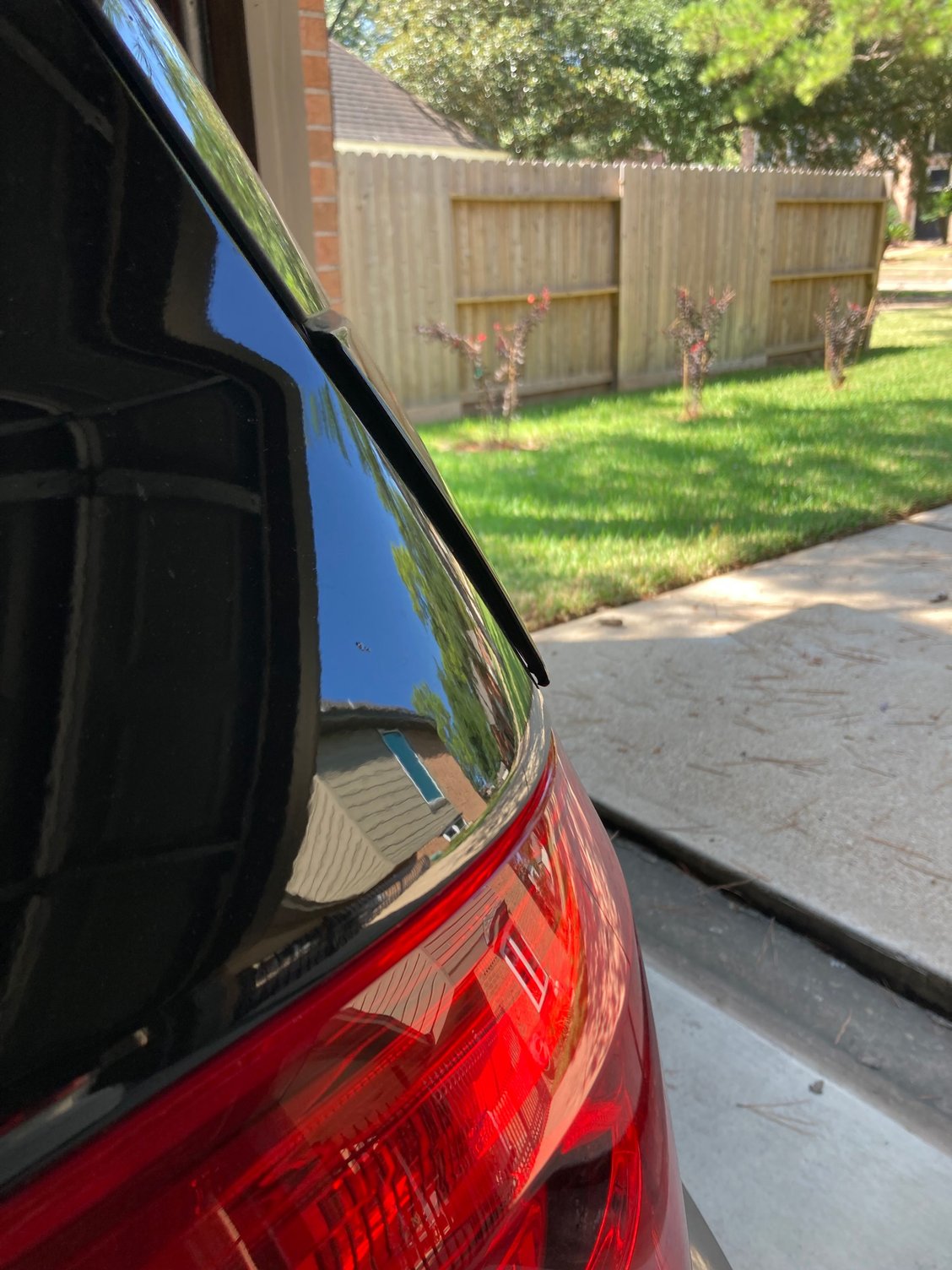

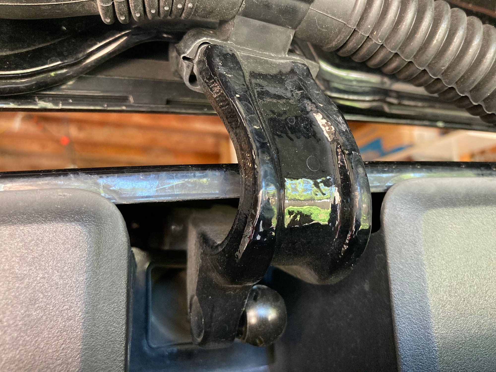

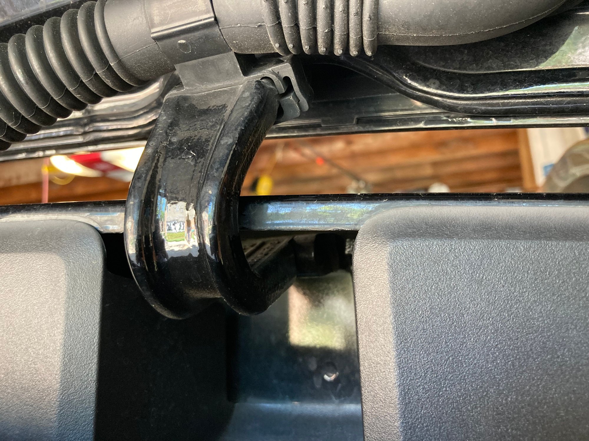

Small gap between body and lift gate
Right hinge
Left hinge
Note small dent on right edge of lift gate.

I'm certainly not suggesting the issue, just providing a real world example. Each situation is different, even though there might be similarities.
It's very possible that the bottom "lip" of the gate is bent in a manner so that it "pushes out" slightly when contacting the surface of the lower cabin
This might be an odd request, but photos will help put it into perspective. "what's bent" (you think), or any other possibilities.
EDIT: hilarious, you posted photos at the same time I suggested it

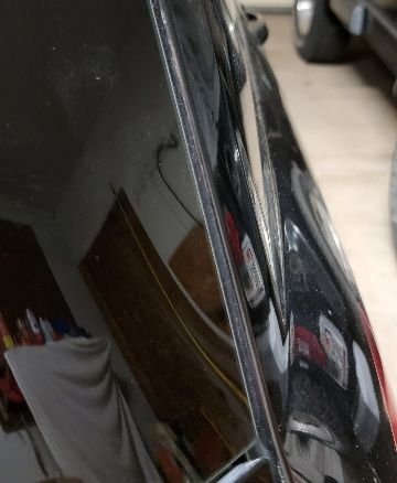

Hmmm - to me, it looks like a slight misalignment of something. Even an insignificant amount of movement of a hinge, will make a big difference on tailgate alignment.
My photos (outdoor with daylight would make better photos, but 9pm and in garage) :
Closed.
closed, upper foil
right hinge
left hinge
gate up

After looking at your photos, I agree a misalignment has happened. The upper foil comparison was the most obvious. Mine looks like it’s pushed above the roof line. Hence, it appears the cause may be bent hinges. If the force was strong enough to bend the bottom metal lip of the liftgate, it may have been enough to warp hinges. Thanks much for the response.
Has anyone replaced hinges?
