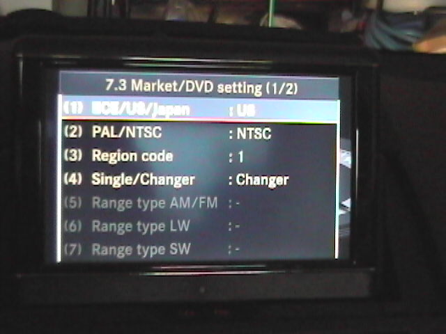

Old Apr 23, 2011 | 04:36 AM
n5160u's Avatar
Joined: Apr 2004
Posts: 70
From: S.F. Bay Area
E320 CDi 2k SLK230 Designo 04 SLK 320 Final Edition 2010 GLK350 06 VW Beetle TDi 2012 Plug In Prius
In Europe the channel spacing of the radio frequencies is different so a radio set up for USA cannot tune to the exact frequency used in Europe. This was never a problem before digital tuners became common. It is a small software change to alter the channel spacing on a MB radio.
The ILS system which is the European version of the USA Lighting Package has LED turn signals in the rear but they are yellow colored instead of the red color in North America. Since both colors are legal in the USA I don't know why all newer vehicles sold with LED rear signaling devices in the USA are restricted to red LED lighting. Conventional rear signaling with yellow light bulbs is still allowed and being used in USA.
Since European video standards are very different from USA you need to change the video system from NTSC to PAL to view European DVD content. this change does not affect your region code settings or count.
There is a "secret menu" to gain access to this USA/EU update feature on every modern radio but the method of getting into the menu changes with each model.
This also changes the nav system to accept European maps.
WARNING!
Use this at your own risk!
Do not try to access or change menu items you don't understand or are not equipped with. If you try to change an item in a module you do not have installed you risk sending the system searching into an endless loop trying to find or change a module that it will never find.
This can turn your head unit into a fishing weight.
Access engeneering menu via this key combination: "Hang up button + # + 1"
Change the Region to ECE (2)
Find the exit to the Engineering mode on page 2 and select it.
Turn the car off for 5 minutes to allow Command time to update all of the connected modules.
Turn the car on, and scan the radio dial, the US setting will only scan odd decimals (i.e. 100.1), EU setting will scan all decimals (i.e. 100.0). If your radio is scanning all decimals, the update has taken effect, if not turn the car off and continue to wait for the settings to finish applying.
- If you get message about wrong software version, go to MB dealer and ask them to update your Comand software first.
* After that check at the Engineering menu if the region was set to ECE
* If it wasn't, then change it first
* Finally insert NTG4 navigation map and start the update

Old Apr 24, 2011 | 01:47 PM
jason8612's Avatar
Posts: 29
glk350
I will give it a try when I get back from vacation. I don't have dvd nav in my glk.
Old May 13, 2011 | 07:50 AM
jason8612's Avatar
Posts: 29
glk350
Does not work on my car. I don't have dvd nav system, just the standard mp3 cd system with a small screen
I can get into engineering mode but all I have is
System
Radio
Swdl
Tel
Emc measure
Sound
And under radio there is FM and the options are clr and amplifier on. Nothing to change regions
