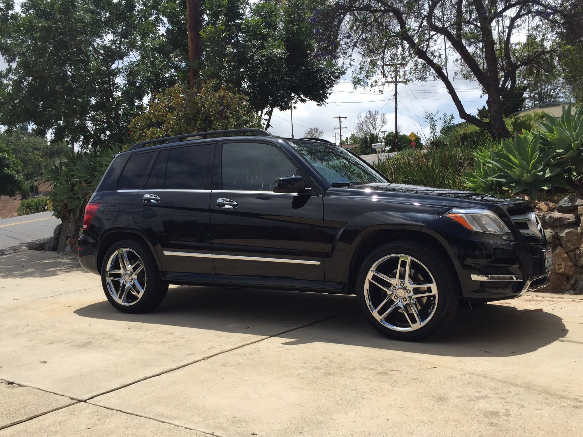

At shop
Home.
Old May 16, 2015 | 08:10 PM
Diabolis's Avatar
Joined: Jan 2013
Posts: 3,745
Likes: 811
From: The Great White North
W204 C63 Coupe, W166 ML350 BlueTEC, 928GT, Taycan GTS Sport Turismo, C5 Z06 & IS300 race cars
Very nice! Never realized just how nice the OEMs can look chromed if you already have all the chrome trim on the car.
