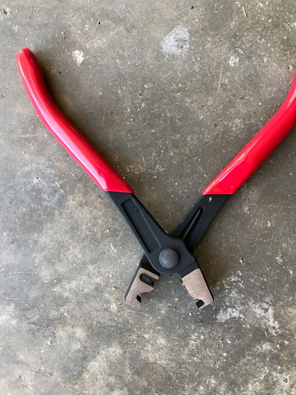

-If you want to use Clic Clamps, youre going to need a clic plier. Other wise i the standard ring clamps just use a flat head screw driver.

Remove clic clamps by using clic pliers or flat head screw driver. For flat head driver, just need to pop up it up. For clic pliers, use the correct side of it (one way does one thing, the other does the other)

Step 7: using the correct side of the clic pliers tighten the clamp or tighten the ring hose with flat head screw driver, also reinsert the 5 pin power cord.

Those pliers are pretty neat. I just used standard channel locks, but I'll have to get those on the next go-around.
yea they werent really worth it in my opinion, standard hose clamps from walmart work just fine
