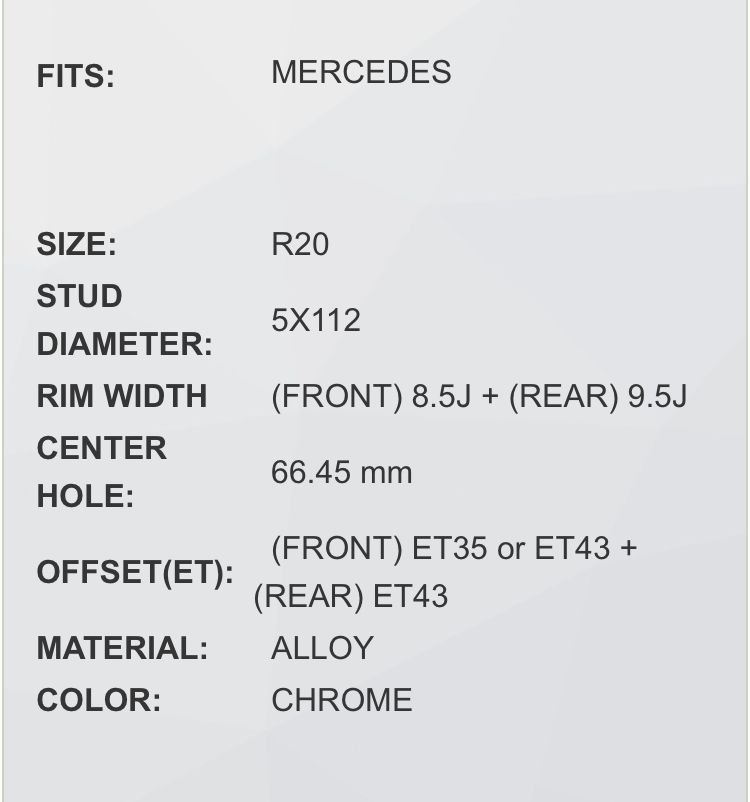

i’m doing the same thing you are 8.5 on the front 9.5 on the back I need to know what tire size you got and how’s it doing? I’m hoping you’re still there and I hope you still have it.?

i’m doing the same thing you are 8.5 on the front 9.5 on the back ( S class Wheels ) I need to know what tire size you got and how’s it doing? I’m hoping you’re still there and I hope you still have it.? How do these look and specs?? TPETE! hOPE YOUR still on here AND Rolltide????? And if im posting this right....So super Depressed so getting some wheels.... Im doing the same thing. So im getting S-class Wheels the front are 20x 8.5 wide and back are 9.5........ I lowered it with H&R springs i think like 1.2 inch.......... PLEASE HELP! So what kind size tires do I need to get size etc?????? Here is wheels im getting......... hub bor should be 66.6? maybe typo ??

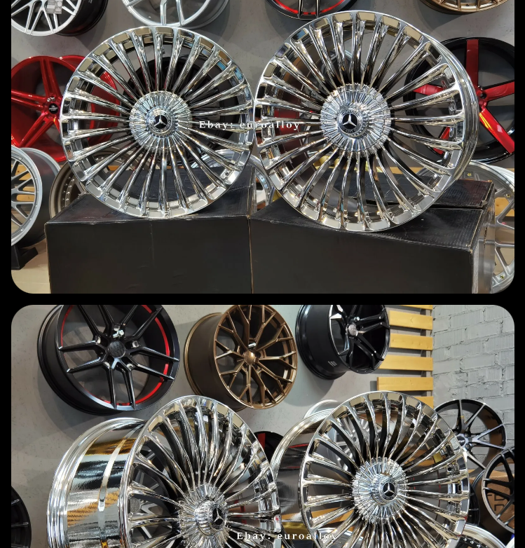

TPETE! hOPE YOUR still on here AND Rolltide????? And im posting this right....So super Depressed so getting some wheels.... Im doing the same thing. So im getting S-class Wheels the front are 20x 8.5 wide and back are 9.5........ I lowered it with H&R springs i think like 1.2 inch.......... PLEASE HELP! So what kind size tires do I need to get size etc?????? Here is wheels im getting......... hub bor should be 66.6? maybe typo ??
wheels S-class

tawatts! Holy ****! Your GLK is awesome!!! wow... love it! using as my wallpaper...Ok Im getting the S-class wheels, 8.5 front and 9.5 rear...... Tpete19 above said they fit perfectly on GLKS..... have h&r lowering springs think only 1.2 drop maybe 1.....I need to know what Tire sizes to get??? And do these specs look right ??????? see pics....

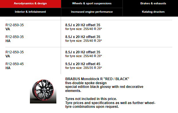

Ok, when I was looking to figure out what would fit, I came across the previous generation GLK that Brabus offered builds for. Here was one of their wheel/tire package options that I could safely assume would fit very well. If you are going to do a staggered setup and you have a 4Matic, make sure the overall tire rolling diameter is very close from front to rear. If you are rear wheel drive only, it won't be an issue. For staggered setups on an AWD/4WD car, it should be within 1-2%. My setup is 1% difference from front to rear.
for my setup, if I could have had a slightly deeper offset on both the front and rear, it would have been better. (I have to have the camber to clear the rear fender lip, but I am very very low) But, I am able to have zero rub, but tires only last two seasons like this.
tawatts Awesome and great info... ok to mine is the 4matc.... I have the h&R springs... 1.2 or 1inch drop...... here are speca of wheels im getting so what size tire you would advice putting on ??
