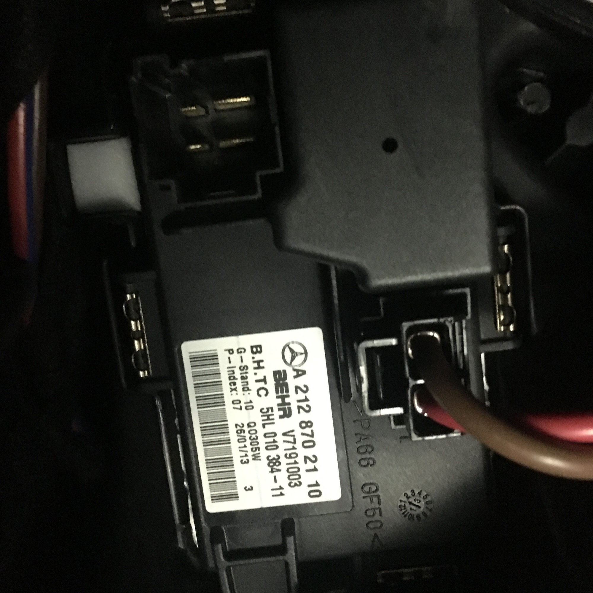

Hi all
i have a question about the A/C blower motor. I have a 2013 GLK250. The blower stopped working. Mid winter may I add. I spent a few hour replacing the blower in the cold and it still didn’t work. From online research it seems like the next step is to replace blower fan module. Before I do it I’m not sure I connected things correctly. It seems like there is a plug with no wire to it. Does this take a wire. The wire in the pic is coming from the fan. I can’t find any wire anywhere that needs to be plugged in here. I couldn’t find any pictures online of this set up. If it takes nothing then I’ll order the module.

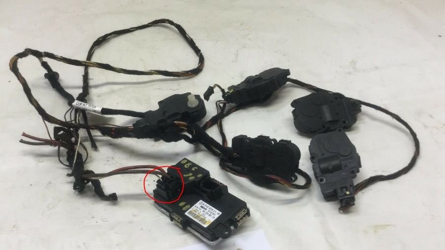

I found this picture online. Would anyone know where this wire is coming from. I'm running out of ideas and i would rather avoid ripping the whole dash apart.

The blower motor (2128200708) is known as A32m1. The regulator (2128702110) is known as A32n1.
There are three wires (white, brown, blue\red) from the cable harness (2044401251) that goes into A32n1; this supplies power into the module. The two wires (brown, red) output into the A32m1 motor to power it. You have the motor connected, but no power will reach it. Connect the wire harness (2044401251) from the fuse box and check your fuses, it is most likely jammed above the blower housing.
Also it should not take you an hour, this is a 10 minutes job for professionals and 20 minutes max to remove the motor.

Amazing! Thank you. I pulled the motor out and there it was. It was wedged and I couldn’t see it. The reason it too so long the first time is because it was cold and couldn’t feel my fingers. It was dark and I was only working with my cellphone light. This second time around I took it out in 5 mins and clipped it back on in 2 mins. Everything is buttoned up and works. Glad I didn’t buy the module. Thanks a lot for your help.
