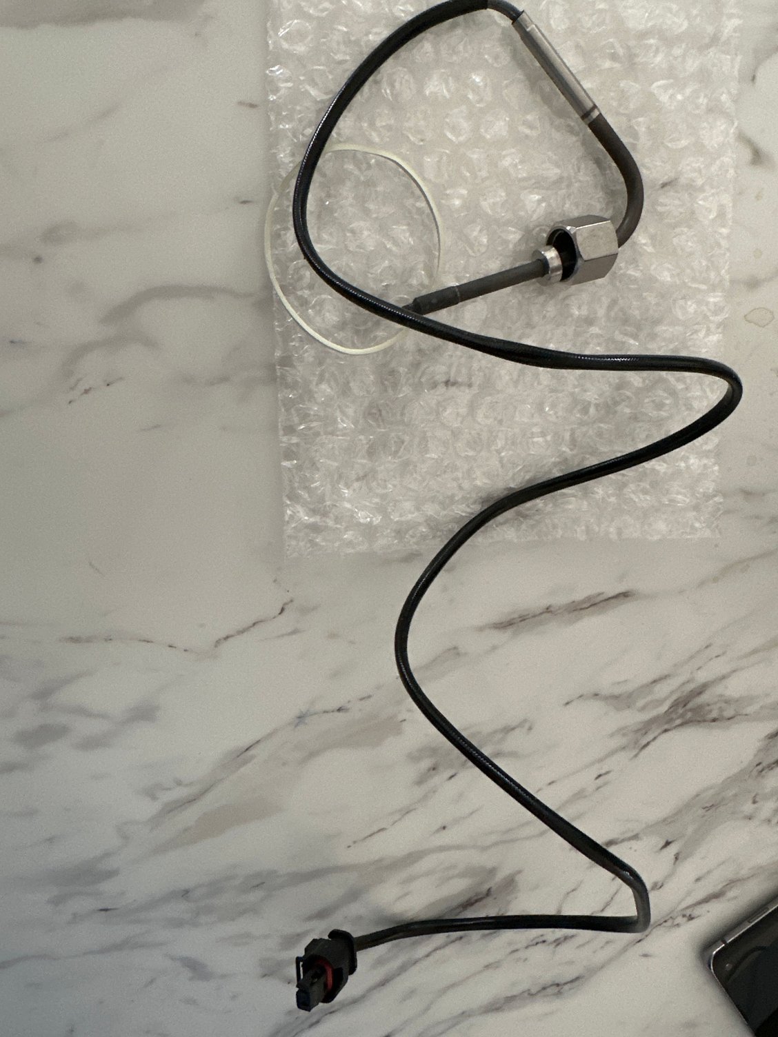

Old Apr 29, 2023 | 04:46 PM
MBnewbie2020's Avatar
Joined: Dec 2020
2014 GLK 250
Specific part number A0009052605 EGT sensor
Hi
I bought this part online and found out there are 4 sensors. Does anybody know which sensor is this specific part number A0009052605 location?
Thanks
