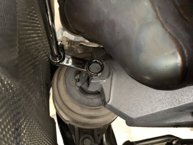

Look at post #7 above - if that's a photo of the 2013-onward motor mount, the distance from the exhaust manifold to the motor mount is MUCH greater than on the 2010-2012 models. It's almost impossible to get a photo of how close the two are in the older GLKs.
And of course, it's MUCH harder to get to the center bolt in the 2010-12 GLK's motor mounts. The "unbent" torque adapter just couldn't get the job done because of the angle and the tiny clearances.

Just to add a photo that kinda/sorta shows JUST how tight the motor mounts are on a 2011 GLK 4Matic... in this photo, the heat shield has been removed, as well as the nearest mounting bolt. You can see how the exhaust manifold obstructs any attempt to get to / see the top "center" bolt, and why the tool that's needed is so specific...
