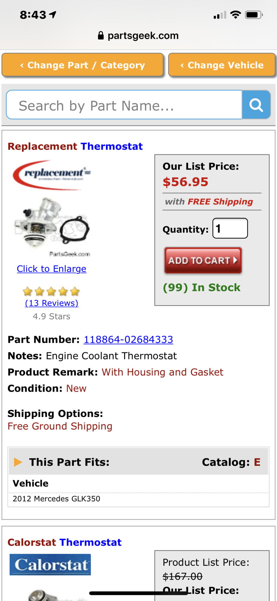

Mmr1's Avatar
Joined: Sep 2015
Posts: 2,584
Likes: 343
2013 glk 350
This should be yours, German made.
