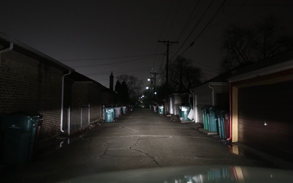

Mbklue, it just isn’t so, i now have great lights, in the photo I didn’t fully lower the right side .
The original dim halogen
HID 2.5-3x brighter

What you have is brighter headlights. That was already a given as it's known HIDs are significantly brighter than halogen bulbs - and thus the legal requirements, in some countries, for a self-leveling system. Theses photos are not suitable for an accurate comparison of any type other than, again, brightness level - already established with the use of HIDs.
It's a compromise, and as such, is not optimal. However, I don't doubt that you consider it an improvement and are pleased with it.

They work great
