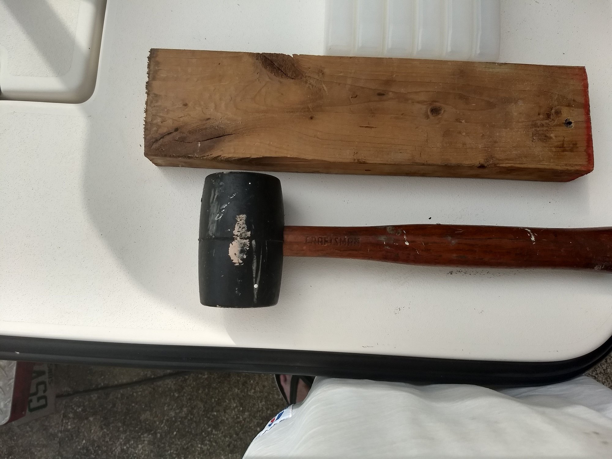

The
EverLast CTX14-BS is dry shipped with the acid in six (6) individual contiguous bottles of battery (sulfuric) acid.
Pic 1: CTX14-BS Electrolyte Bottles
The directions are clear and easy to follow but it is suggested no smoking and wearing safety glasses or face shield and hand protection like nitrile gloves. I added the acid outside in front of the garage, the biggest problem was keeping the bottles level. There may be some difficulty piercing the foil so light taps on a small block of wood with a rubber mallet might save the old meat hammer
Pic 2: Electrolyte Install Tools
The directions do not indicate that the battery will get warm to the touch when the acid is added but after about 20 minutes it will begin to cool down. The bracket for the battery will cover the positive and negative markings embossed on the battery so some red nail polishI mounted it in the battery carrier at this point and hooked it up to my CTEK (MXS 5.0) charger. EverLast estimated charge time is 6-12 hours and its 12+ with my charger.
I wire brushed the posts and gables then applied some dielectric silicone grease. A small flat blade screw driver less than 5” long will be helpful to apply grease and hold the nut in places you install the cables. Other than that reassembly, is the reverse of the 9/3/22 2013 GLK 350 Auxiliary Battery Service post.
