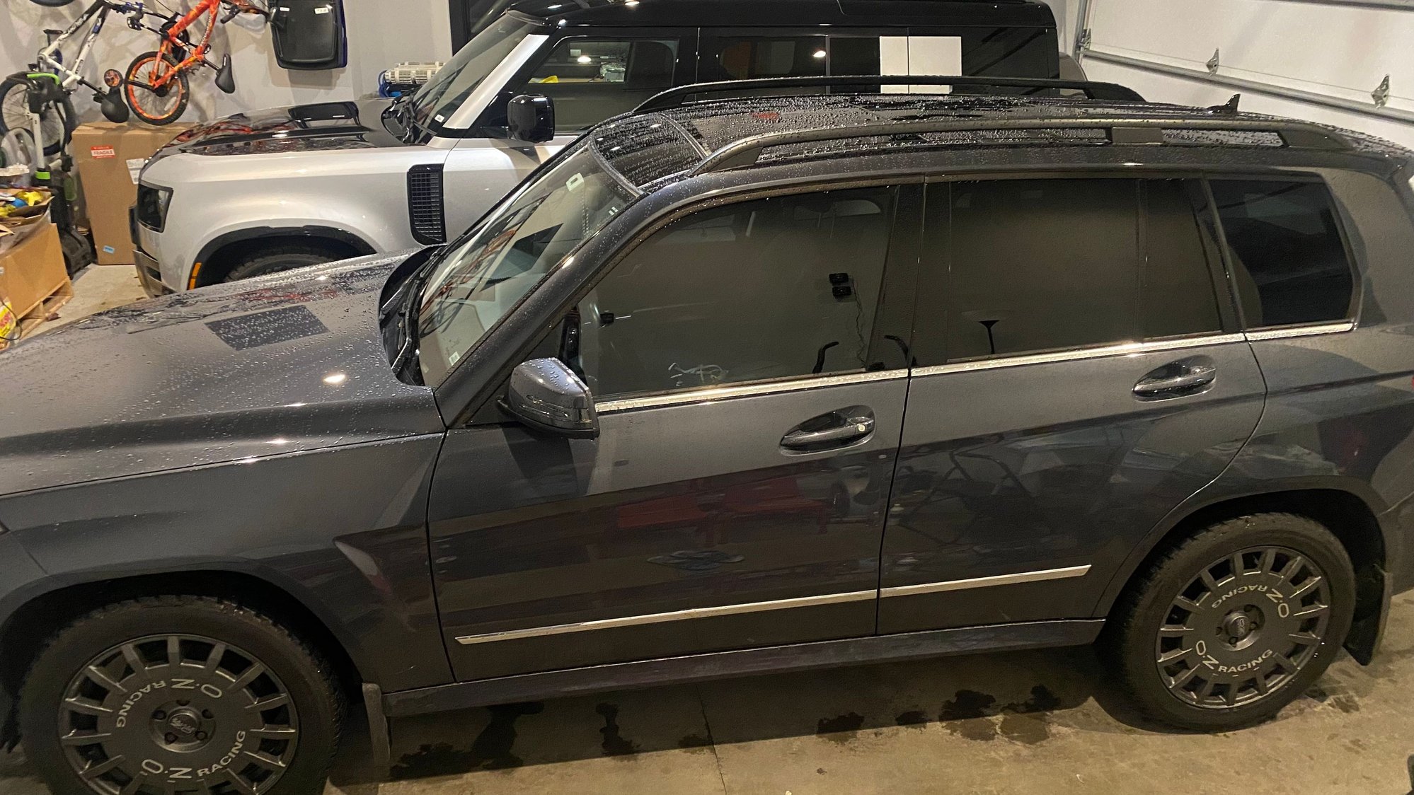

Just posing this question. My 2014 GLK350 is garage queen. Meaning: hardly used on long trips. Just the short trip to the mall, school or market. Anyway my long termer 2015i Escalade platinum, a frequent companion on long drives finally quit at 295,000 miles. Didn't want to use my new defender nor my garage classic Range Rover sport. So, the GLK350 got the call for a long drive from MI to AR. So far, impressively smooth, compliant suspension, did I say fast?, felt like a big SUV despite its size and length. Finally, after that long trip, the tranny has been unusually rough. Out of park, tried to put it in drive or reverse and it would not engage. After turning the engine off and ON, the transmission worked normally. Is that something I need to be concerned of? 60,000k miles now since I bought it new in 2014.

Old Feb 23, 2023 | 08:34 PM
sblvro's Avatar
Joined: Jan 2015
Posts: 370
Likes: 16
2020 C8, 2020 defender 110X, 2019 720S, 2014 GLK 350 4matic, 2015 escalade platinum, 2013 RRS HSELux
Update. Dealer Just did the tranny and transaxle fluid change, replace all rotors and pads and the usual A service oil change. Drives like a champ!
