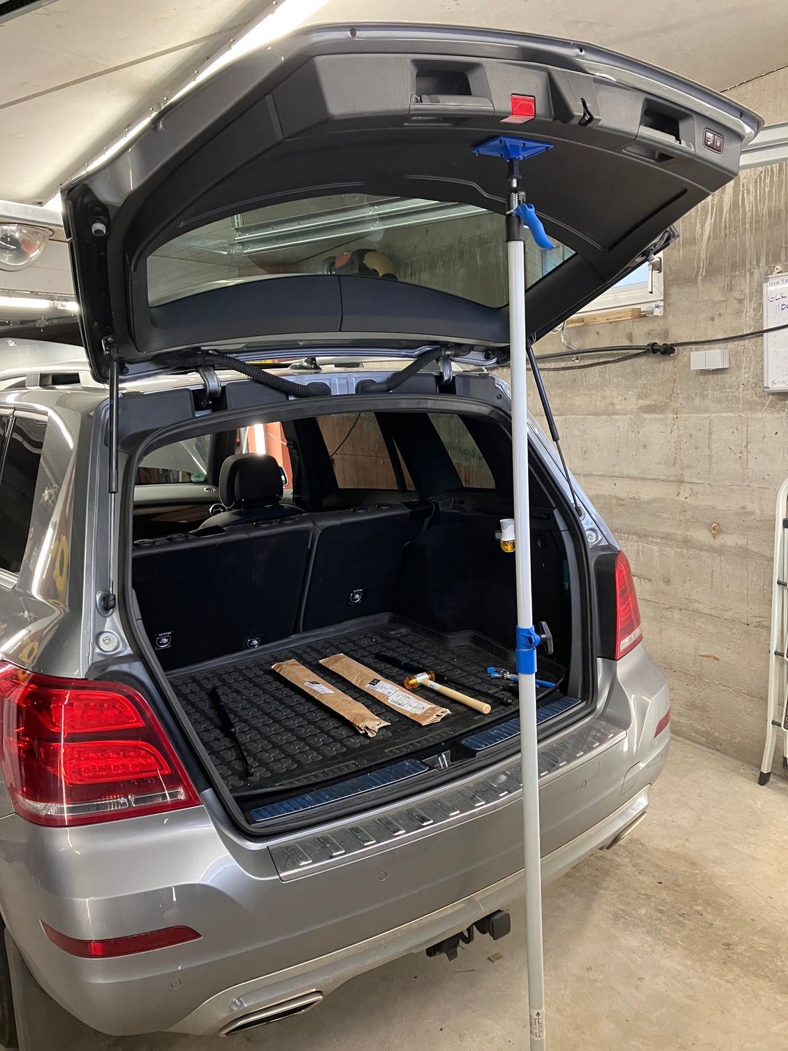

Two or three years ago I bought replacement rear hatch struts assuming the originals would be on the way out. No sign of that whatsoever but today I decided to change them out anyway. Took about 4 minutes to gather a couple of tools and about 2 minutes to change the struts. Absolutely no change. Works fine with the new struts as it did with the original struts from 2013. Live and learn.
2014 GLK with motorized hatch.

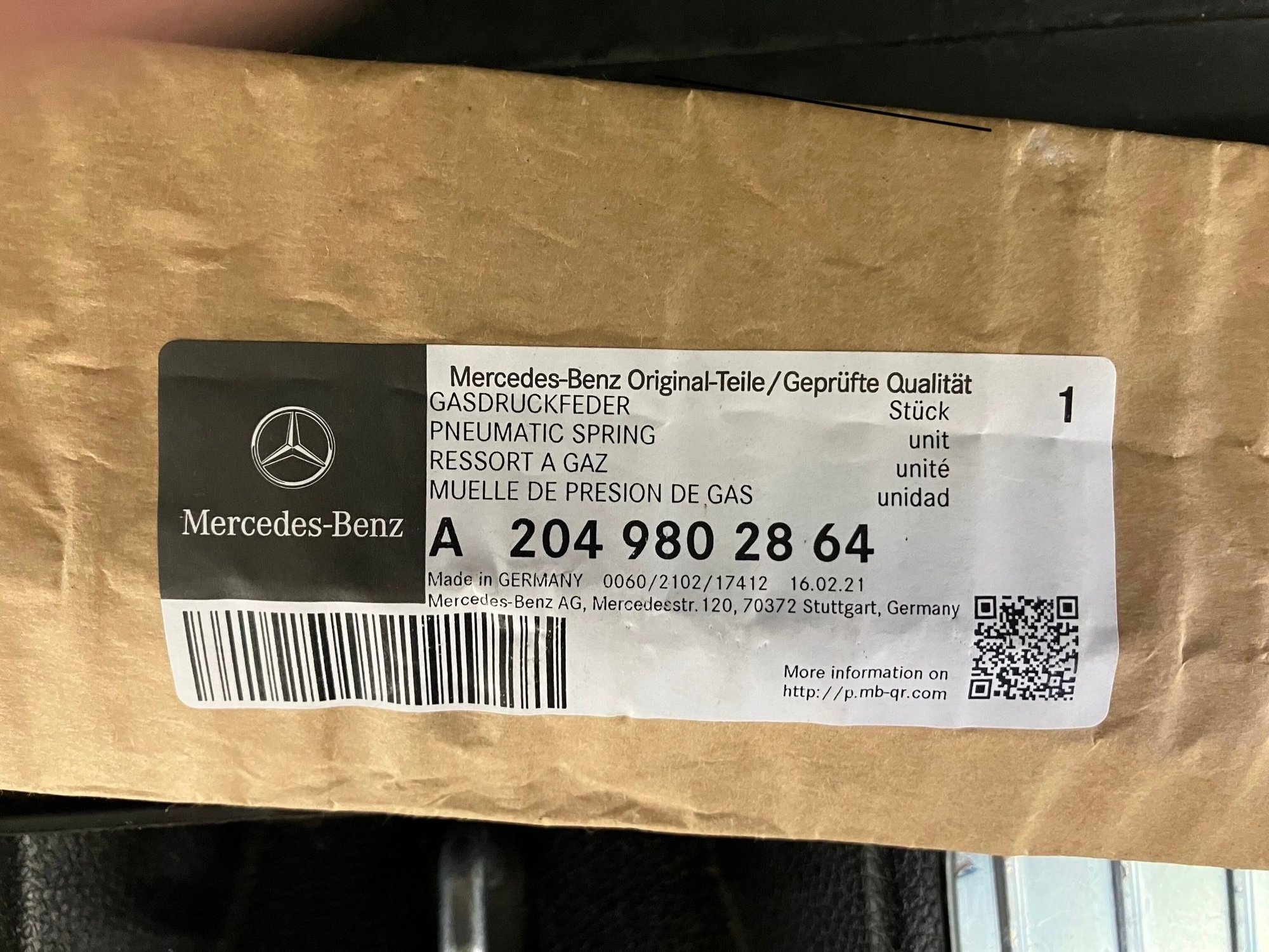

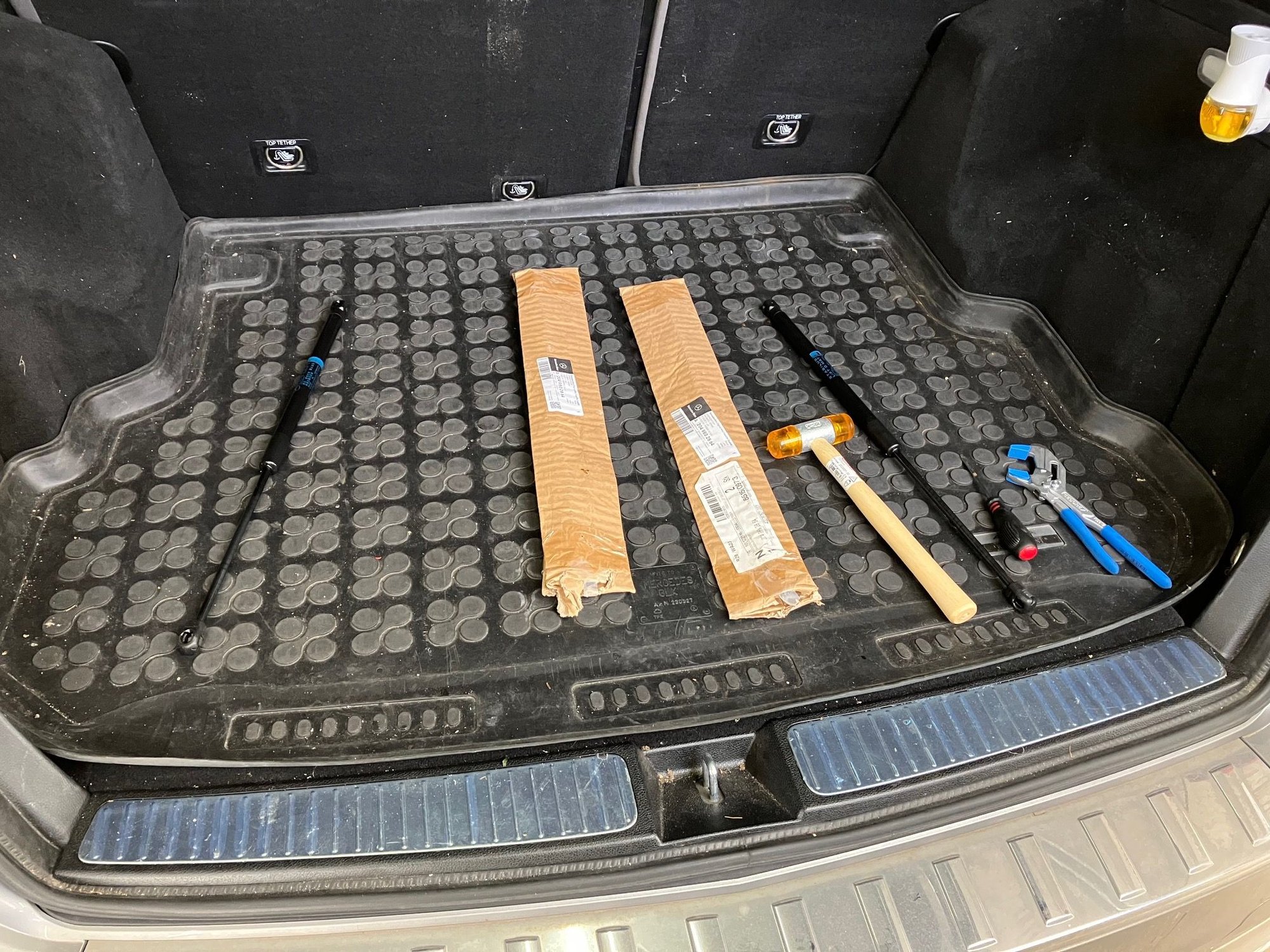

If you have the motorized rear hatch opener version I would not be too certain that the deteriorated struts are providing enough "oompf." That will put additional strain on the motor and associated mechanism. If you don't have the motorized version and the struts keep the hatch up then you're fine, for now. In any event, you want to get them changed-out.
A few years ago, when I bought them, I think I paid the equivalent of about $25.00 U.S. each for the struts at an official M-B dealership. I would get the O.E.M. Stabilus brand. At this point it's unlikely you'll have to change them again.
The plastic-jawed pliers were to press the spring-loaded socket onto to the ball at the top end of the hatch without damaging paint. The plastic-headed hammer was to tap the strut socket, at the bottom, onto the lower ball.
(and, of course, :-) the funky looking thing in the trunk, on the right, is a 120 volt, Glade?? air freshener plugged in to the 120 volt outlet. The outlet is only powered when the car is "on" so not really a worry, regarding battery discharge.)

Honestly, I don't recall if my original struts had a Mercedes symbol on them (but I know that's the case with some other makes of automobiles). If they just come in M-B packaging there will probably be some markup.
When I took off my original 11 year old struts they seemed fine. Never a problem and no rust or anything like that. I had already purchased new ones and got tired of waiting for the originals to fail so I figured I'd just change them. Once the old ones were off I tried to see if they would compress (from wear or leakage) but no chance. Seemed just as stiff as the new ones.
