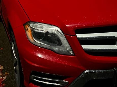

3. Headlights get condensation when it's rainy, but I hear this is normal?

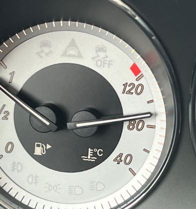

4. I noticed Mercedes cars tend to run a little on the hot side as far as the engine temp goes, is this normal?

There shouldn't be condensation in the headlamps; electronics and water don't mix well.

As Andreigbs says brake fluid, it absorbs water , corrodes parts, and reduces braking noticeably. Temp is normal but it’s old so drain and fill. It’s easy. Use the fluid for your Vin model year . Be sure it’s the same color.water in lights will corrode the socket and coat the glass with a film. Check socket bulb gasket or look for split seams that can be sealed with Silicone. I changed all fluids under 80000, transmission, differentials ( you don’t know if they went through deep water) . Change everything, it’s time.

3. Condensation in the head light housing is often the result of the little vent holes being plugged. Headlight housings have to breathe a bit or the condensation will build up. It can eventually damage the reflective surfaces.
4. The temperature on your gauge is completely normal for your GLK.

My GLK 350 runs at the same 90-92 degrees C. That temperature gauge does look a little worrisome, since the pointer sits above level. Another carmaker would have designed the gauge to sit level in normal operation, but MB, in all its wisdom, wanted to show us real temp numbers, not just four meaningless tick marks. They labeled the gauge with round numbers and aligned them to match the gas gauge to the left. So the normal operating temperature just happened to point the needle above level, alarmingly.
I've developed much faith in the 350's cooling system, though. I use the car to tow a 3,000 lb. Scamp travel trailer. That temp needle stays put on fast summer runs at 100 degrees F. Only once has it raised one 2-degree-C tick mark, when I was pulling up a steep grade, going slow in heavy traffic. It has a big radiator, and no turbos, which are a massive source of heat themselves.
