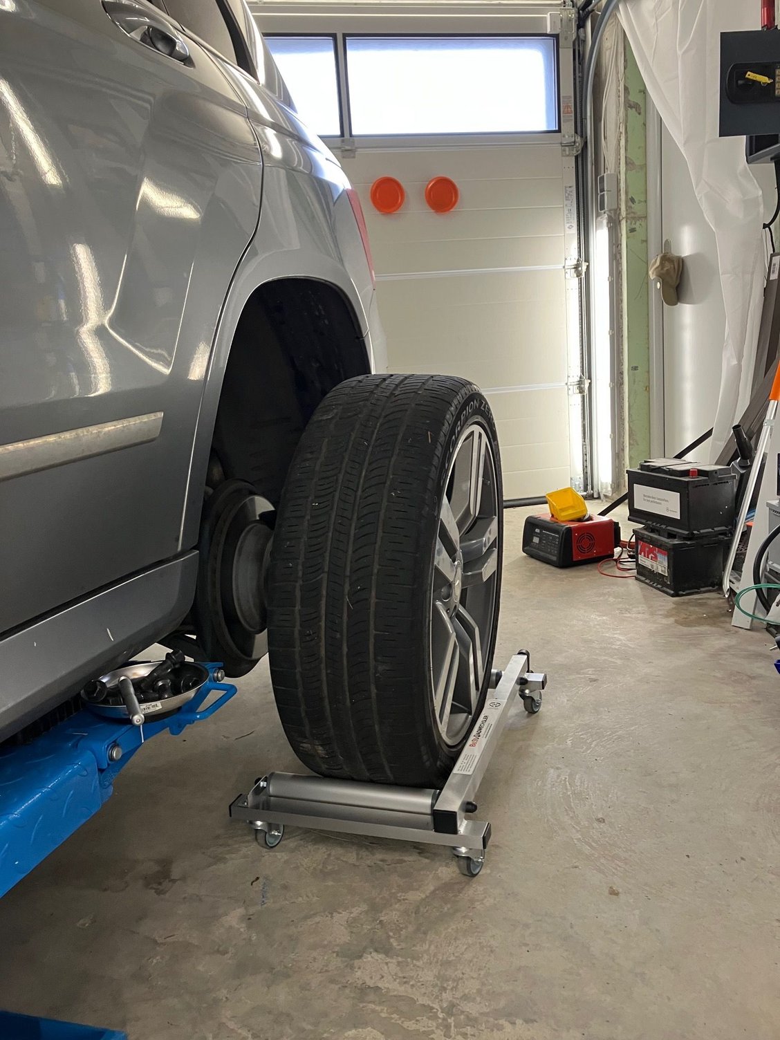

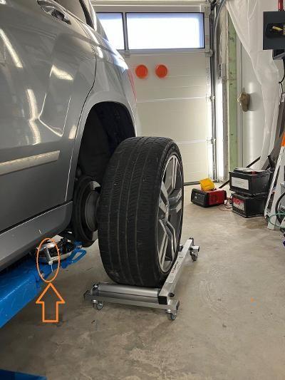

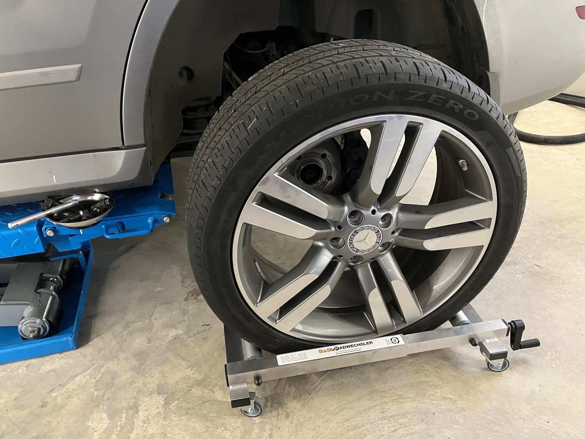

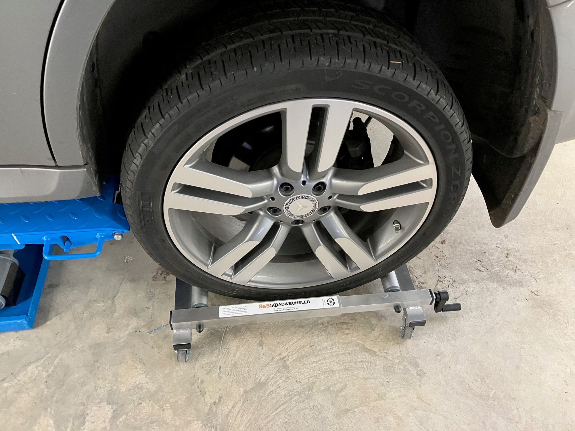

I guess this could be classified as an unnecessary toy, over-kill, nice to have item or a possible back saver, for mounting/removing wheels...
You crank the little handle to raise or lower the wheel so it is in line with the hub, height-wise. Then, because of the long rollers the wheel sits on, you can easily rotate the wheel until the wheel mounting holes line up with the threaded holes in the hub and then insert the wheel bolts (screws).

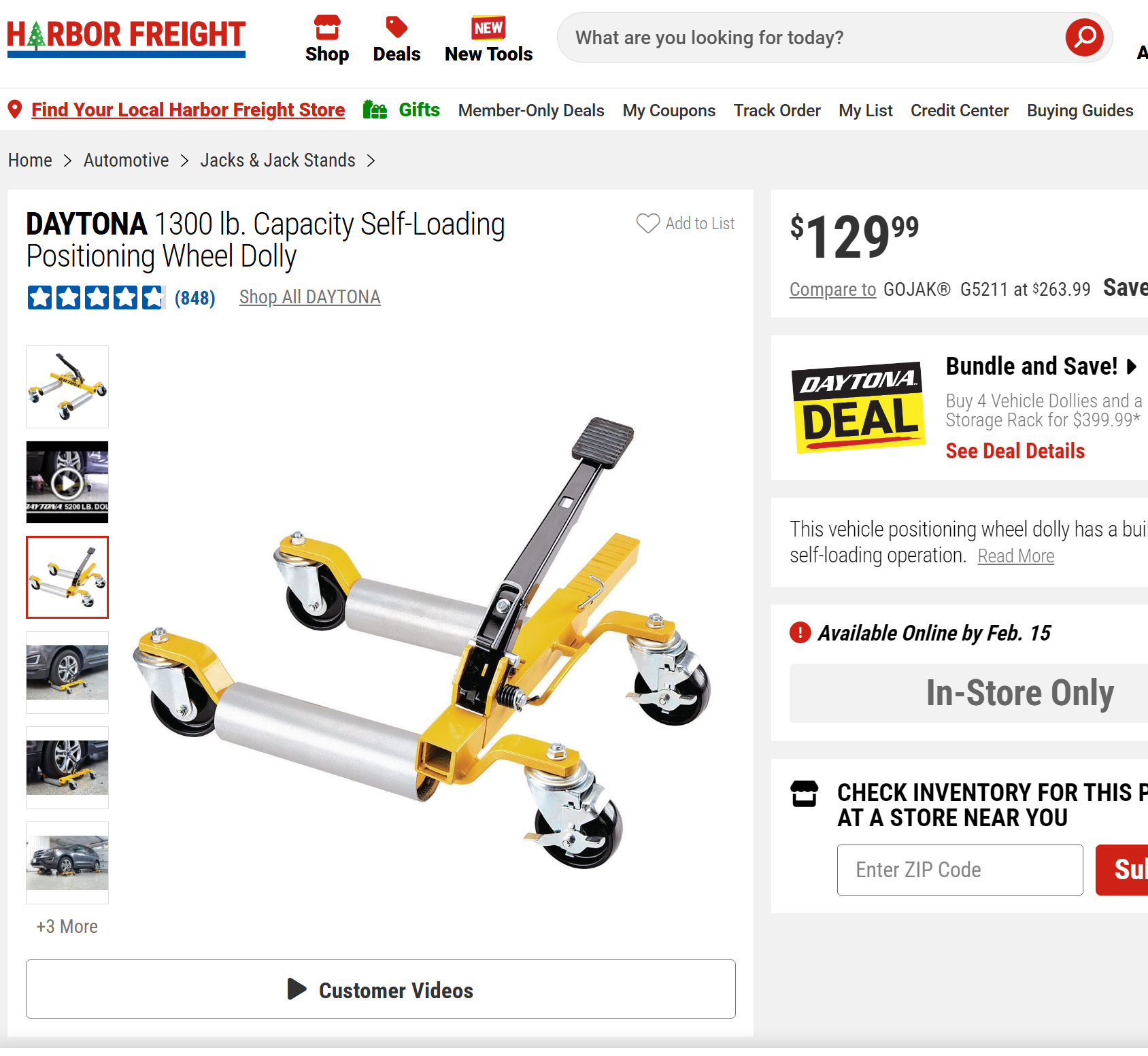

Wheel dolly. These are great.

I figured someone would post a reference to the vehicle positioning dolly - really pretty much the same thing, but with the ability to scoot the car around in any direction, as long as you buy four (and have a level, smooth garage floor).
And FWIW, they do have a much less spendy option - about $65 for a pair, though they're not as easily adjusted or capable of lifting the car (at all). Still, if you just slid one under your tire as you are unbolting it, and carefully raised or dropped that corner with your jack, you could still use it to place a wheel in position without straining (well, other than pumping the floor jack).
https://www.harborfreight.com/2-piec...ies-67338.html

I have a set of GoJaks to move vehicles around but don't use them for wheel mounting or removal. You have fixed steps (teeth) to raise/lower rather than infinite adjustment (crank handle) and it's not easy to rotate the wheel to line up the holes. With the other device the wheel rests on rollers with ball bearings. Very easy to rotate the wheel C.W. or C.C.W. in tiny amounts, to line everything up and no annoying foot pedal that gets in the way or has to be locked down.
