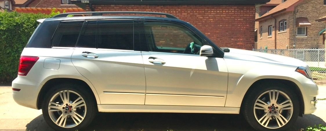

I think most all my problems are the wrong springs , it rides 1-2” higher , that made my front suspension squeak , it’s all new a few years ago , lights need re aiming , and bad ride I thought tires were the roughness . Auto zone has 3 month free return I think . New springs are used Glk coming from eBay , what a headache . It was fine with a small piece broken , it will be near 1000 for my stupidity, everyone said “replace springs “ yea bs 😡

Yes I bought Sachs also. I thought I was buying MB factory springs ! The squeaks now worry me , things are being stressed, it rides bad , headlights don’t go very far now . I hope I bought old factory springs ! They said they are.
how can you know. I hope these new - old springs are not another mistake I make.

The rear is level with old springs .
