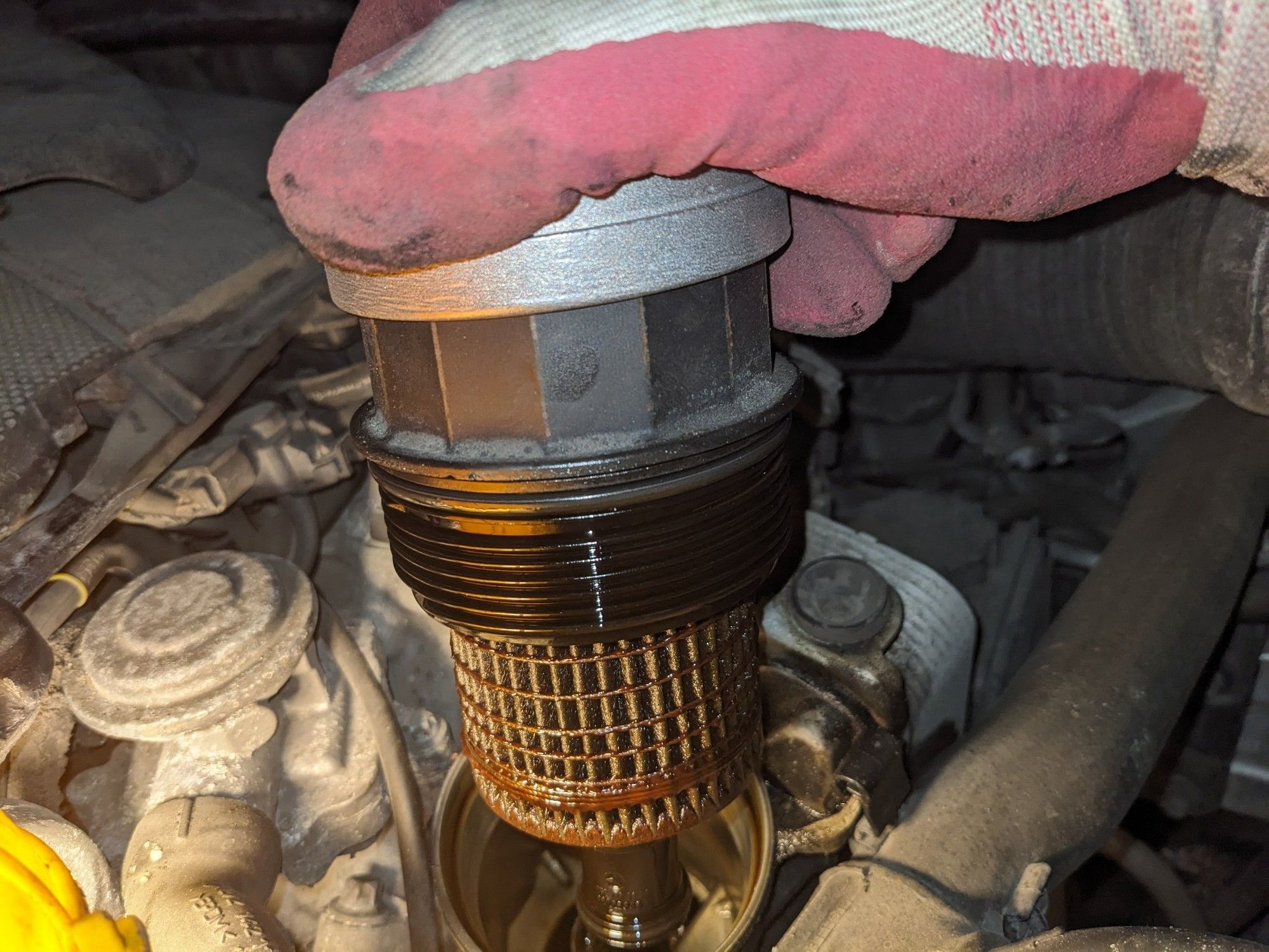

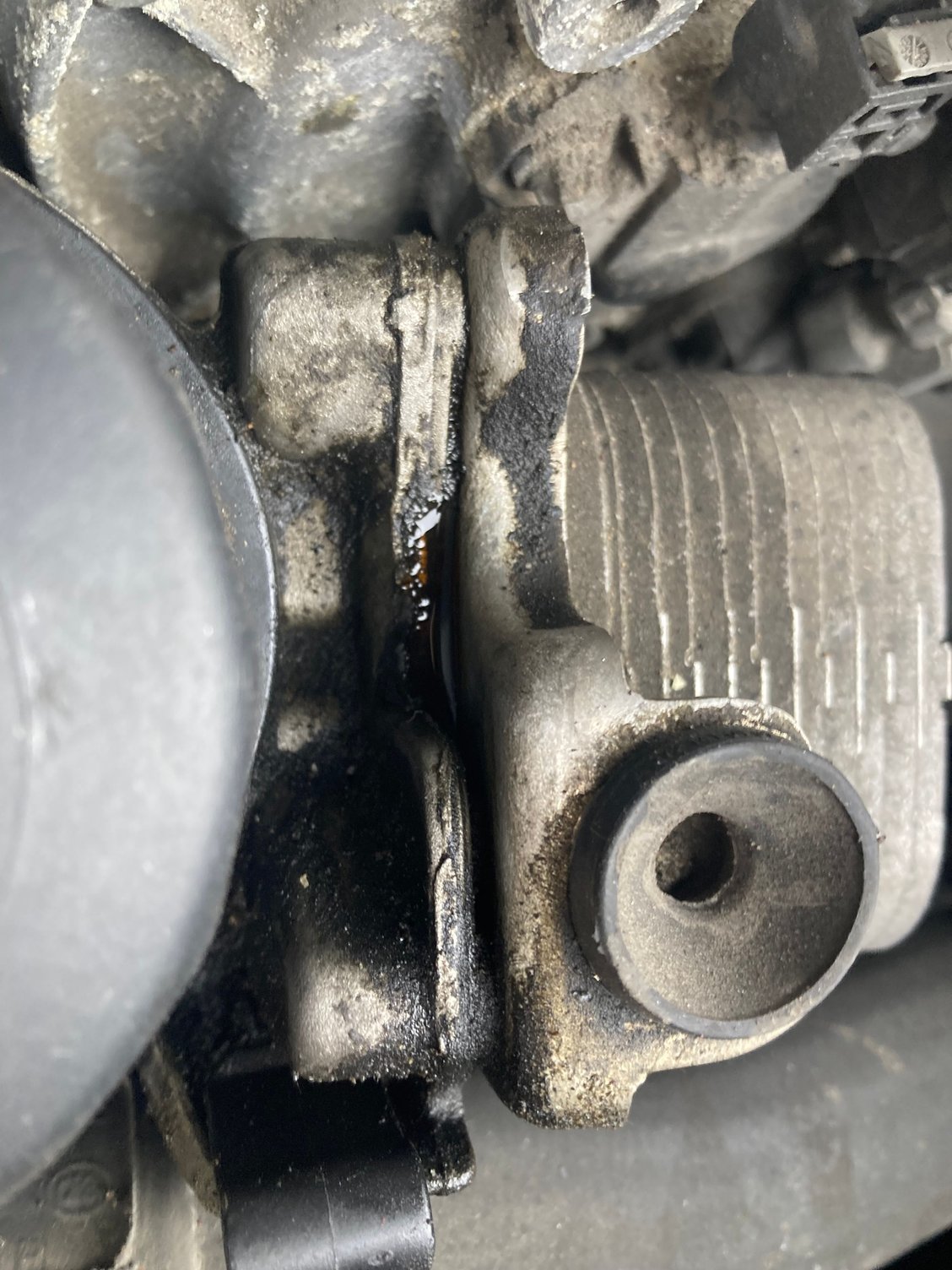

Engine oil pooling between filter cap and oil cooler
I’m gonna have to change the gasket on the oil cooler, maybe the gasket on the filter housing even, would worn cap gasket also contribute to this leak, doesn’t look bad? Most oil is in that cavity between the cap and top of cooler.

I had this same issue a while ago.
Turns out it was the outer o-ring that is around the oil filter housing ... and BE SURE the filter housing is tightened to the correct torque.
I'm NOT saying that my solution will fix your leak, but it's a fast and inexpensive "test" to see if it's the solution.
(i.e., just go to the local auto parts and buy a new filter, to include the o-rings).
For me, you could actually see the oil sputtering out (slightly) while the engine was running, although it was leaking out the backside, so was difficult to see (initially).
I even posted my problem and the solution out here.

New oil filters come with new O-rings, for the cap and the inner plastic stem.
Based on the pic, it looks like your cap is not screwed on all the way; I can see the rubber O-ring around the base of the cap. The plastic lip of the cap should be touching the oil filter housing; perhaps that's why yours is leaking?

Yeah, the o-ring needs to go down, completely inside the housing.

Yikes yes get that corrected soon, thankfully you kept an eye on it, some people weren't so lucky with a seized engine because they put the o-ring in the wrong slot.

Thanks for the replies guys, I got some time to look at it again, looks like the o ring is still in the right place, was torqued down to 25nm, maybe a bad ring? leak was only on the right side close to the cooler, Ive done over 30 of these oil changes on this car and nothing unusual/different that I can recall from the previous changes, same filter used too.

Bad o-ring is not impossible defects can happen, just change it and monitor closely : )

If you can see the o-ring it's not in the right place. The o-ring should be completely down in the housing and the flange of the cap should butt up against the top edge of the housing.
This is a generic picture, but you get the idea:
If you put the o-ring up against the flange then it will not seal properly and the oil pressure will actually force the o-ring out of the space between the cap and housing.

o ring is inside when torqued down, can’t see it, just the plastic touching the top edge like you said

(It sure looks like you can see the o-ring under the flange in the photo in post #1)

Are you sure that's where it's leaking from? That type of seal is extremely reliable, unless the o-ring is visibly damaged. Could it just be spilled oil from the oil change?
probably the oil makes it look like the o ring is visible, for sure it’s sitting inside

Unless it’s the oil from the oil cooler, was following the drip and it made its way down to the the ac compressor, I actually just noticed a split in the drive belt
An opinion, of course. Why? Because __I__ had the same opinion with a past experience. Experience? Yea, check the link to my past thread I posted previously in this thread
I was POSITIVE I would see visible proof of a damaged o-ring, when I removed the oil filter housing. I was sure it would be cut or torn or oddly crushed in some way ... but it was NOT.
However, it was obviously "physically" flawed. What? When I screwed down the filter housing, there was zero tension. Why? Because the o-ring was circumferentially worn, but not particularly visible.
Physically, it was immediately obvious, after the new o-ring was installed... it took noticable physical force to screw the filter housing down, at the point when the o-ring met the aluminum cover, to its final seating.
Okay, I'm not trying to convince anyone, that my problem is @SAVZ 's leak. Just another experience to offer.
Was it a new o-ring? Wear doesn't make sense in a joint with no relative movement, unless it occurred during installation, in which case I'd have to call it operator error... O-rings do take a set over time, and that is the reason why they should always be replaced if disassembled.
The design of the joint is such that the pressure tends to force the o-ring into the tiny gap between the OD of the cap and the ID of the housing. Until there is a mechanical failure, it should not leak.

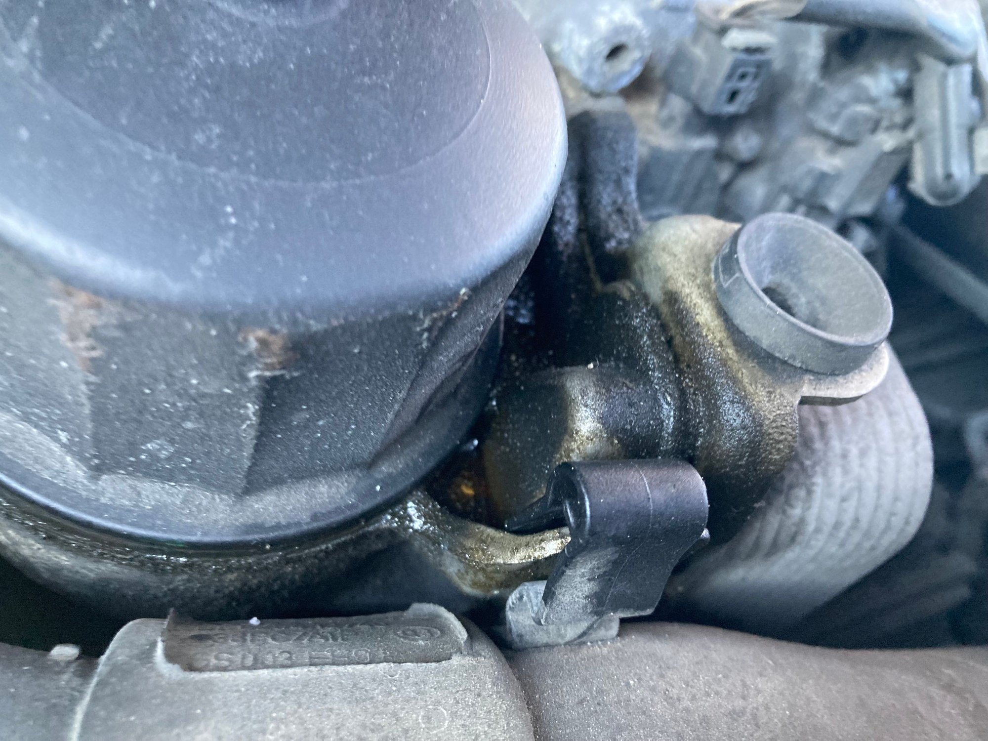

I cleaned up around the area a bit, turned on the engine within a minute oil pooling between the cooler and filter housing.
Lucky for me I was able to find amother leak, looks like right underneath the washer fluid reservoir

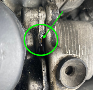

Would have been good to use a dedicated engine degreaser spray, then hose it down, so there is no residual evidence.
Anyway, so I captured the image, then marked it ... check my image ... is THAT where you suspect the leakage is??
Exactly it, thanks, the leaked formed in less than a minute.

I changes the 2 gaskets, put in a new thermostat as the rubber in he old one was looking deformed. Waiting for a new upper radiator hose, there was a leak at the connection to the thermostat when i put in new coolant. I still had a bottle of the old blue stuff, but it's now discontinued.
