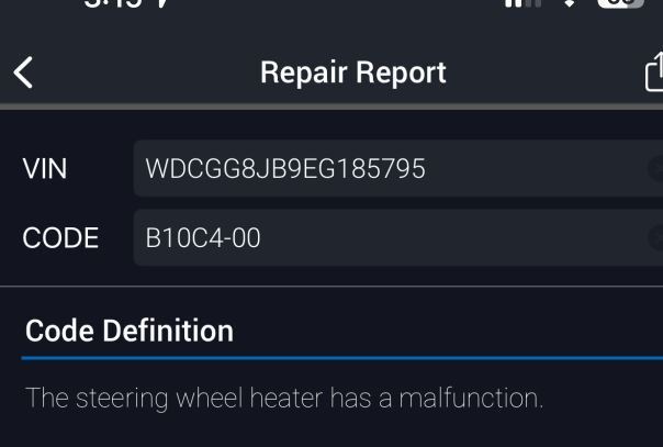

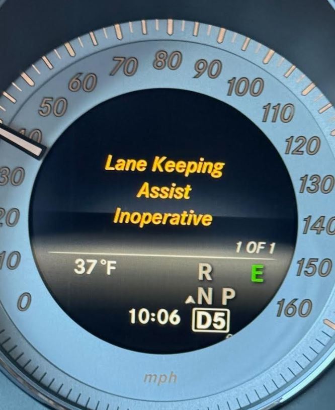

I cleared the code but to no avail, and yes i tried resetting the lane keep assist and turning it on, but thats not even a option
the steering wheel heater red light comes on for like 1 second before turning off
is this whats causing it?

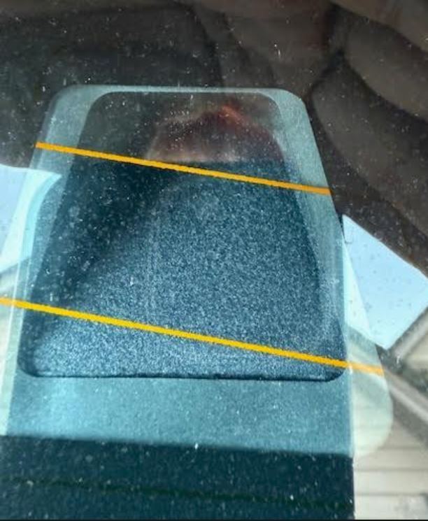

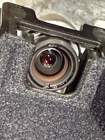

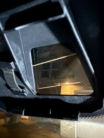

I cleaned the inside of the glass and camera lens, they were already clean but i wiped them with a microfiber anyways.
Cleaned the outside of the windshield, the glass to the camera is clear.
Cleared the codes again but the message doesn't go away.
